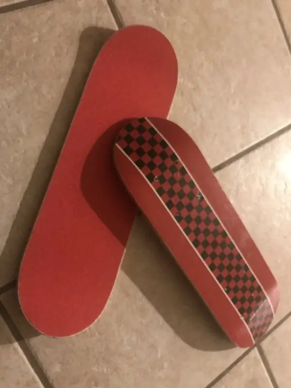

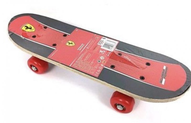

In the X-games spirit of the bike, I ordered mini skateboards to affix to the pegs as runningboards. If the skateboard wood looks to be strong enough I'm going to use u-bolts to the pegs. This might be a thing anyone who removed their crankset could do to use their bike legally within the local scooter definition.

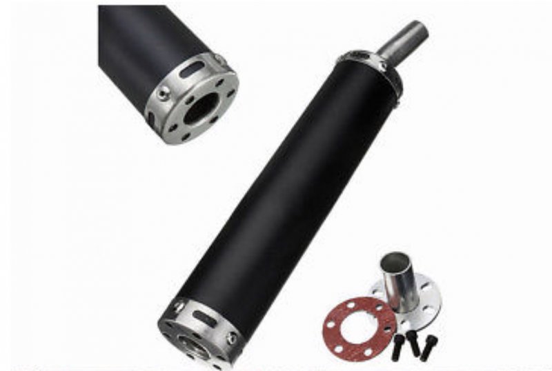

I also ordered a cheap muffler which could possibly be used as a supertrapp with diy baffle plates attached to the screw-on endcap. That's using it backwards so if the exhaust tip too small it would need a different inlet welded on. I'm going to try it out with a pipe compression fitting the normal way first to see how loud it is. The Briggs muffler works ok, but they only flow enough for 14k rpm if you drill out the middle baffle, making it louder.

Haven't had the time and energy to do much on this except for gripping the running skateboards tonight.
Gotta get out there, fire up the engine, u-bolt them suckers on and go for a rip!
