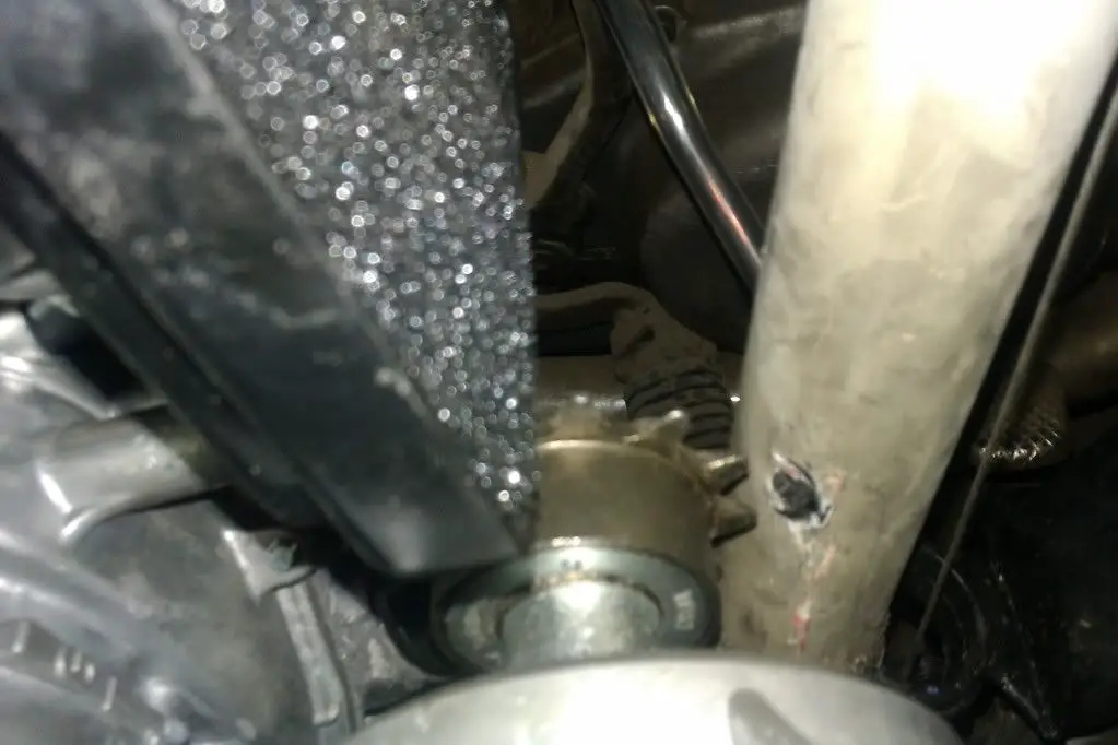

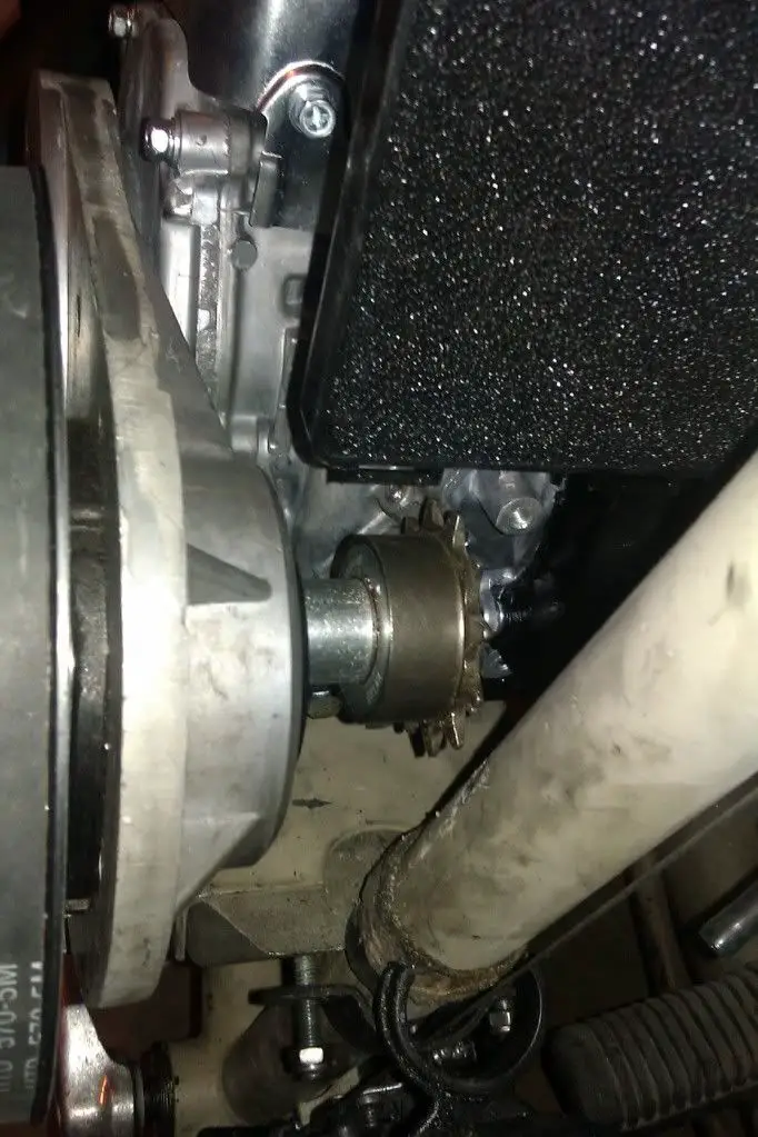

heres my dilemia my 4g with the 5-1 12tooh sprocket sits to close to the bike frame almost rubing up against it ive moved the engine as far to the left as i can but the output shaft is insanely to long .
i atempted to grind out my wigle room in the mount plate that got me maybe a half inch .
could i purchase a output shaft for the 10t they claim its 14 MM shorter and still use my 12 tooth sprocket ?
14mm would give me just what i need is thier any other tricks anyone knows of besides this ?
http://http://www.bicycle-engines.com/output-shaft-p-325.html
link to bicycle-engines.com were i bought my 4g this links to the 10th output shaft .
http://http://www.grubeeinc.com/USA/4G/4G%20V%20frame%20Instructions%20Straight%20Shaft.htm
heres a link to grubee were they show the diference in length . i know terrys kinda busy but if anyone has any ideas im all ears i can get a pic after work tonight if anyone wants one but am traped at work for the next ten hours
