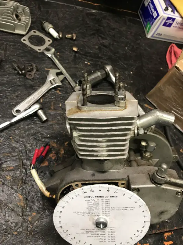

I downloaded one and adjusted the print size till it fit perfectly on a DVD, then I used spray adhesive to attach it. I have a 8mm bolt with a piece of hose that I slide on the crank with the nut off. It’s accurate, I turned it three complete revolutions and it zeros out.

I downloaded one and adjusted the print size till it fit perfectly on a DVD, then I used spray adhesive to attach it. I have a 8mm bolt with a piece of hose that I slide on the crank with the nut off. It’s accurate, I turned it three complete revolutions and it zeros out. View attachment 110752
I really like that
