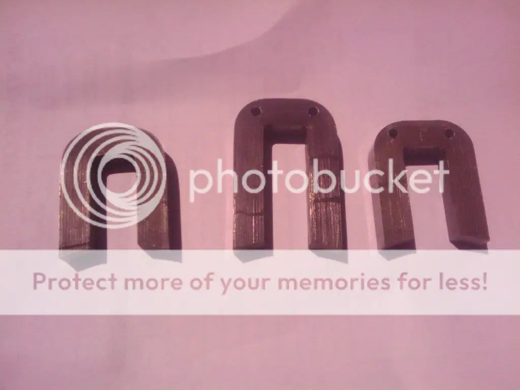

That's encouraging. The 2 stoke magneto core dimension across the two legs of the core is a little large at 2" on the outside. The magnets in the flywheel are spaced 1.75" on the outside. Also the thickness of the legs in that same direction is not very good so all that means that I can probably get considerably more wattage with the right dimensions on a core. Have you hooked up a multimeter with the led burning to get voltage and amperage measurements? This would let you know exactly how many watts you are producing and would be a help for those of us experimenting with this setup. I think with the right core to put windings on this will be a great setup.
Here's an update on my alternator project. I had three magnetic steel alternator cores made with two lengths and with and without holes and will be testing them on the engine soon. It will be very interesting to see what effect the different configurations have on output and the maximum output available with this setup. Also, I should be able to get much more output compared to the solid iron core. Here's a picture of the cores.

OK, after trying different length cores, insulated vs. uninsulated mounting brackets, insulted vs. uninsulated bolts, and moving the coil closer to the flywheel I got a maximum of 19volts at 1/4 amp driving a light bulb while revving the engine. This was with only one coil and it was producing nearly 5 watts! I was overdriving the 14volt 200ma light bulb which was glowing very brightly. Since the core has room for two coils that means a maximum of almost 10 watts while revving the engine and probably 3 or 4 watts at idle. This is more than I expected and I am very pleased! I'm changing the core dimensions slightly after these results and will be getting a quote for some cores very soon. Everyone who wants lighting power for their Hua Sheng engines should be very happy, I know I am.dance1
Here's a picture of the latest prototype with both coils on. It looks like it only puts out 50% more power than a single coil so my revised estimate for maximum power out is 7.5 watts. Still not bad. Still waiting on a bid for the core and need to refine the mounting bracket. and maybe design a cover for it. Here's a link to a youtube video of it lighting up that 14.4 volt 200ma light bulb.
