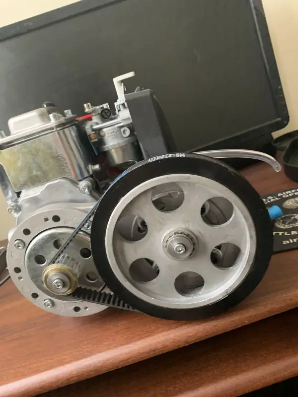

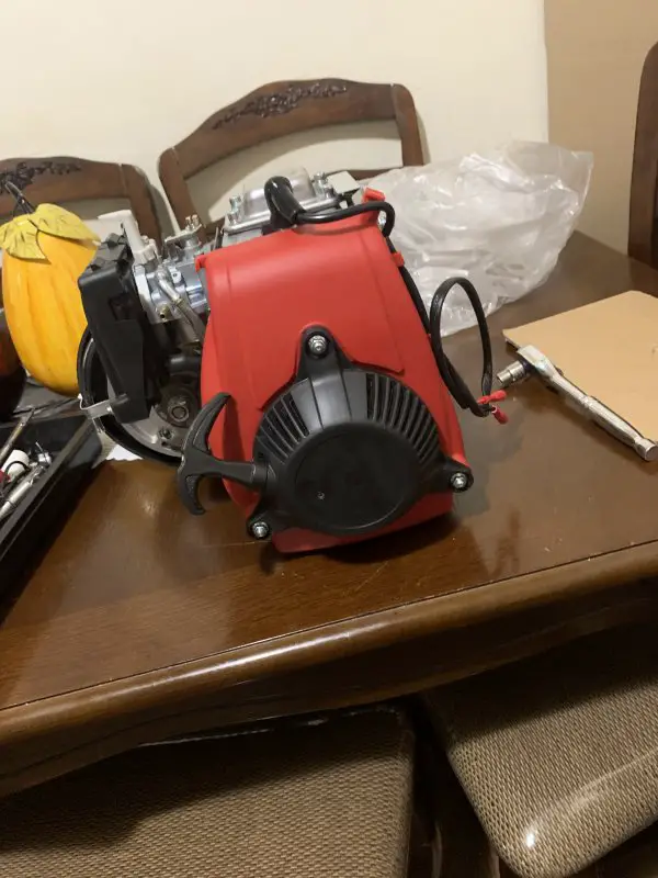

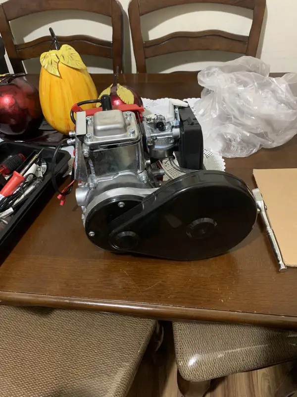

Here are some pictures of the engine without the transmission cover. It's huasheng 144f with belt drive. You can find it on ebay by just typing 4 stroke bike kit with belt gear. So basically what happens is when I pull the pull starter, the entire belt moves. To my understanding this should only happen when I give it gas, which is when the centrifugal clutch engages. So if my belt is moving without it even idling, (just pull start) does that mean its engaging too early? I've tried pulling it while holding the gear in place but it still moves, that could just be because I have weak fingers tho. I can't even mount it on the bike yet because I need to get a crank puller. Im just hoping its some weird break in thing and the clutch isnt stuck
Remove the large pulley & then you'll be able to remove the clutch to inspect it...
I'm betting that the clutch is just installed wrong

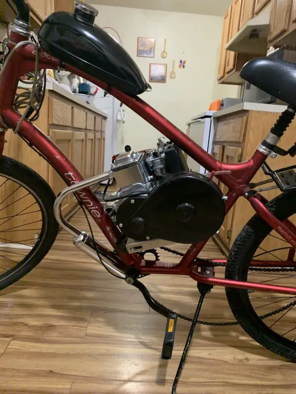

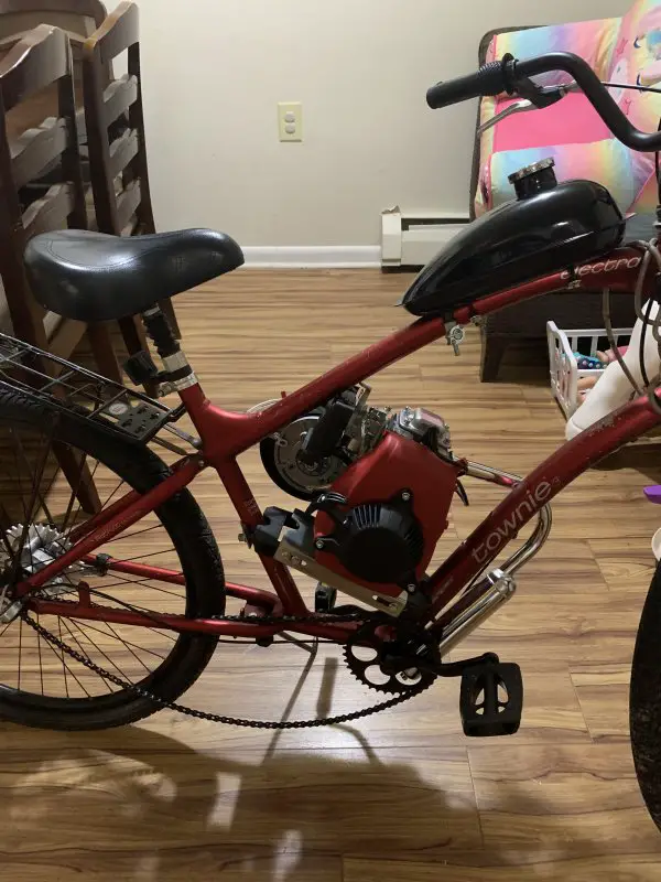

I figured there’s no point in getting that clutch looked at if I can’t even put it on the bike. So I tried putting it on the bike and the stupid carb won’t fit unless it’s at an angle. Im worried cause someone said something about oil or whatever. I’d it okay for it to be like this?
51FE010B-DBC1-40BC-8792-68C19E995C1B.jpeg 51FE010B-DBC1-40BC-8792-68C19E995C1B.jpeg
So is it okay to mount the 4 stroke like this? I don’t want to mess with the clutch yet until I know there’s a problem with it so I’m going to try to mount it first. Also if I hold the sprocket while starting it still moves. But if I hold the gear itself on the transmission while starting it doesn’t move. Sorry for the late reply I’ve been busy.
