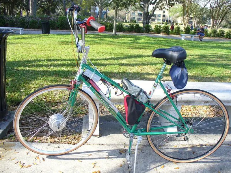

The batteries are usually a higher voltage peak than advertised- my 36v sets- run series of ten 18650 so that comes out to 42 v - 36v is the middle working range- I haven't looked into higher voltage- 36 suits my needs- especially now using Hoverboard packs- 52 sounds about normal high end of a "48v" system.
On the other hand- I've now put a 500 watt controller- 22 ah instead of the "usual" 13 or so ah onto my latest build with a 36v 250 watt hub. It pushes it almost, but not quite as quick, as the same kind of controller on my 500 watt build- and I don't feel it's straining it in any real way- the hub is the same size- they're mostly just rated differently- possibly even for marketing concerns.
There's a lot of discussion on the web about running stronger controllers rated higher wattage than the hub, if you search it out. I didn't particularly get the controller for more sped- actually for more compatible connectors-
but it's a great added bonus to have similar performance on BOTH hubs, with 22 amps when I'd definitely be getting less with a smaller 13 amp controller. As an old racing cyclist, I'm usually about staying minimal- now I've arrived at smaller battery packs but quite happy with a slightly larger controller I was originally bumming over- they're from Ebicycling I think the name is correct.

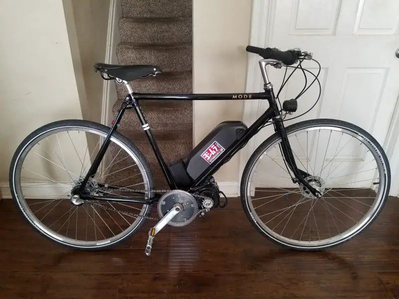

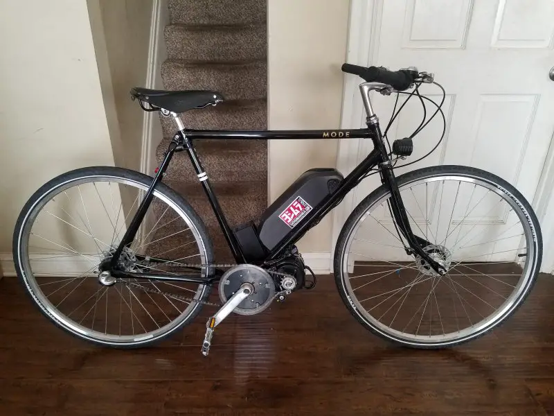

I specifically mention the SBP shift kit because if you know it can handle up to 72v on the controller. The engine is rated for 3000Watts. I have finished my electric bike build with the battery which I chose to be 52v 17.5ah. I get 36mph top speed on 3rd gear accelerates quick on 1st gear. I go to school and back 2 days before It shows the last bar on the battery. Its about 6-7 miles going and another 6-7 miles coming back. 2 hills are on my route and one long full throttle path. Lots of stops and goes in between. So im getting over 24miles of range and I haven't fully depleted the battery not even once which is perfect for me. Im thinking of increasing the gearing for 38mph top speed. The bike does great really good and light highly recommend I will post some pictures.

So clean. Love the old school little headlight on the front. I saved this picture.
Thanks I didnt expect it to come out this good. The front light is very bright and actually has a built in horn which is very loud. It is powered by the main battery turns on with a switch.
