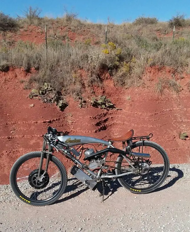

I don't know if he is but I did and took a 540 mile, 3day Fall ride recently....great trip!View attachment 102803

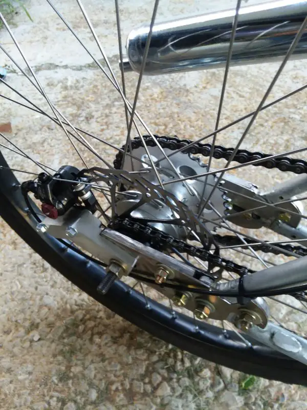

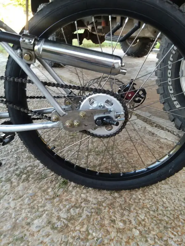

It's actually a dropout extension plates to increase the bikes wheelbase by at least 4" for better handling characteristic & it does help in clearing larger tires, but running 3" x 26" tires probably going to need a frame originally spaced 135mm wide to fit .Most guys build either ICE or electric I just thought a hybrid would lend more utility and it does.
