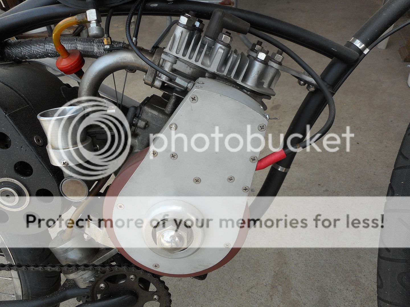

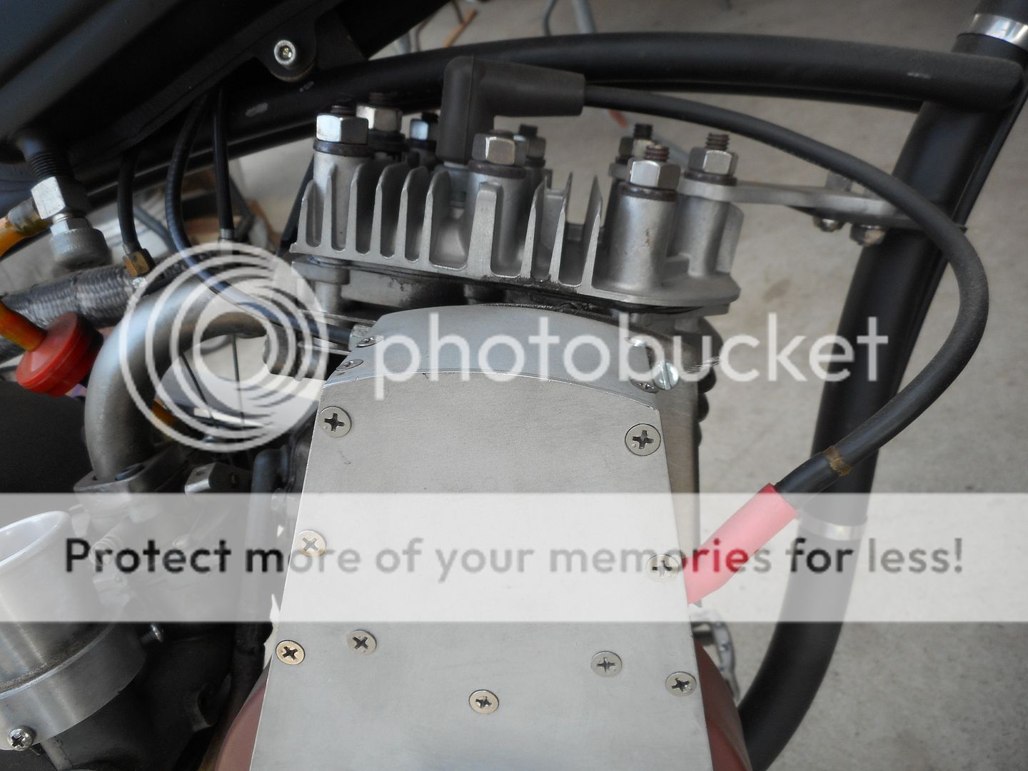

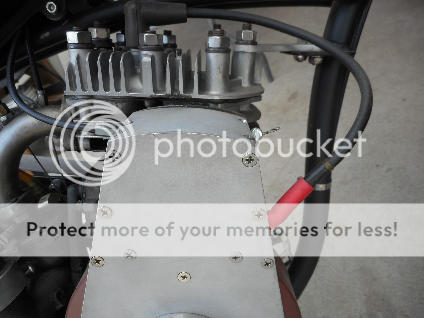

Cool. Advancing the timing really helps your top end. I recently fabricated a cable operated advance mechanism for my bike with the 2 speed auto. I made a cover and installed a ball bearing centered on the crankshaft and made the flywheel retaining nut pass through it. Then I mounted the magneto coil/module to the cover. A lever on the bars moves it from stock up to about 8 degrees extra advance. The mag pivots on the crank center keeping the air gap correct. It starts easily and I get e few hundred more rpms when I need it. The last 2 photos show stock position and fully advanced.

Wow Dale!! Man you never fail to impress, that adjustable timing is very ingenious! Thank you for the kind words. Yep this project has evolved quite a bit being my first bike. Curtis I'm thinking maybe 6 degrees? I will try it see how it works. The top end on this bike stops at 6k and I don't know how much more the flywheel and rod can take if I upgrade the valve springs. Hoping I can move back to my taller gear ratio and move the shift rpm up to 30mph from 24; it overheats the clutches quickly on a long hill climb trying to shift but not being able to.
