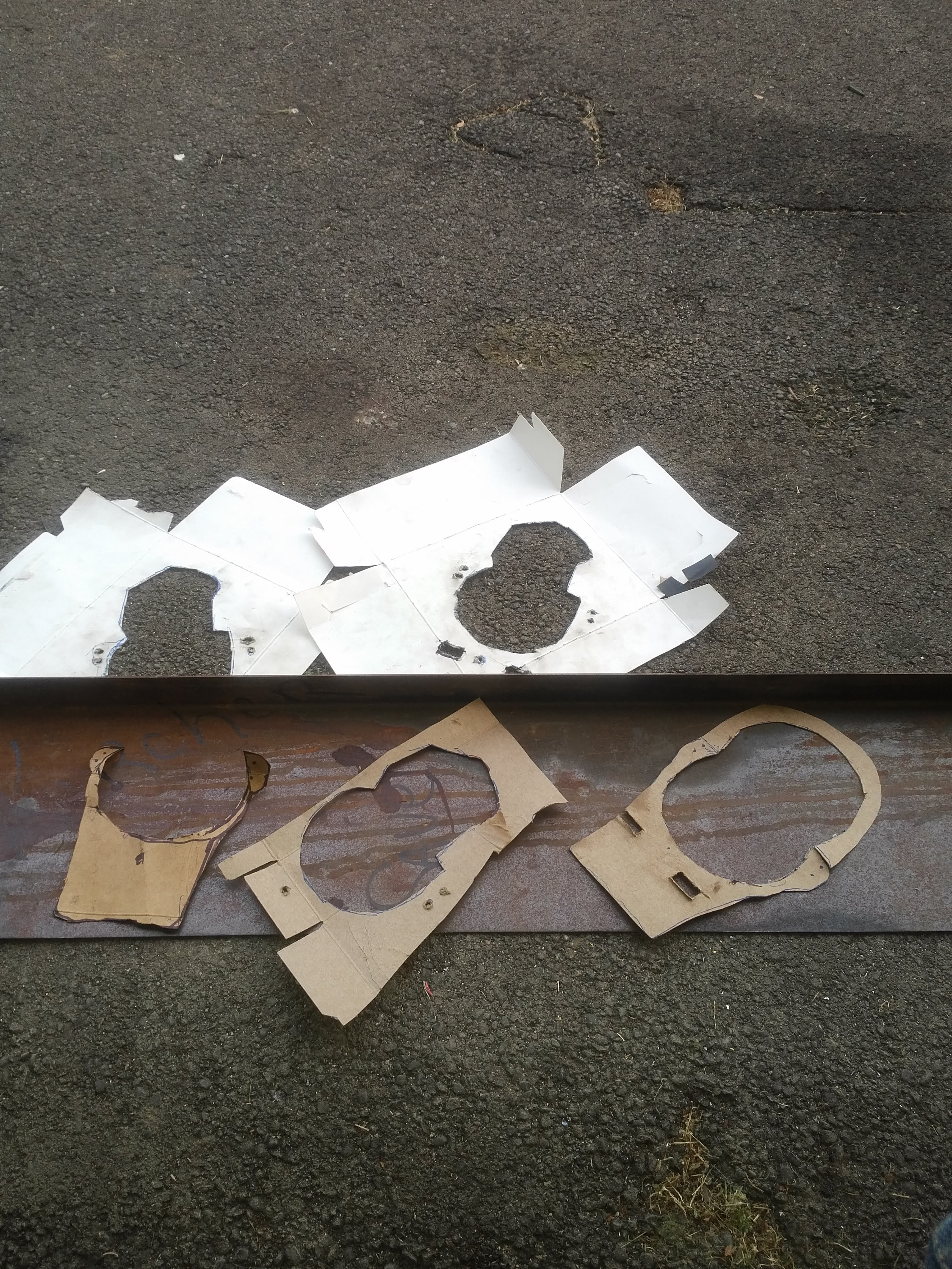

The past couple days I've been working on mounting the engine. I was able to find some scrap steel laying around my garage that worked great. I drew out a bunch of stencils for how I would cut it until I got one that fit perfectly.

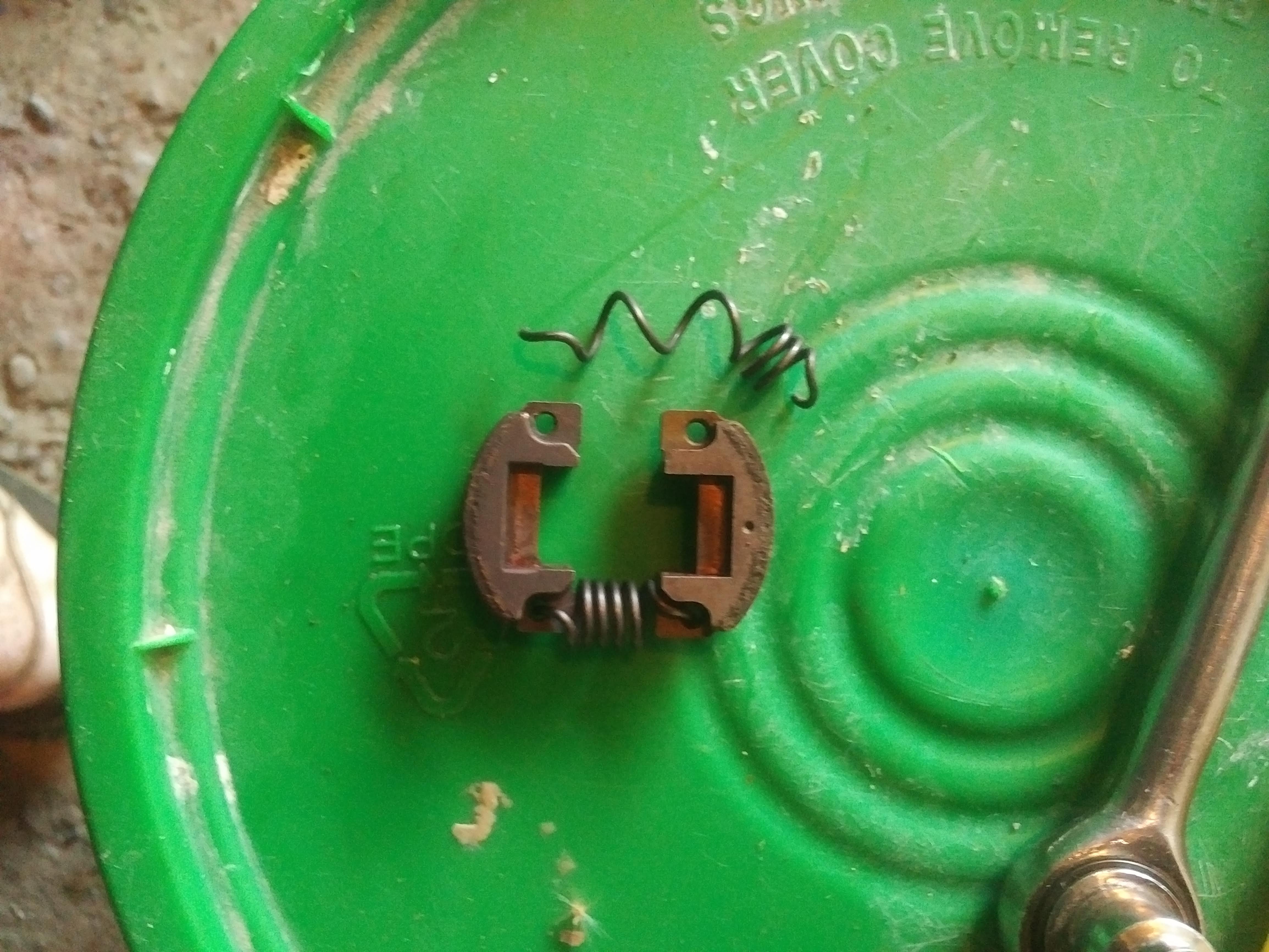

Once I had the engine mounted, I got a little too far ahead of myself and decided to start it. Well, I never put the clutch housing back on before I started it. And I foolishly revved the engine which in turn made the clutch pads expand and go flying through my garage. It took me an hour of searching but I finally found both clutch pads and both springs. The springs are butchered but the clutch pads should still be usable. Luckily new springs aren't expensive but I do have so order them online since none of the shops by me had any springs even close. So here is a pic of the mangled springs
full
Even though the second spring doesn't look too bad, it is. Its not supposed to have any space between the rungs when its free of tension. So I will have to order a set of new ones and never make that mistake again.

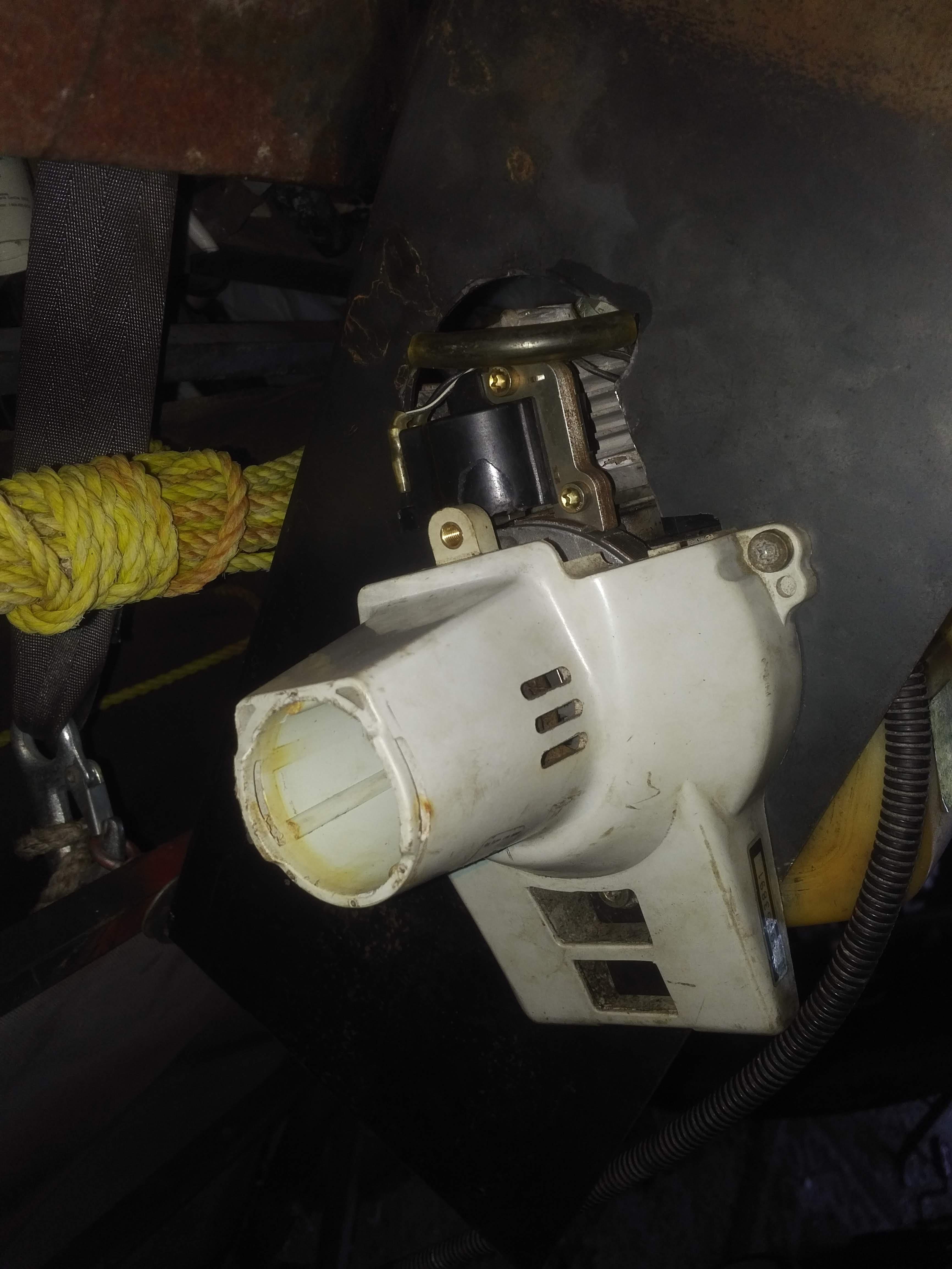

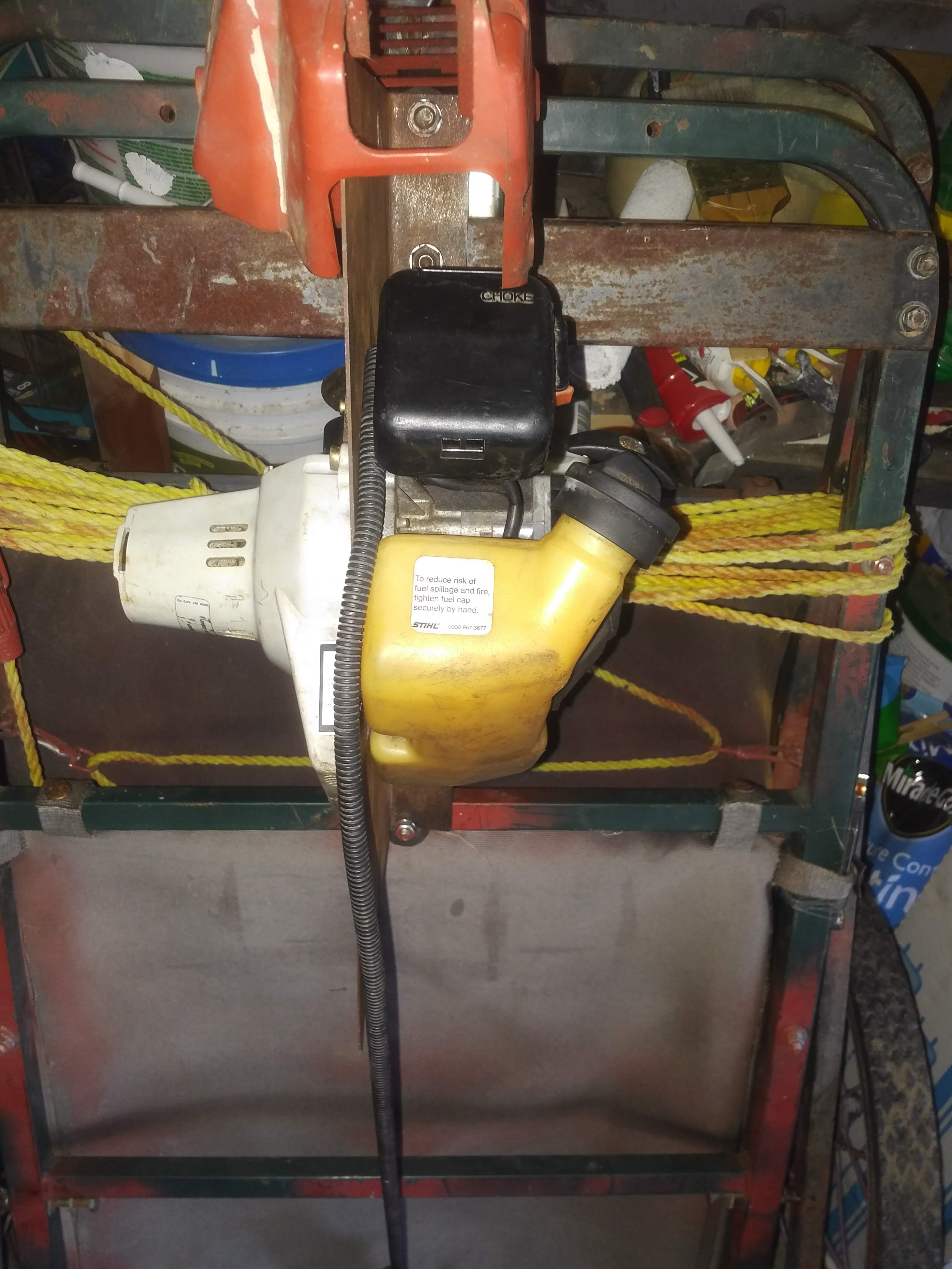

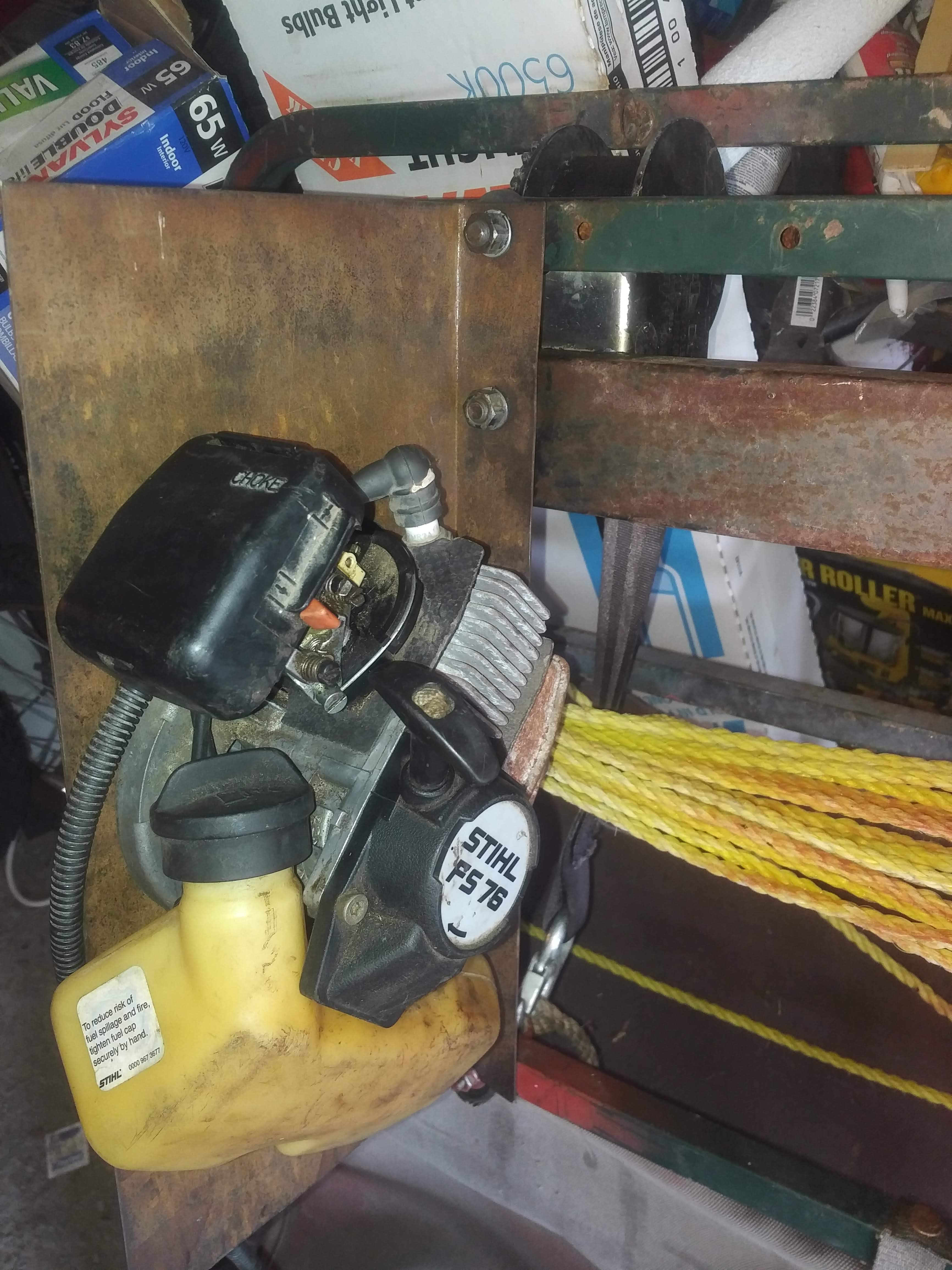

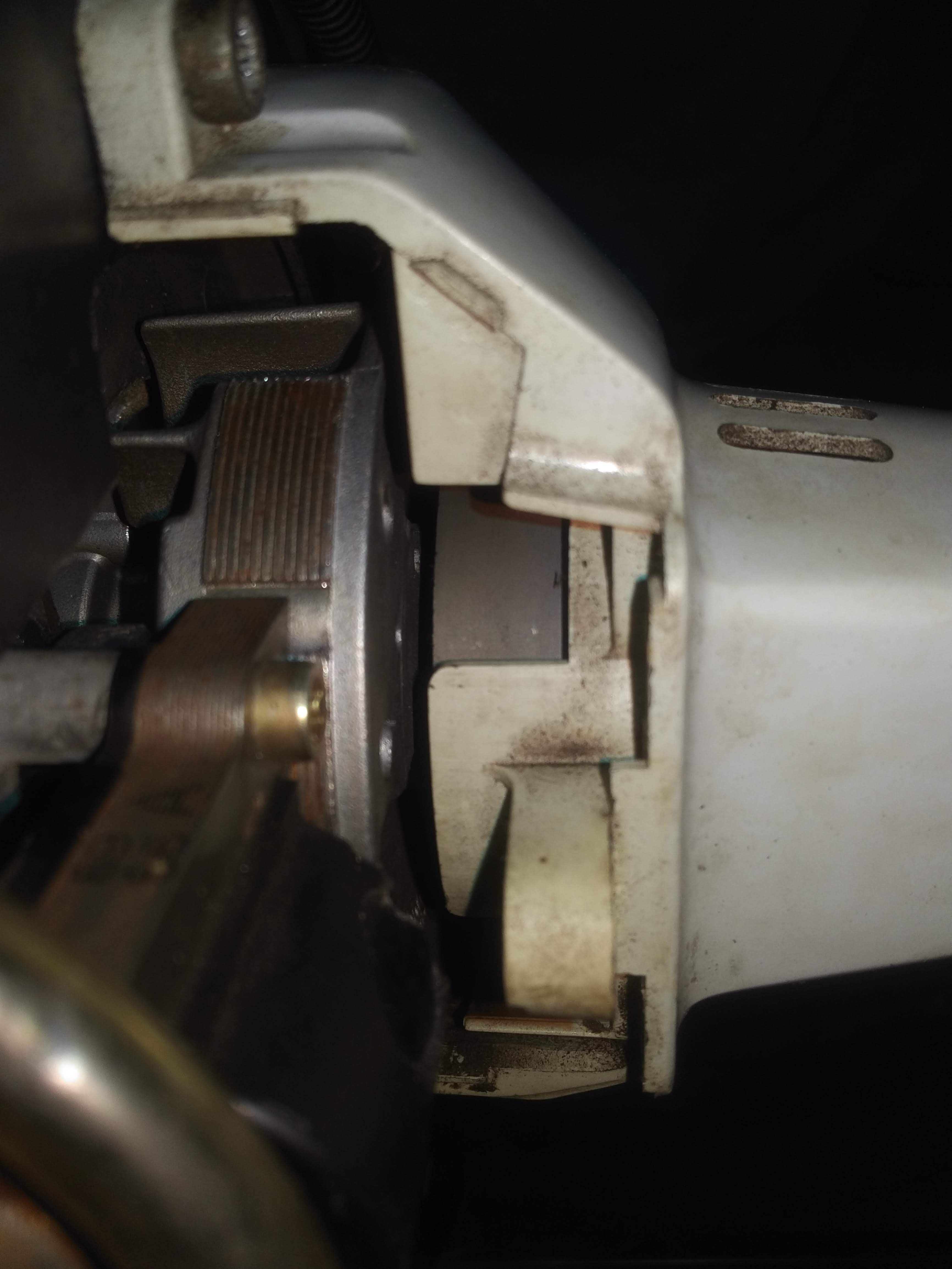

Besides that mistake, everything else seemed to go alright. The engine doesn't create any vibrations in the handle of the kart. Which I was pleasantly surprised by. And the engine is solidly mounted and not going anywhere. I will probably clean up the mounting plate a little more and just cut away some of the unused metal. Also, the way I mounted it does create a small gap from where the clutch drum meets the clutch pads. But it is such a small gap that I don't think it will have any effect. I am also considering cutting the plastic cover for the engine in half so I can still use it on both sides of the engine. Anyways, here's some more pics of the engine mounted.
