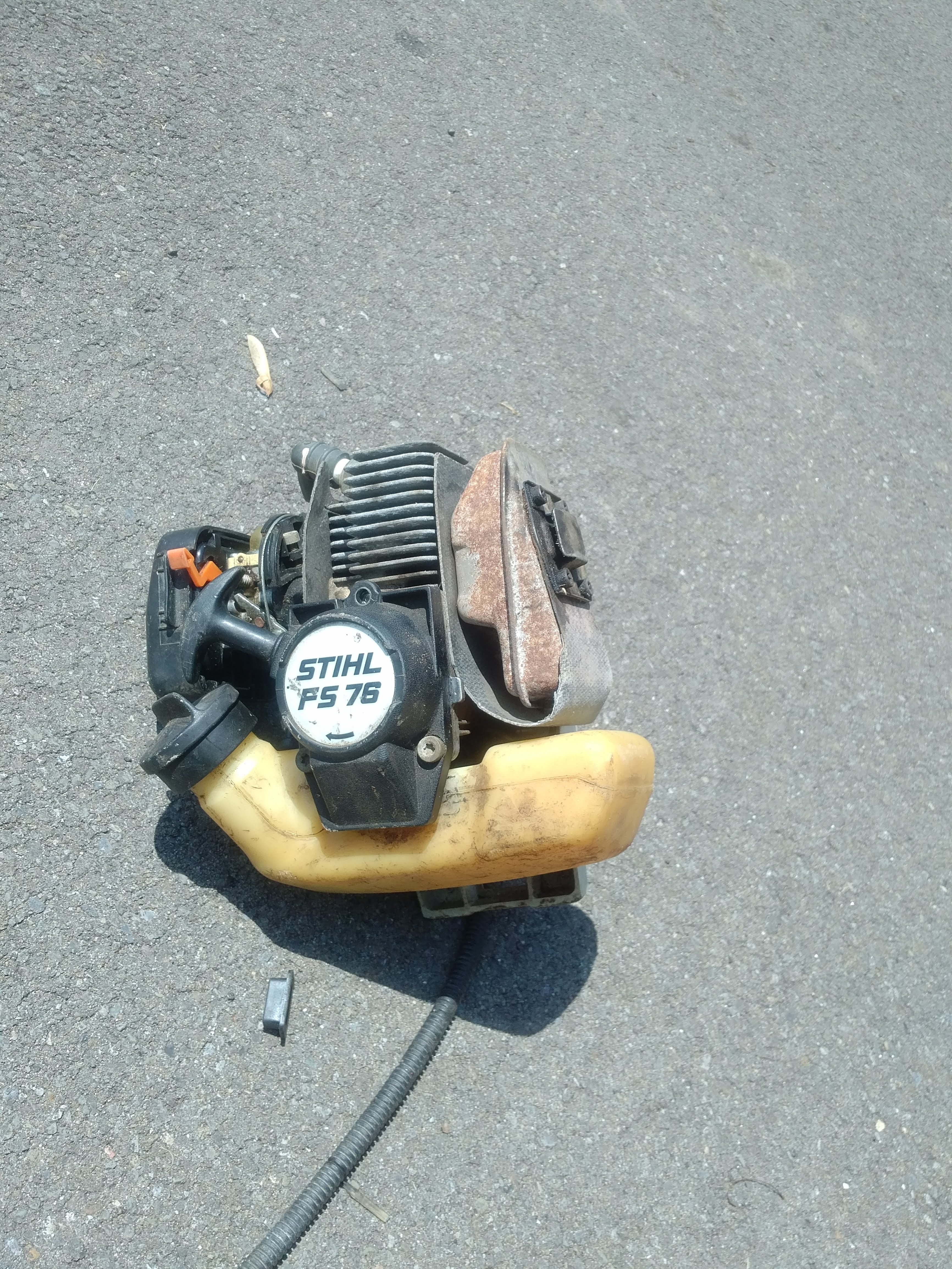

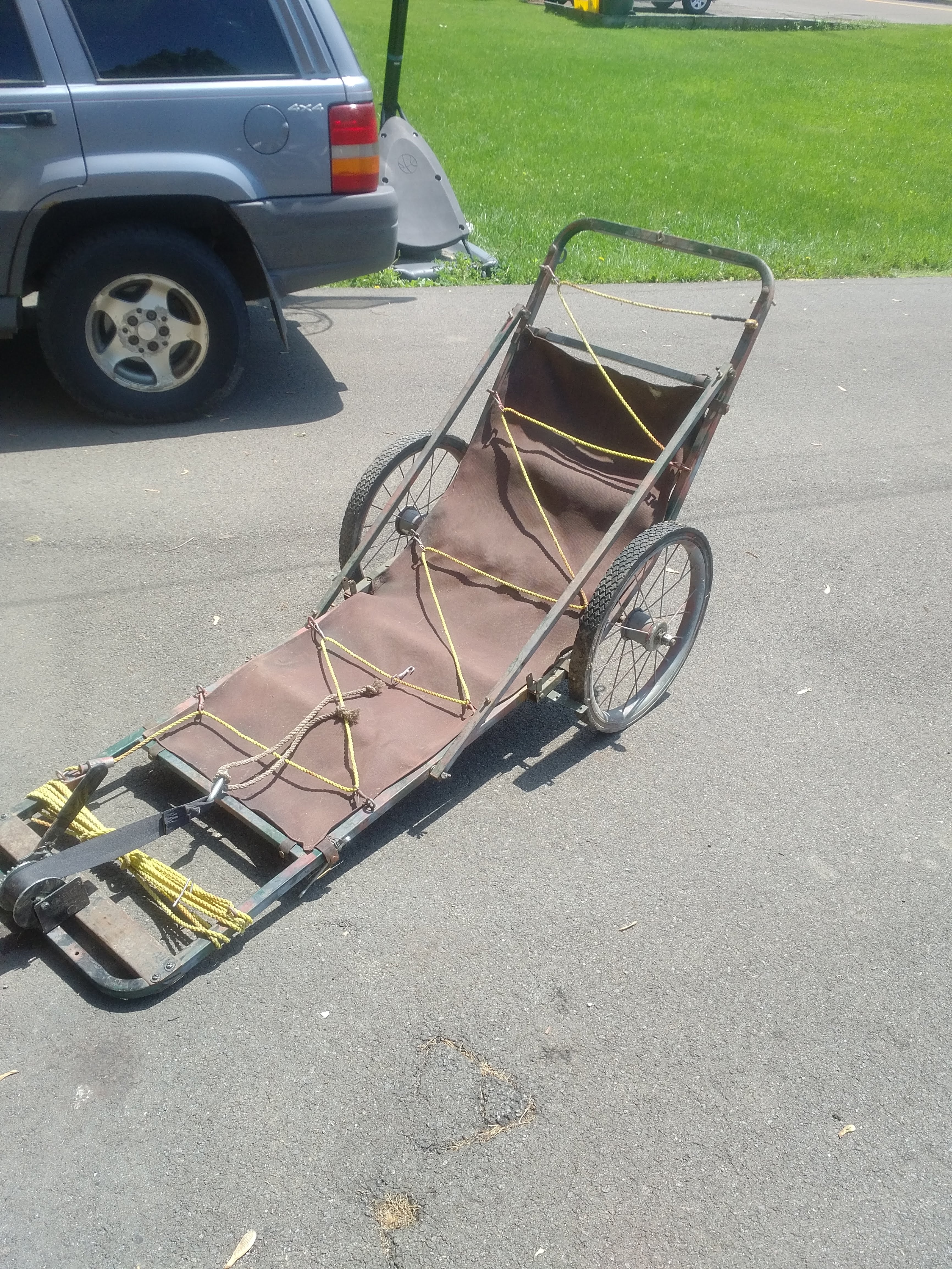

The project I am currently working on is a motorized deer kart. I have a 24cc 2-stoke engine off of a stihl weed wacker. Although this is not a trike or tandem, i am hoping this is the right place to post this build. This project is not yet completed and I am posting it here to get some tips along the way. Here are some pictures of the cart itself

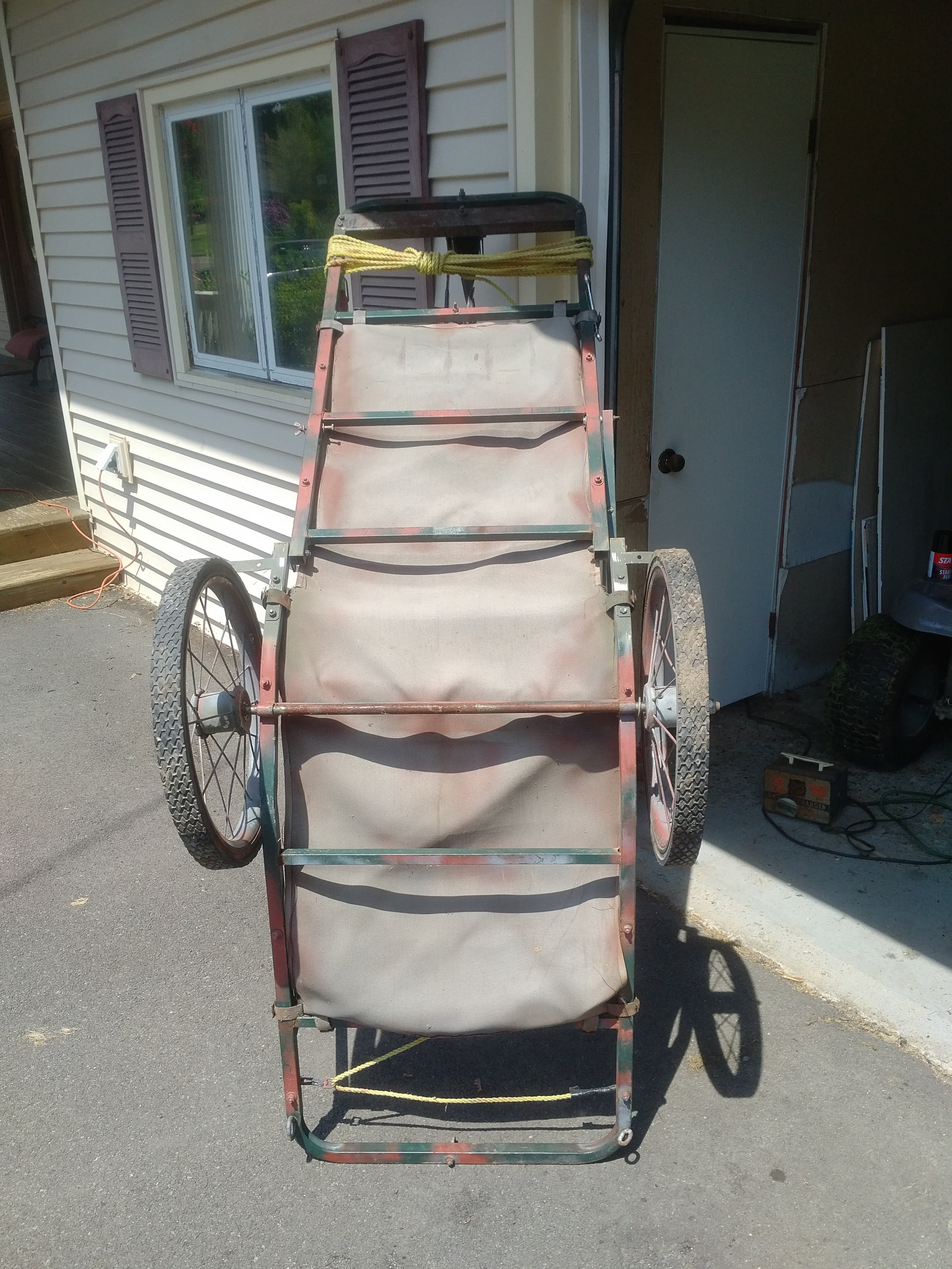

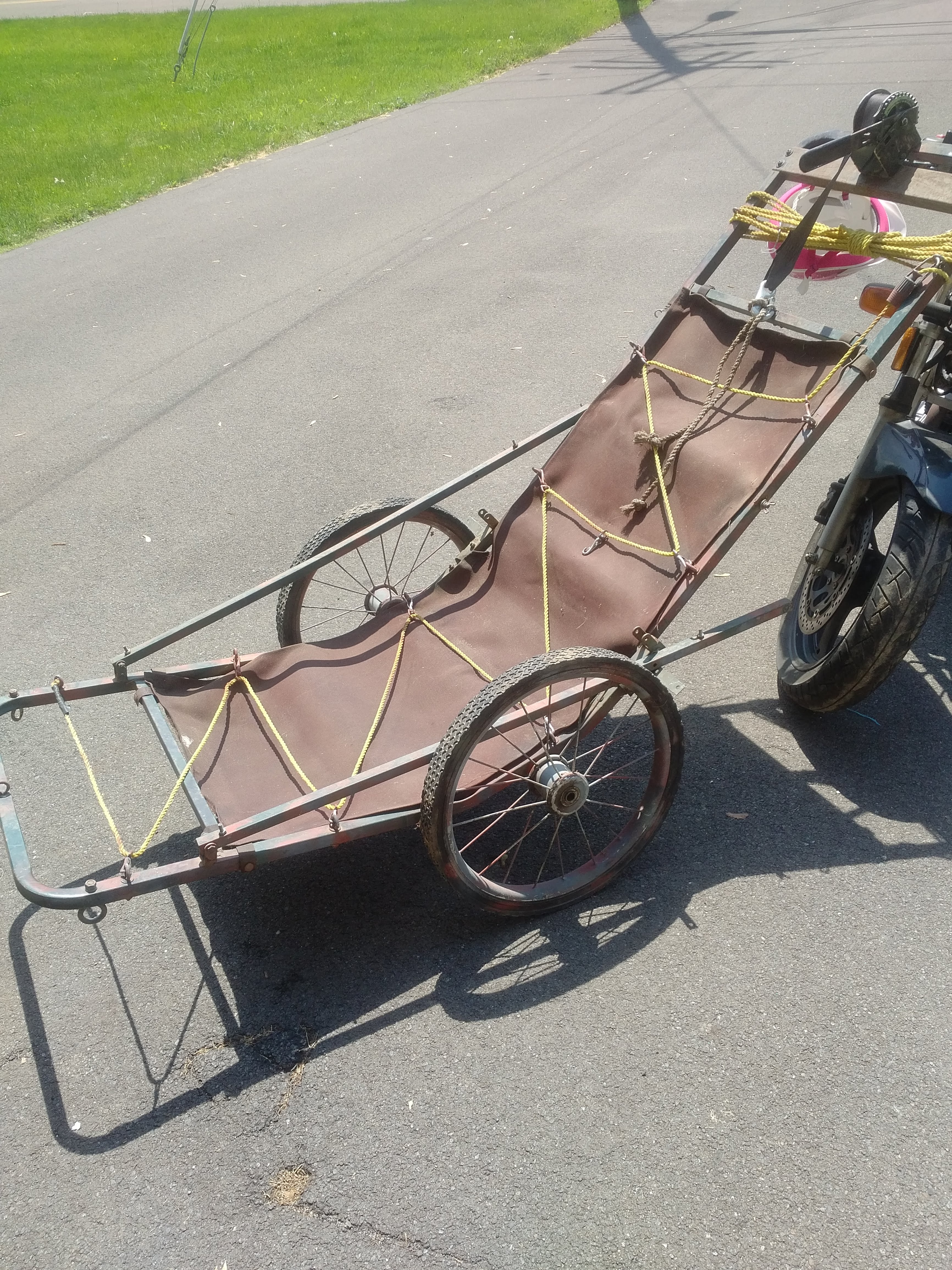

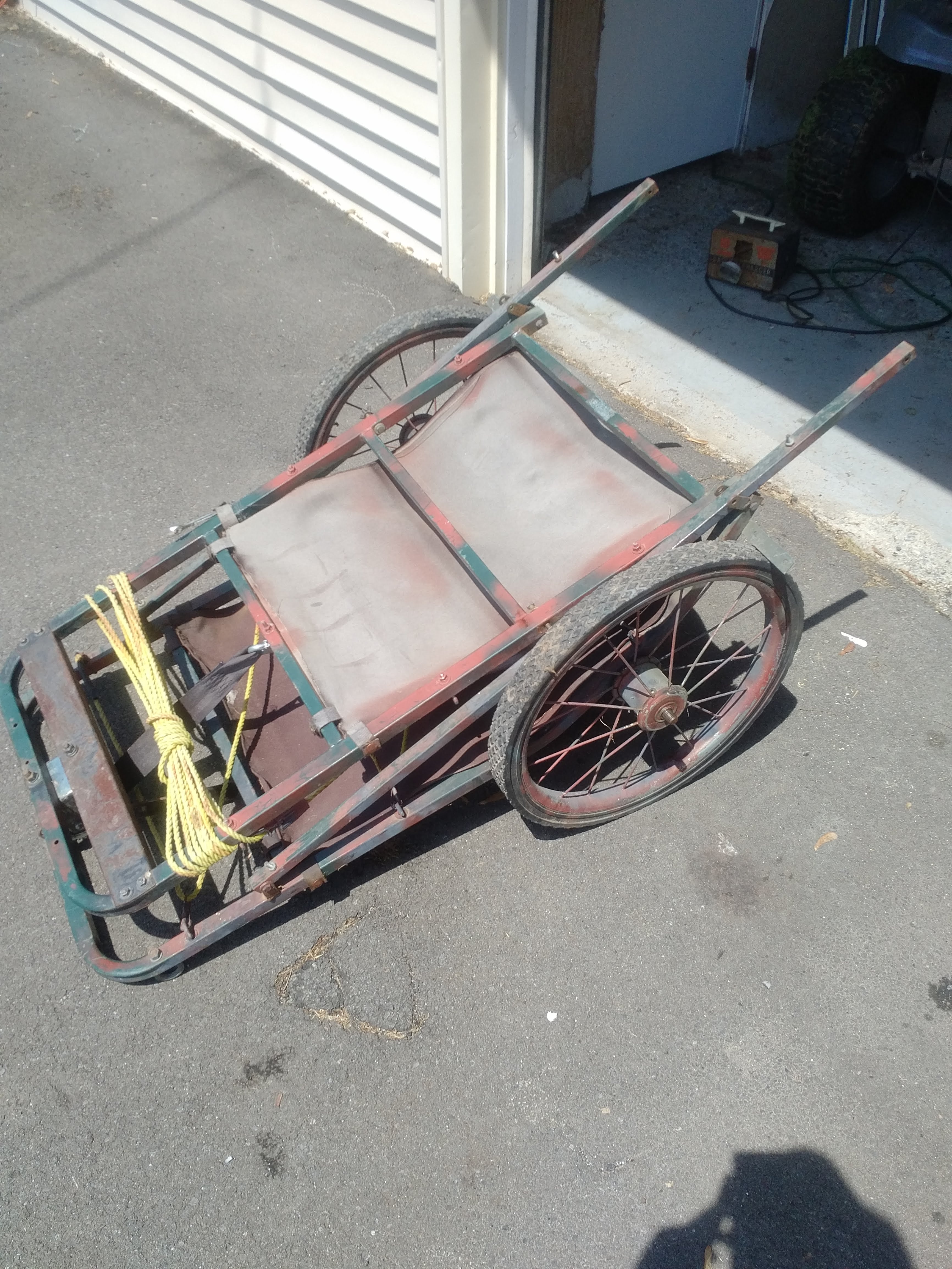

I got this kart off of craigslist for $40. Which I thought was a great deal. The kart is much more heavy duty than a lot of other ones I've seen. It also came with the hand crank winch attached which I thought was an awesome feature. I intend to have my chains and sprockets positioned so that I can still fold the kart up for transportation. I would like to use this kart for hauling deer out of the woods but it will probably be used more for hauling beer and gear in and out of camp.

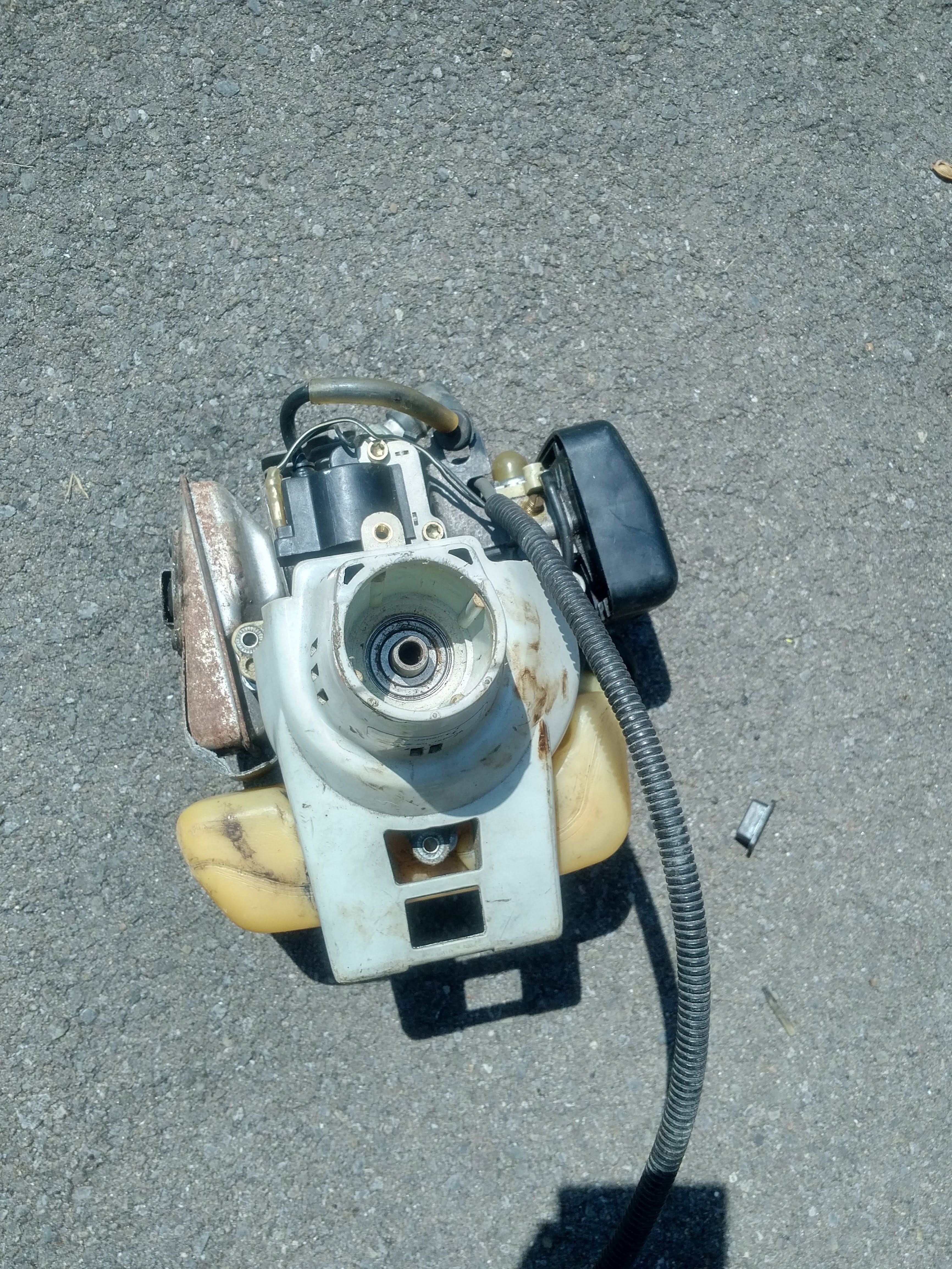

The stihl trimmer was being thrown out so i grabbed it and got the engine running. The engine only needed a carb cleaning and a new primer bulb. I saved the engine, clutch housing, and throttle control with a kill switch. The rest of it I threw away. So all together I have about $45 into this. I am trying to keep this project as cheap as possible. I got some scrap angle iron for free that I am going to use for mounting the engine and creating a mounting bracket for the jackshaft. I also have some axles from a riding mower than I plan on using for the shaft of my jackshaft. But I know the sprockets, chains, pillow block bearings are going to be my main cost (none of which i have ordered as of 6/1/18). I have to include a jackshaft to get the gearing low enough. This cart only needs to go walking speed and not much faster than that. So here is a sketch up I did for the drivetrain and gearing plans.

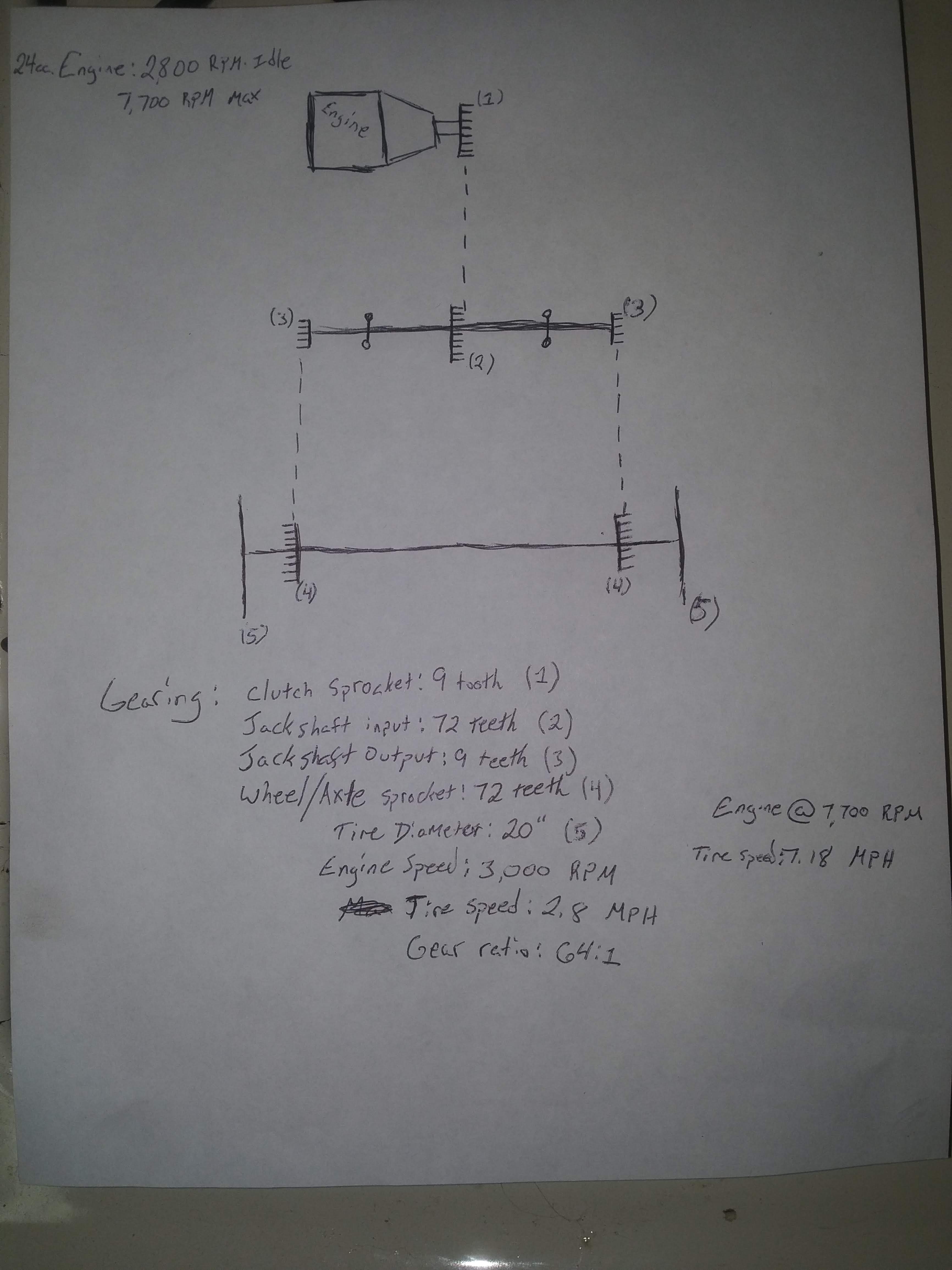

I used a gearing calculator https://www.electricscooterparts.com/motor-jackshaft-wheel-gear-ratio.html to determine the sprocket sizes I will need to achieve a speed of about 3 MPH. The engine idles at 2800 rpm. So I assume the clutch will engage at 3000 rpm, or atleast close to it. If I use sprockets with 9 teeth to 72 teeth twice, clutch to jackshaft and then jackshaft to wheels, it will go about 2.8 MPH. Just slightly under the 3 MPH I was shooting for. I was able to find the owners manual online and that says the engine has a max of 7,700 RPM. So at 7,700 RPM it should be going about 7.18 MPH. Which is close to running speed. This comes out to be a 64:1 gear ratio. I figure this will give me a good range of speed all the way through the throttle. If someone knows of different gearing that would work better than please let me know.

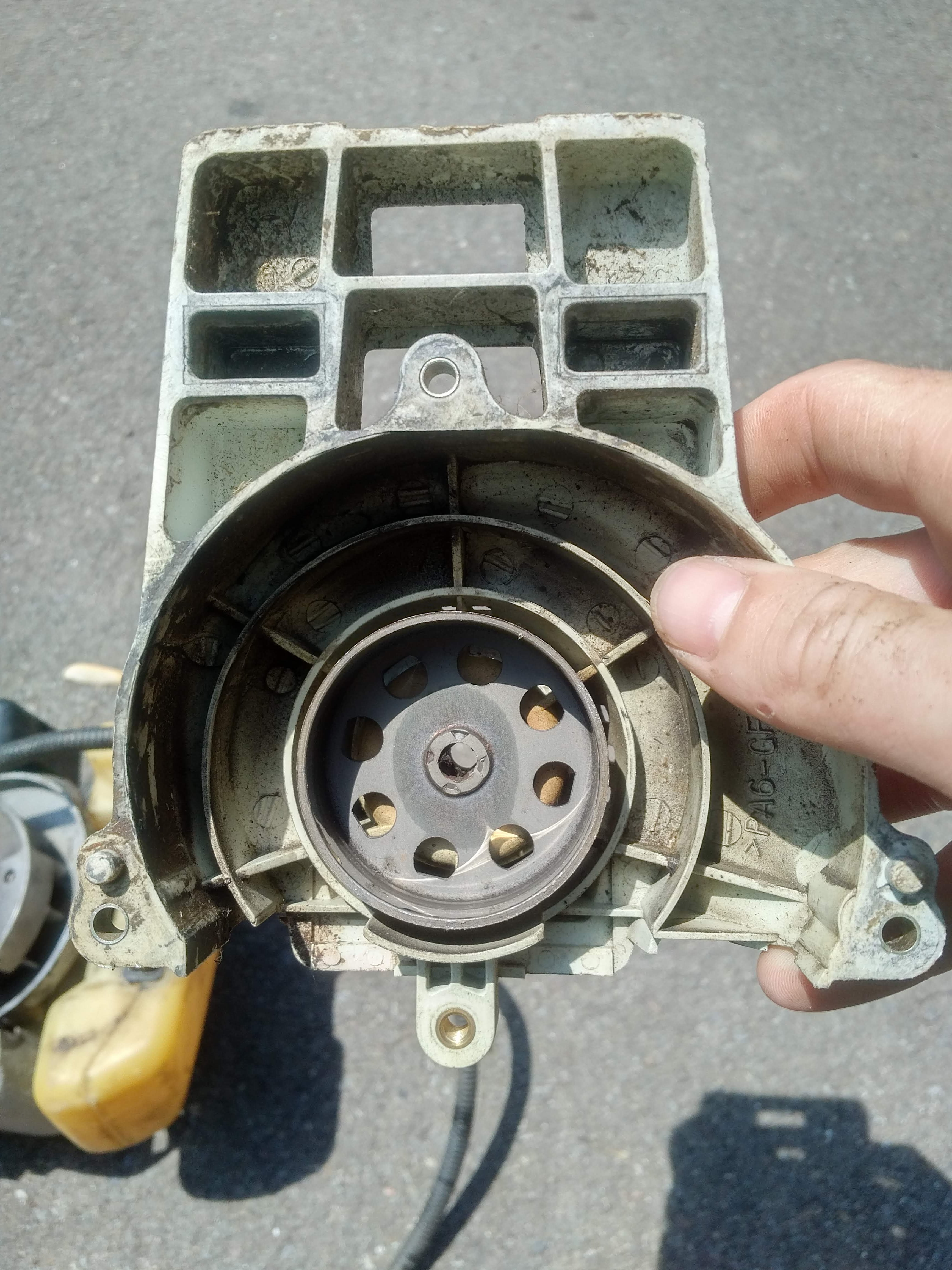

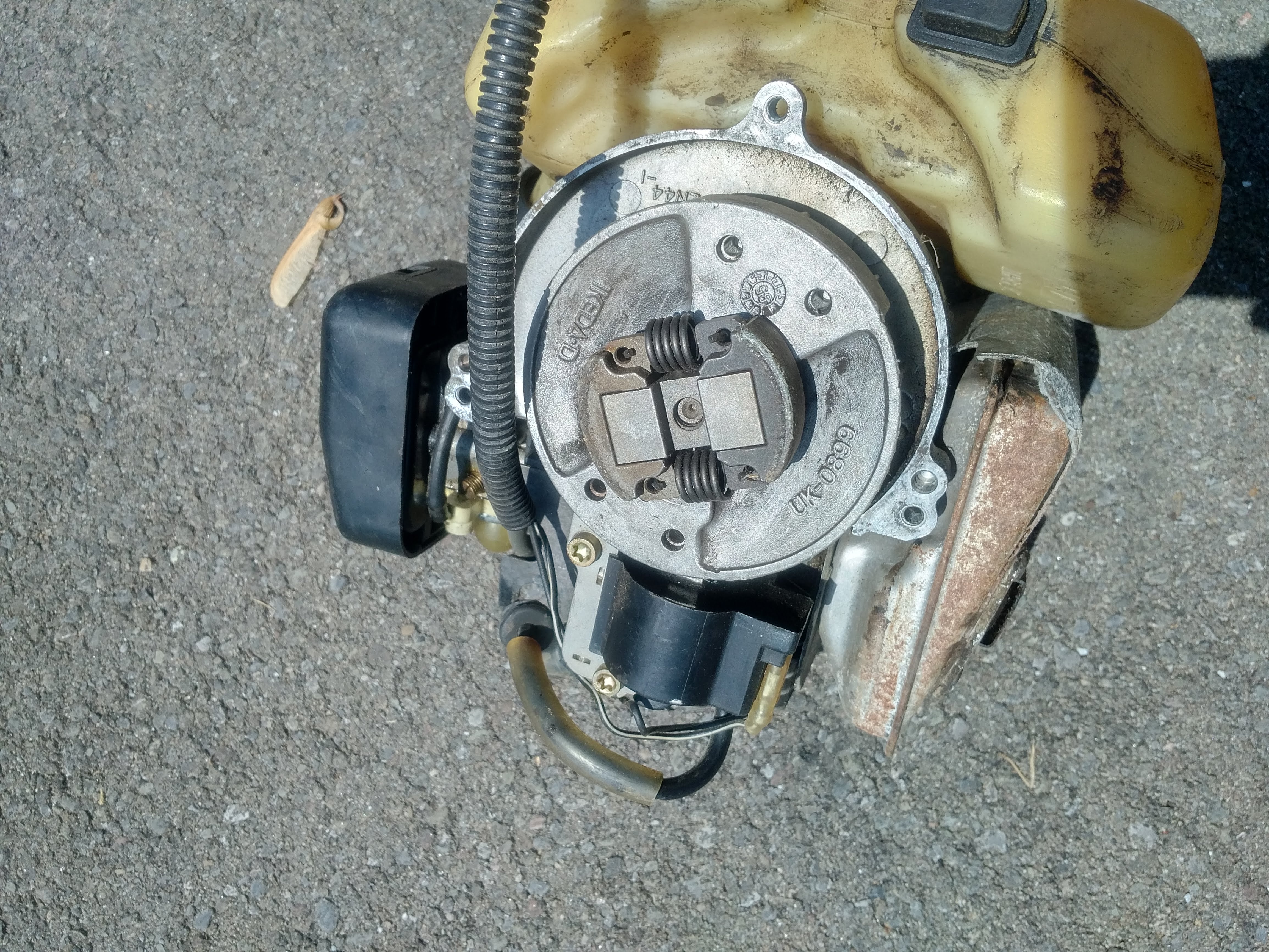

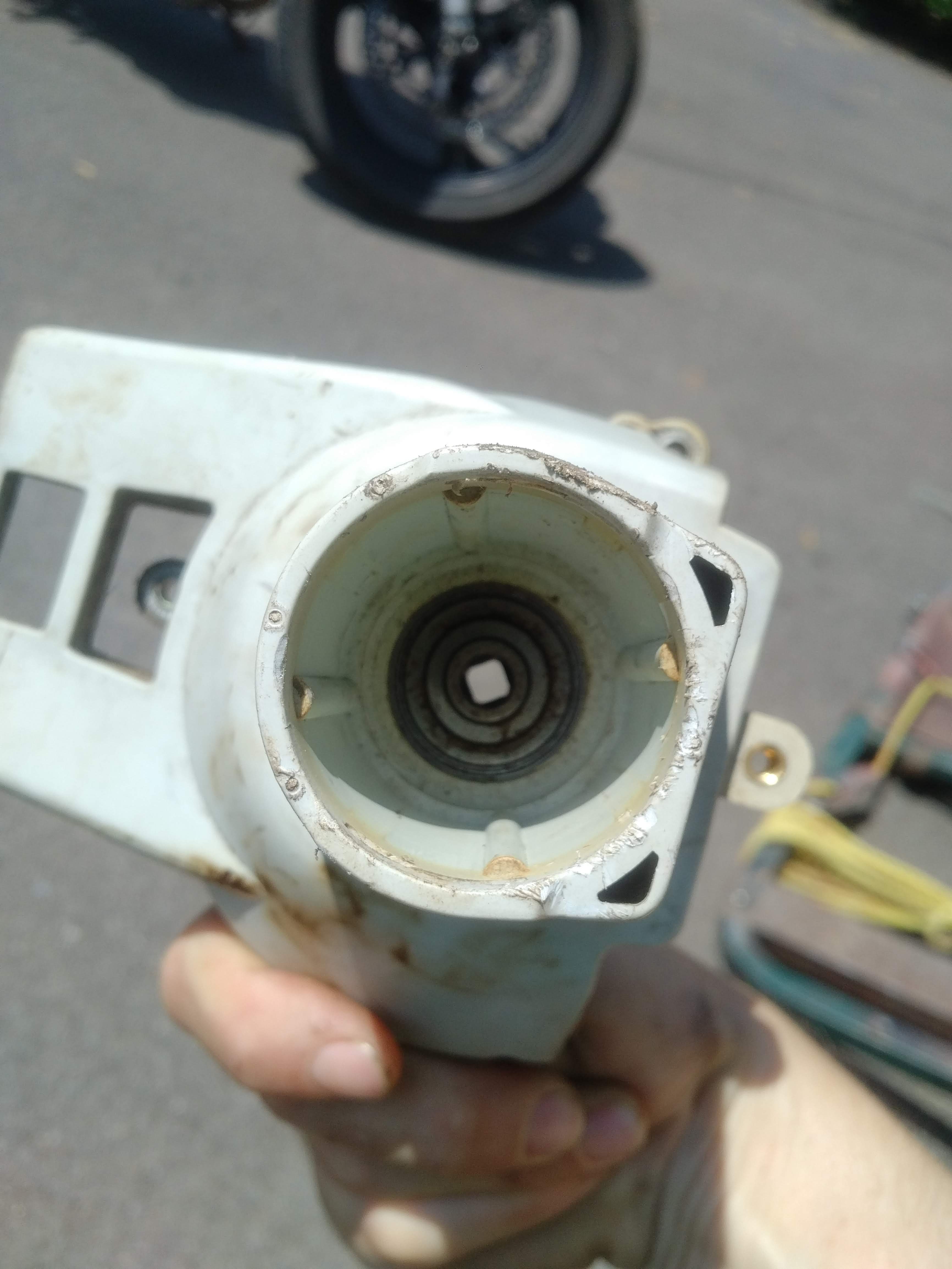

One thing I'm not completely sure of is how I am going to attach the sprockets. First off is the clutch.
As you can see in the pictures, the clutch drum has a square hole. So I suppose I just need to find some steel rod that i can square off on my bench grinder and use a type B sprocket to attach it to the squared rod. This rod also has to be strong enough not to twist or bend when this kart has a deer on it and an engine spinning at 7,000 rpm. Which make me question if this is the way to go. If any of you guys have a better suggestion on how to attach the sprocket to the clutch, please let me know.
I also question if this clutch will be able to handle the load of this kart. I don't know for certain, but i don't think this kart will have much more than 150 lbs on it. Again, I'm sure someone on this forum has a lot more experience with these centrifugal clutches than I do. So if this clutch is just going to start slipping the minute I put some weight on it, than please let me know what modifications I can do to it or if I should look into something completely different.

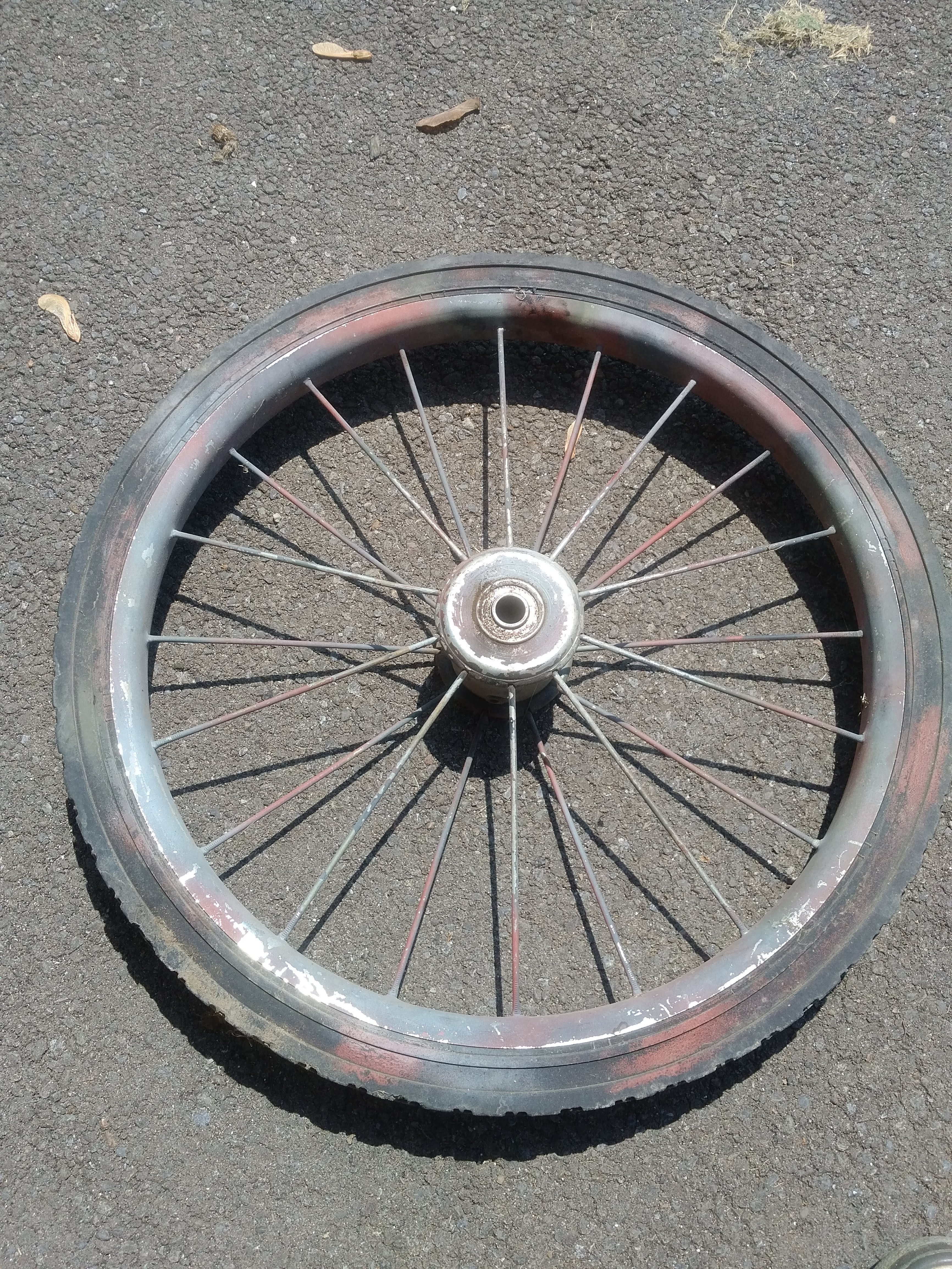

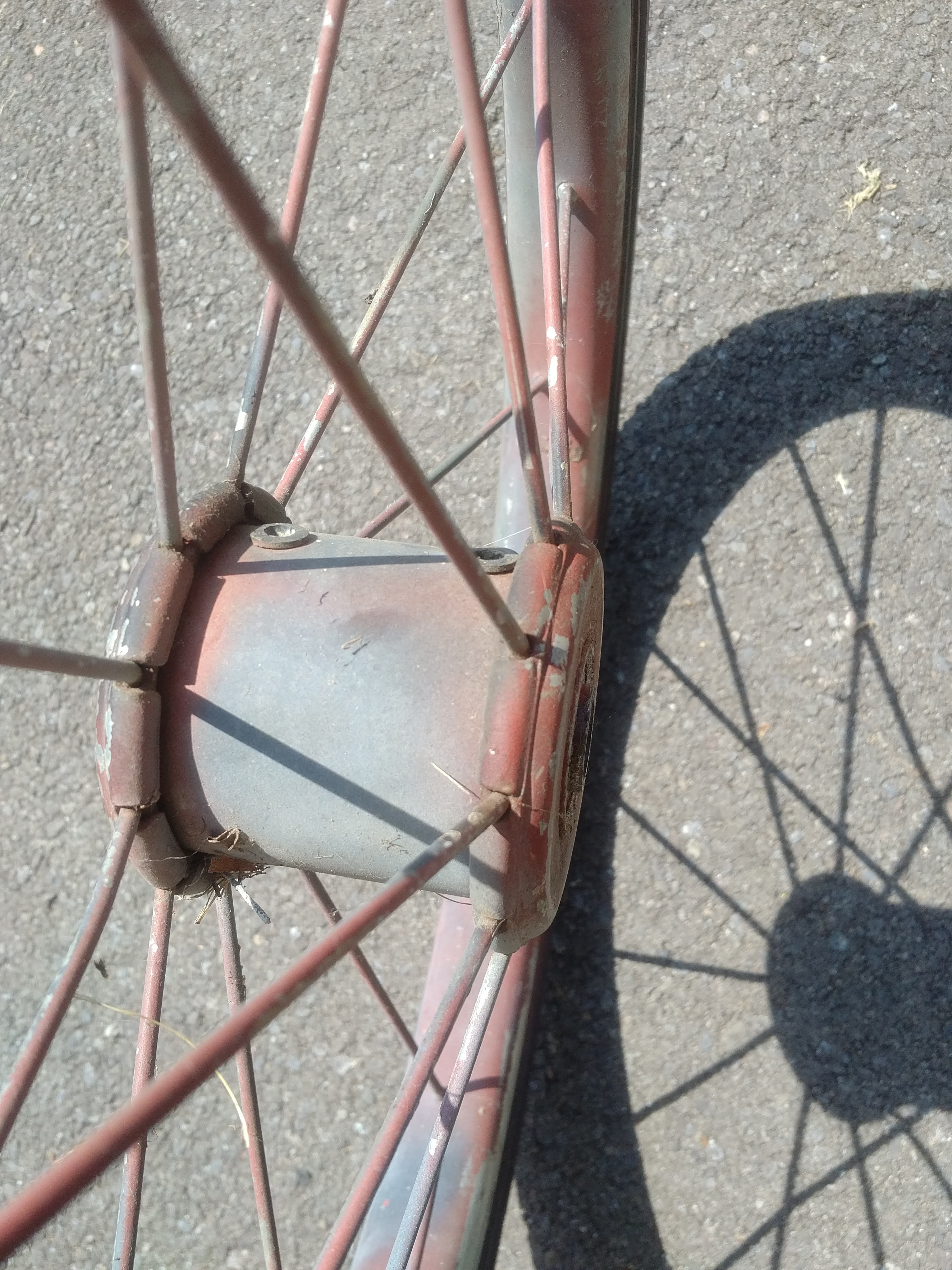

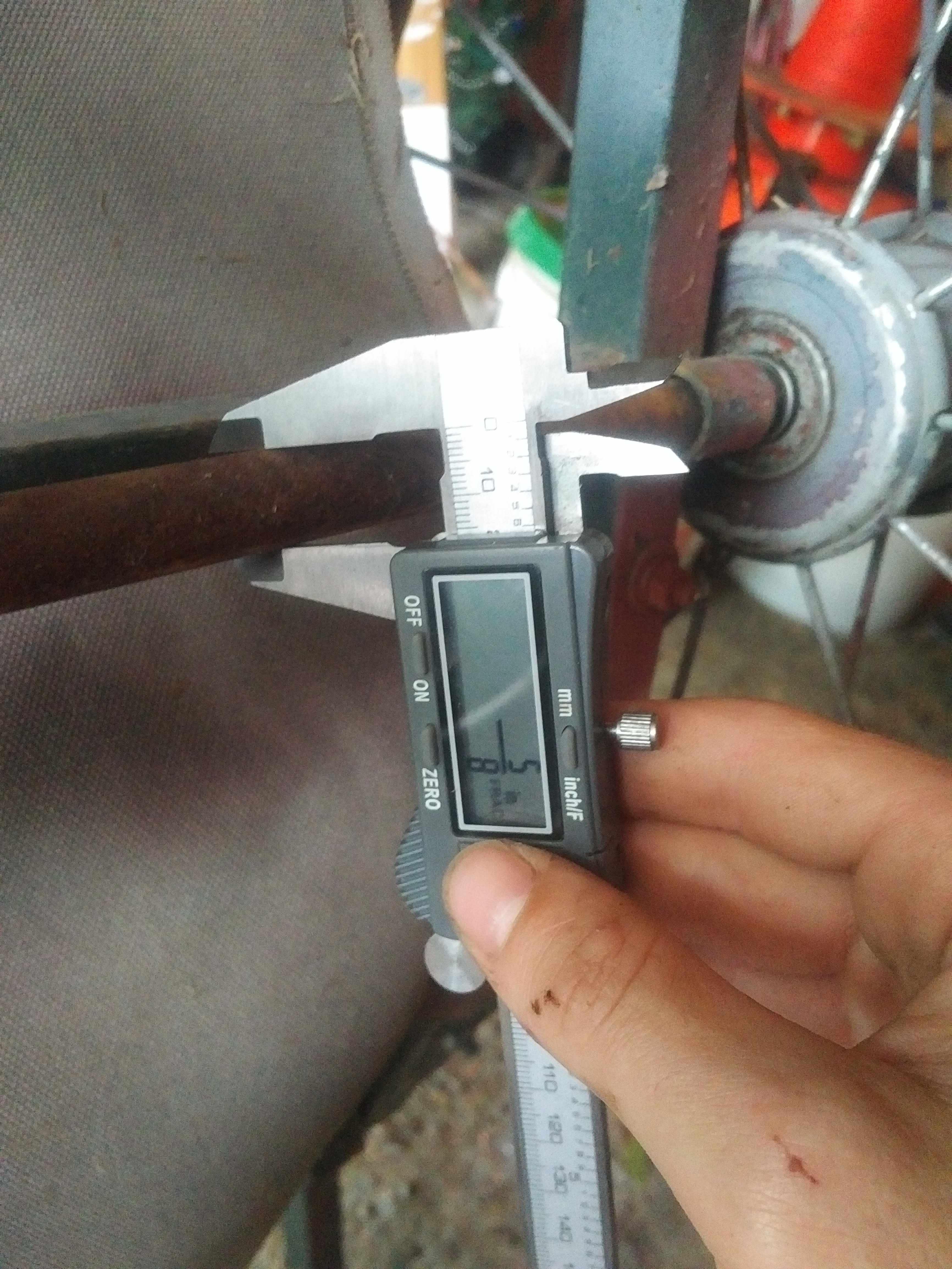

The other sprocket that I am unsure of how to mount is for the wheels. Although this kart does have a solid axle, it is not set up to spin. There are no bearings where the axle mounts to the frame of the kart. The wheels spin freely while the axle has a codder pin going through it to keep it stationary. The inner diameter of the wheel hub is round and does not have a cut out for a keyed shaft. Because of this, I decided it would be easiest to attach a sprocket to the hub of each wheel. Here is the 20" wheel/ tire that I am using.
At first i was planning on drilling right through the sidewall of the wheel hub and bolting a flat style sprocket to the side of the wheel closest to the frame. But after some research I found out about clamshell, pineapple, and rag joint hub adapters. I've found that members on this forum use all different types of methods for attaching sprockets to wheel hubs. I am not entirely sure what is the best adapter for this build. Although the outer diameter of the wheel hub is round and doesn't taper, the spokes are not aligned in the pattern that most bicycle wheels are. They are spaced out much more and I don't really like the idea of clamping a mounting bracket that is going to put excessive stress on the spokes of the wheels. What do you guys think? Would my original plan of using bolts through the side of the hub to mount the sprocket work or should I consider purchasing some type of clamp for the outside of the hub?

Yes. My intentions are to make this kart somewhat self propelled as I pull (not pushing it forward) it behind me as I walk and guide its direction. From a few different builds I've found on this forum, I've learned that I will likely still have to pull the kart with my own strength until I have it rolling and some momentum before the clutch will engage without slipping and let the engine take over to power the kart.
I will be using this kart in the mountains. I plan to haul gear, food, drinks, and other camp items up very steep trails that will be far from smooth ground. The only time the kart will be close to empty is when I'm leaving camp and heading back down the mountain. I really have no desire to ride on this kart. The type of trails I will be on would only be suitable for something with a full suspension and brakes. Maybe one day I will decide to build a motorized bicycle or trike, and of course post it to this forum. When that time comes this project will have given me great understanding of the challenges involved in doing so.
The idea of installing a third wheel in the front of it is interesting though. I'm sure that would help with some weight distribution and put less of a strain on my hand and wrist as I pull the kart behind myself. I will give this idea consideration. Thanks Dogcatcher.

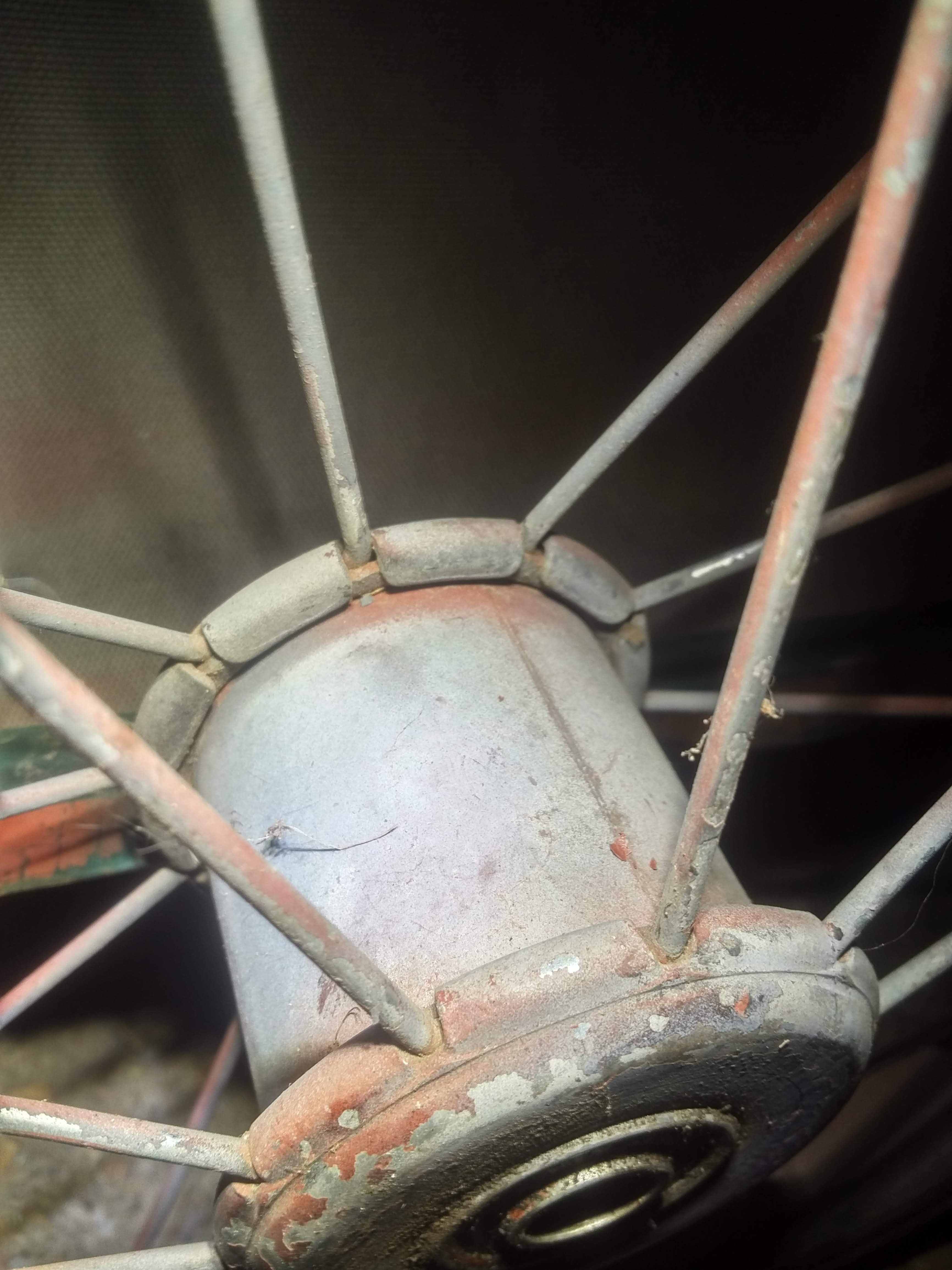

One problem I see is the wheels you have are made for push carts. The spokes are held in with the folded over rim and any amount of power allied to the wheel will loosen them up in short order and pull them out.
You will probably need heavy duty bicycle wheels with 12 gauge spokes to handle the strain.

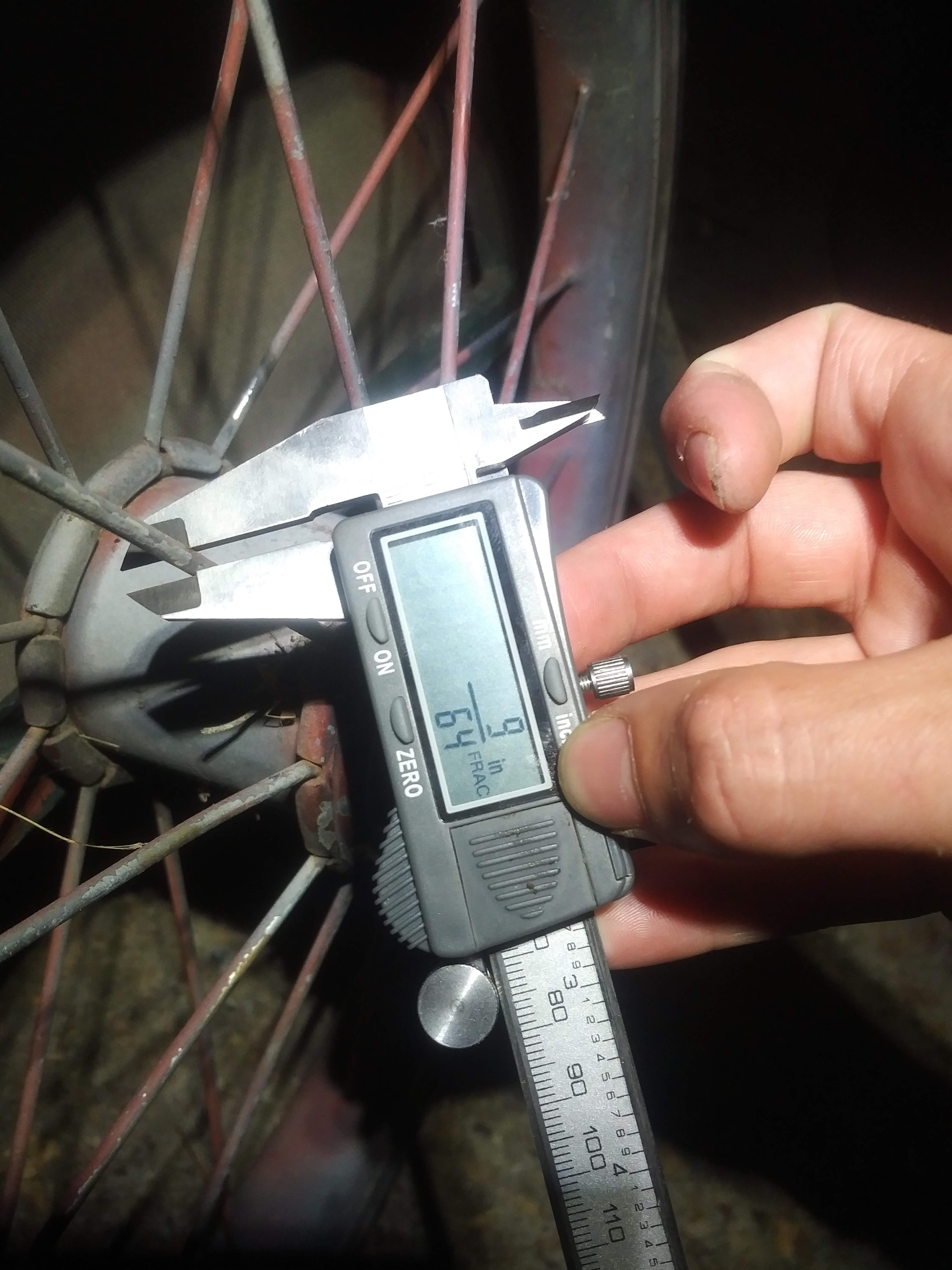

Many BMX hubs have 20mm pass through axles or just over 3/4". You will have to put a single wrap of pop or beer can around the axle to take up the little bit of slack. The hub slips onto the axle and has sealed ball bearings in it. If your axle is 5/8" you shouldn't have any problem finding a through hub in that size I'm sure.

The cart wheels do have 12 gage spokes and 3/4” axles, at least the ones I have seen do. They are also used on 1903 olds repilica cars, that are lawn mower powered through lawn tractor transmissions. So I think he will be ok as his speed is so slow, like that hub link.
Weedge1212 iyour clutch should be good, with your low gearing it should engage right away will be at high rpms very early on, to engage....... Curt

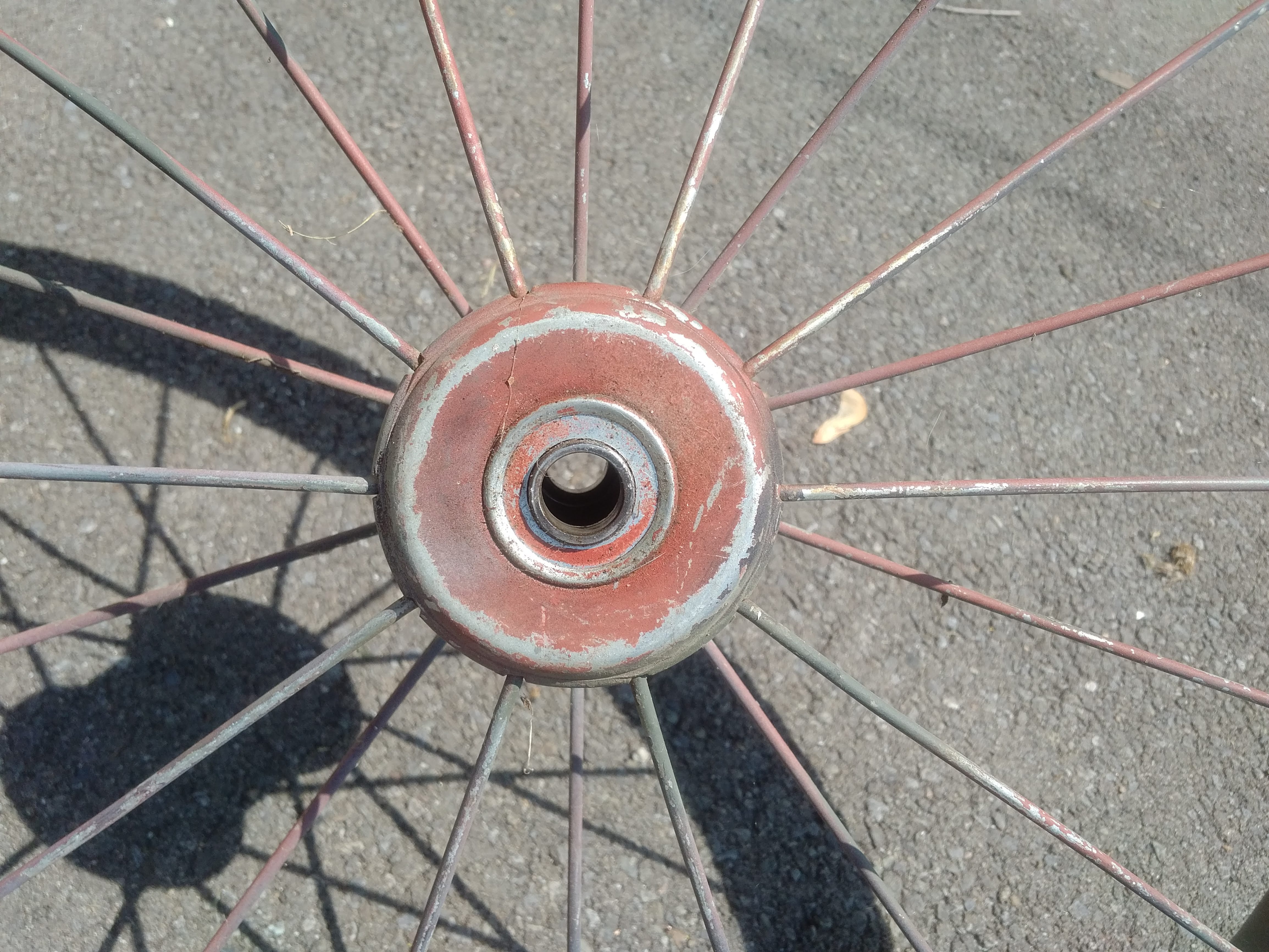

Just thought to put the photos on magnification and the spokes do go through the hub. Probably best to drill through the side of the hub and out the other side and use washers to hold the sprocket off the hub so it clears the chain. Looks like a fun project.

The wheels have been a part that I'm conflicted on. Looking at it from one way, I want to save money and it would be easy and simple to drill through the side of the hub, find some long bolts and spacers, and just mount the sprocket. But looking at it from the other way, I have a set of 20"(I think) BMX front and rear wheels/tires hanging from the rafters in my garage that I'm sure I could buy some parts for to make them work. But I never even thought of using a wheel with a disc brake mount. That would also make things very simple and easy. But if you do think the stock wheels will be strong enough to handle the load, then i will probably just end up using those. Here are some close pics of where the spokes meet the hub. The spokes measure 9/64", I don't know what gauge the comes out to be. Also my axle is 5/8"
Curt, thanks for the reassurance on the clutch. I haven't pressed the clutch drum out of the housing yet but when I do, I'll post some pics and figure out how to attach the drive sprocket.

Curt's a wizard at building bikes so I'd go with his idea of using these wheels. As he said you aren't going any faster than a walking speed and if the wheels don't hold up or prove difficult to do you can buy the bike hubs and use your BMX wheels.

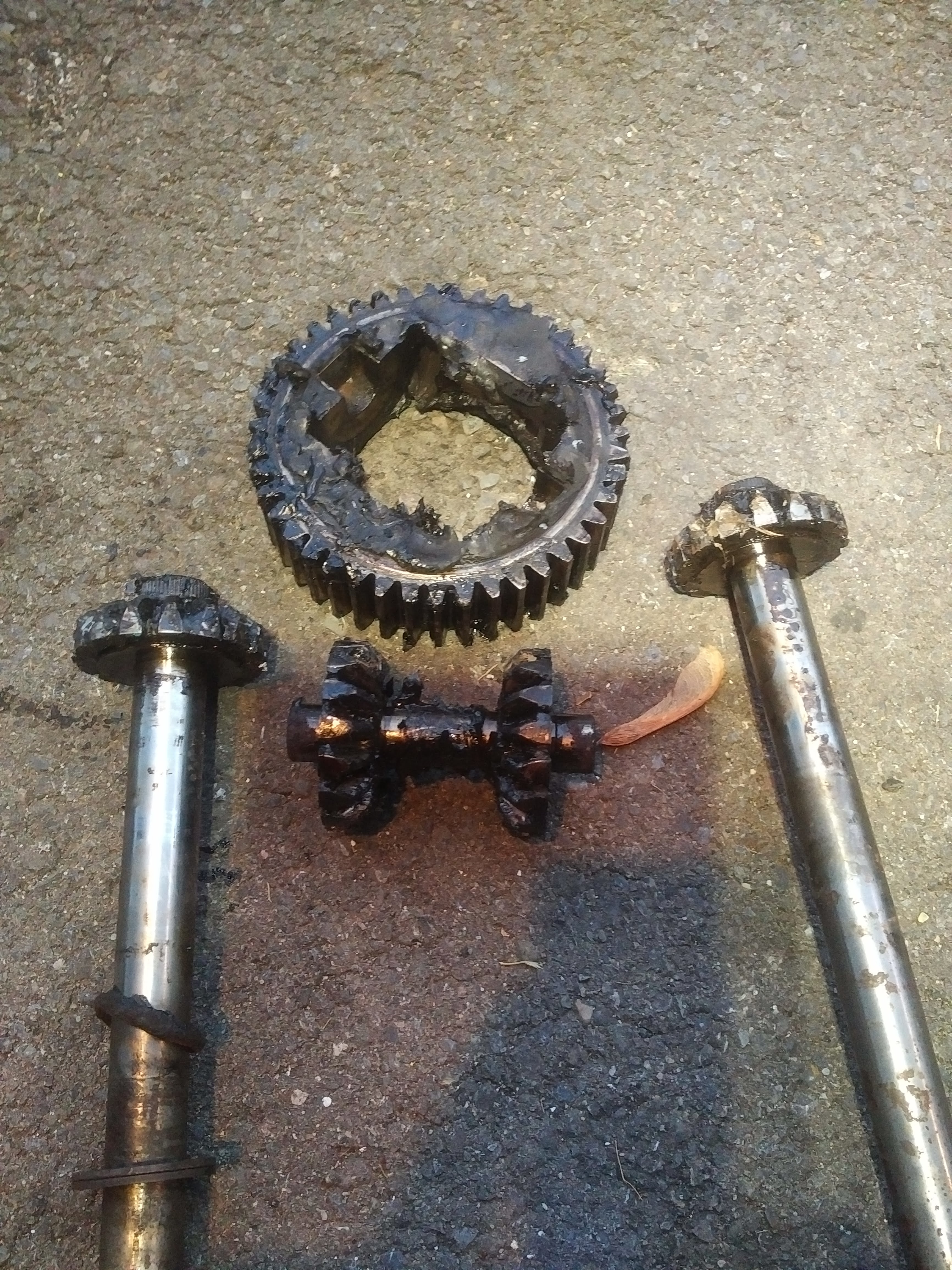

As for the differential, the casing for it is huge and contains the gearbox from the tractor inside of it. It is very heavy and awkwardly shaped. Here's a pic:

That's a transmission with a differential axle not a differential axle on it's own.. Now I see what you mean.Moose Armstrong wouldn't be able to lift it for long.
