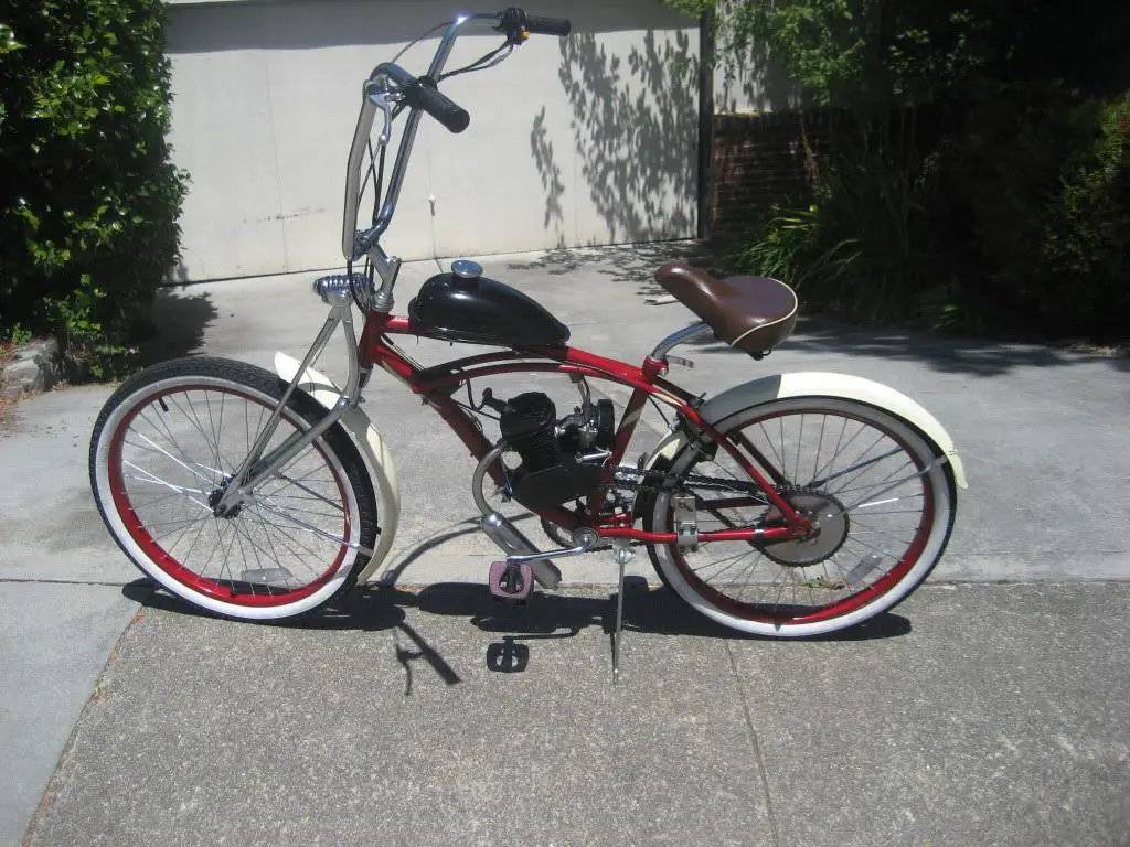

here's my '39 Colson:

Nice looking bikes. Bairdco on Your cycle what is stock and what is newer manufacture?

Those are some tight looking units....just imagine....24"!!! Still on a serious note, those truly are some sweeeet builds, very nice!

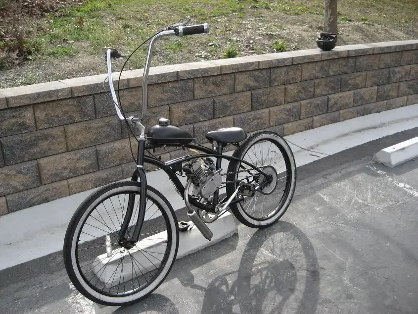

I build on 24" frames because I am verticaly challanged!
