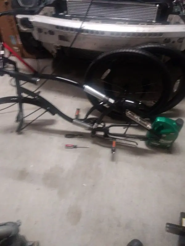

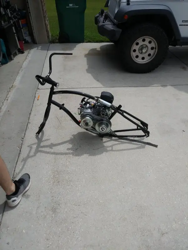

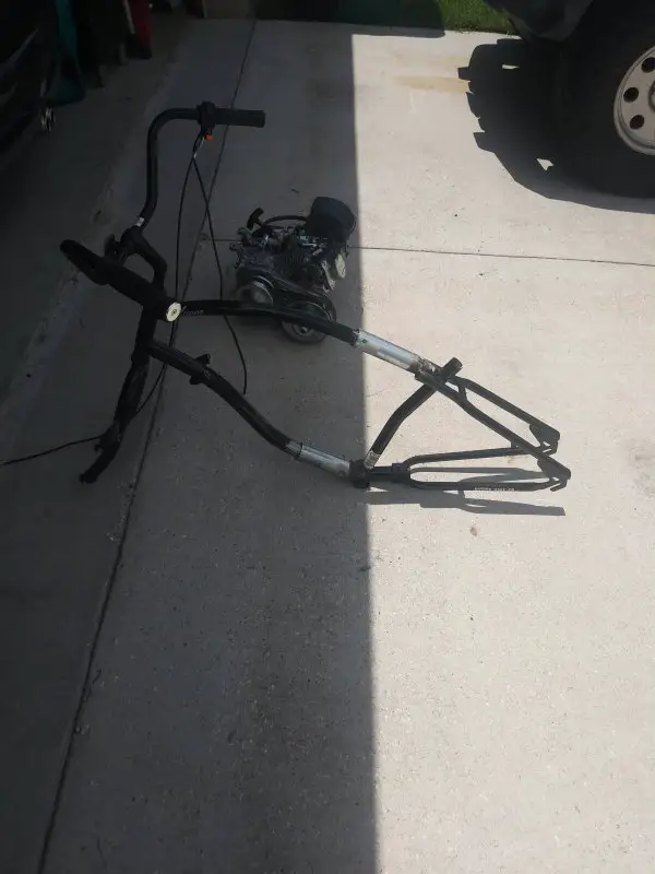

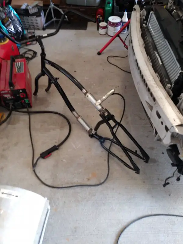

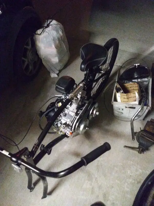

That's the various stages of the build its not much but im just looking to do small time travel and commute to work on it.... I was finally able to get my photos up

I'll stop by the supply store and pick up the #41 and see how it works out, I was just worried that I would have to get a new sprocket for either my torque converter or for my rear
I did but it ended up being a mig machine so I was kinda limited as to what I could do. I got lucky there, so we reinforced the weld by placing bolts through the material used and I went to town on it lol. And the mount I was sent for the motor was too small so went to home depot and picked up 2 ft of angle aluminium and made a makeshift motor mount while still being able to use the slants for a seated mount
I see you picked up a welder, that opens up a lot of possibilities.
Looks like a flux core, I have had one for years. I have a craftsman stick welder and a mig with cover gas as well. That welder will do a lot if you take your time and work with clean metal.
I made sure to grind down everything to a polished shine as so I can have a decent weld, im use to a stick machine, so this was not only my first time on a mig, but also steel to aluminium lol hence why I added the bolts for extra support. I'm reusing the pedals as pegs for my feet and those are gonna go on the forks lol this frame is only temp till I can afford a better frame
Sorry i been out of town, death in family. Greg is the man, LOL. Bike looks good.............Curt
Yea he has been helpful and im sorry to hear about your loss. Thank you for the compliment, I tried to keep everything relatively neat n clean as possible. This is my second build ever and first time big build. So im learning as I go and you guys have helped tremendously. I'm gonna see about going to the store either tomorrow or Sunday to pick up #41 and see how this all plays out
