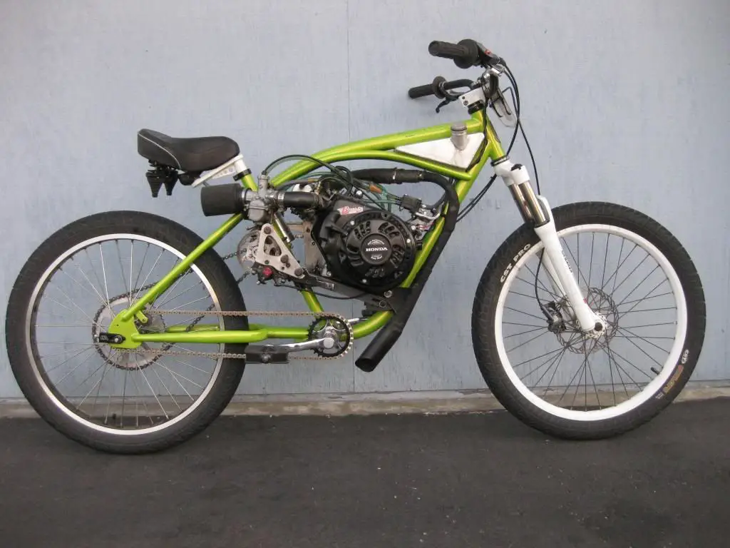

The bike below was supposed to be my first 212 Pred with a TC2 torque converter and I gave up on that as soon as I put the tranny on and tried to set it in the frame.
I exchanged the monster 212 for a 79cc pred and bought the special 79cc pred tranny Quenton makes at EZ Motorbikes.
I just got it mounted today.
That is no sissy engine but a major pain and even after over $400 just for the engine and tranny I would need to buy everything else if I didn't have those parts down to buying or making the plate the engine bolts to opposed to ~$360 for everything to make this this 49cc kit bike on the exact same 19" Macarigi Fatal Love bike.
That machine will do 30+ MPH and it will get your feet wet with everything else before you try to start the really hard stuff.

Just for a quick example of the last 2 days work on the 79cc Pred geared to the customer on his build topic on my site so he can follow progress...
I was told the 44T sprocket I had originally installed would be too small so we re-drilled a big nice aluminum 55T for a 9 bolt mount and got it installed. It turned out great, with our chain matching it may not need a tensioner at all but I'll put it on in case you do.
Since this engine is meant for something like a generator it has a manual throttle and a governor that limits max RPM to about 5400.
We don't need no stinking governors, you just have to be smart and not try to run it at 9800 RPM's for too long and burn it up ;-}
Nothing I found on the net was a simple solution to bypass all the stock throttle stuff and hook up a 1 1/2" pull 1/3 turn throttle cable so I came up with my own which is my favorite part of builds like this.
I simply removed the linkage and spring from the stock system so all I had was the throttles carb actuation tab on it.
That left finding a way to attach the throttle cable and there is a tab right there on the stock engine.
With the pull of the throttle cable and the range of motion for the carb arm hooked up direct would mean about a 1/10th of a turn of throttle from idle to wide open and that's no good.
The solution for full 1/3 throttle turn action was leverage on the carb arm so we used the 2 holes on the carb tab to attach our own longer plate at a 90 and our own spring as well as drilling out the engine mounted tab and installing an adjustable cable stay for the throttle cable.
This is the system at idle with the stock air cleaner on.
You don't even see a spring and the engines idle screw sets idle.
This is the throttle full pull 1.5" 1/3 turn which is full throttle on the carb so perfect.
