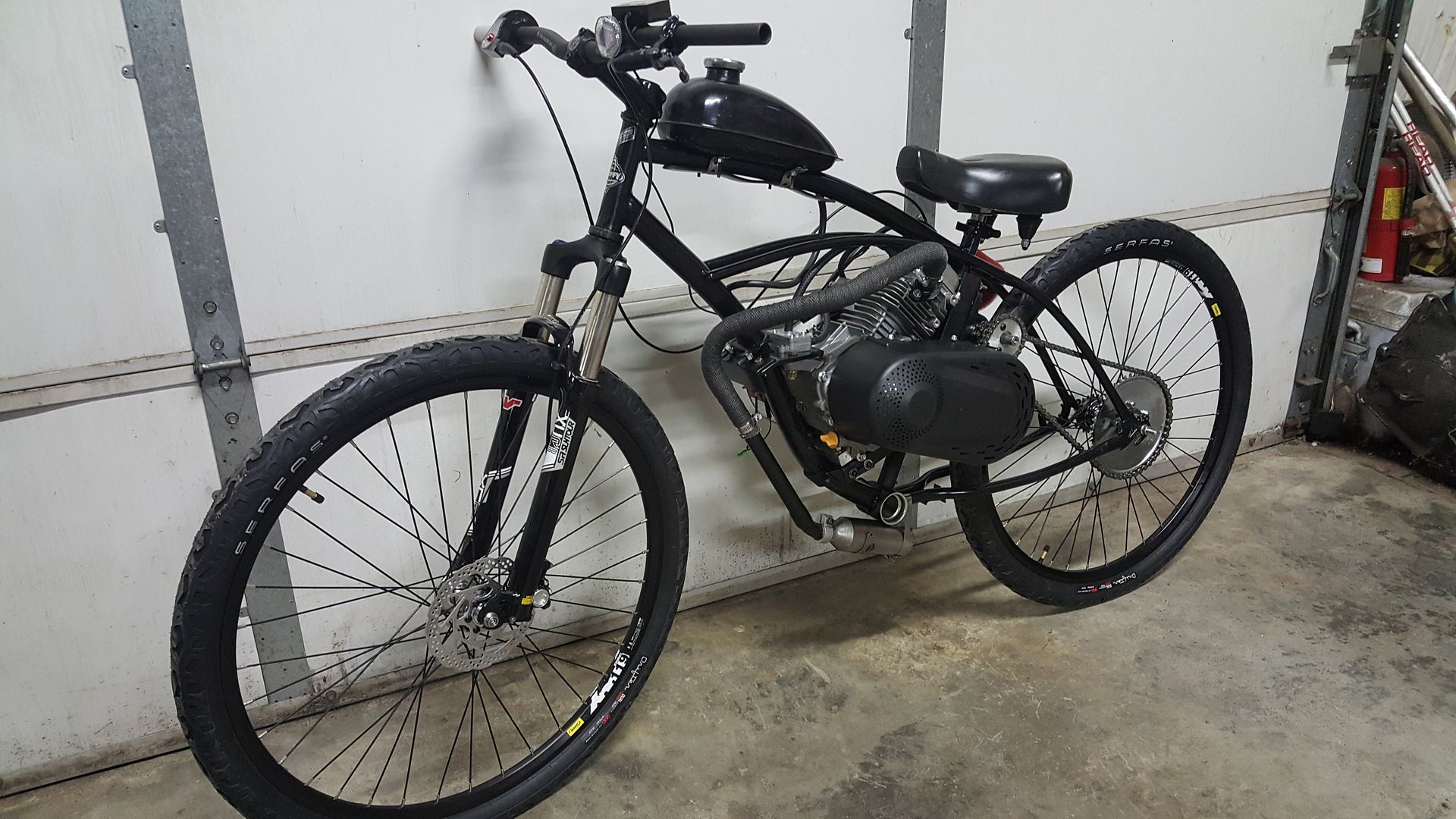

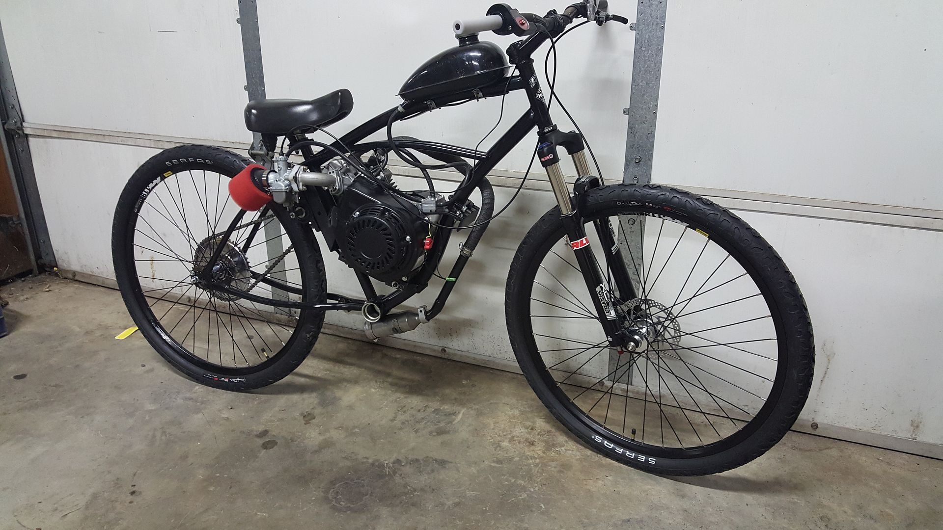

Here's a couple pictures. Still a bunch to do yet but she's coming along. Still need to cut out the in frame fuel tank and build the rear brake mount for the jackshaft. A couple odds and ends and she's golden!
Today I bought a 203mm front brake rotor and installed it. The 160 didnt seem safe enough.. Tightened the front wheel spokes. Bought and installed handle grips. Bought a front and rear light. And installed the wide crank kit and some pedals I found. The bicycle chain sprocket doesn't fit so there's no bike chain for now.
Still needs the fuel tank. Bike chain. And rear brake. I'm having a rear brake disc cut out on the laser at work when the operator finds time to draw it in the program so hopefully by next week I'll get that. And I need to build an exhaust guard for my leg
But tonight I took her out for a test run and holy shoot!! She takes right off!! You need to lean forward like a crotch rocket or else you're on the ground! I don't think I even took it past half throttle and was already going faster than I need to go. Pretty excited!

Not much done yet besides getting parts together and figuring out where I want the engine to sit but here she is! Took it to work to do some grinding on the motor mount since my bench grinder isn't mounted
The only downside I see to the engine mounting here is you won't be able to adjust the valves without removing the engine from the frame. Just something to think about for ease of maintenance.
I am able to remove the valve cover to make the adjustment but I can't remove the spark plug at that angle. That is a winter project though is to move the motor down a touch so I can read and replace the spark plug ☺
