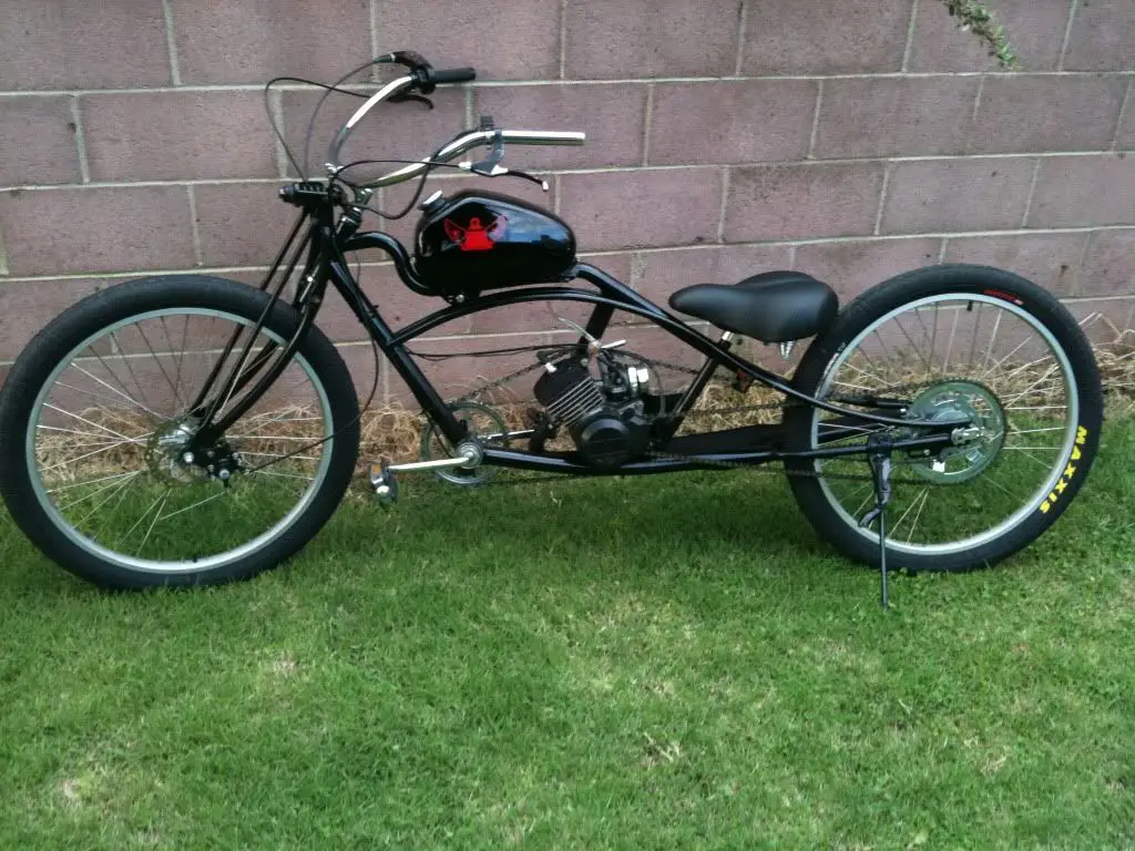

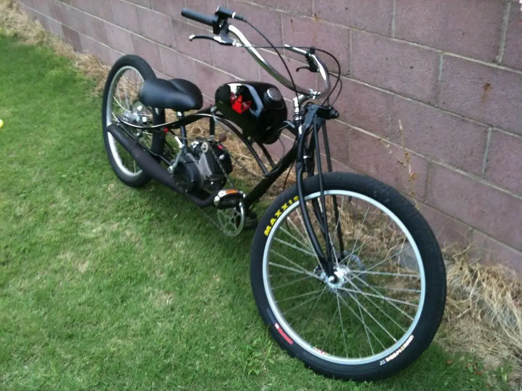

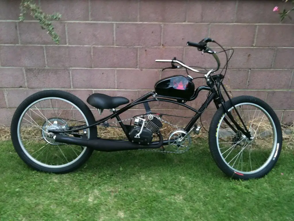

well i finely rode the bike around the block today! its a kustumkruzer [dyno] stretch roadster with a s5n morini, springer forks with disk brake, moped rear hub with drum brake 58 tooth sprocket 11t c/s. teny double wall alum rims 12 gage ss spokes, hookworm 26x250 tires and a treatland $35 chamber and air cleaner. smooth as can be and the springer is nice and tight. both brakes work very well. motor has sat along time and had alot of carbon in the exhaust. each time i or freinds rode it it ran better so i think the youngster was a little light on the throttle [carbon] i'll post some pic's as soon as i finnish touch up paint and talk my son or daughter to post since i'm not smart enough to do it dennis

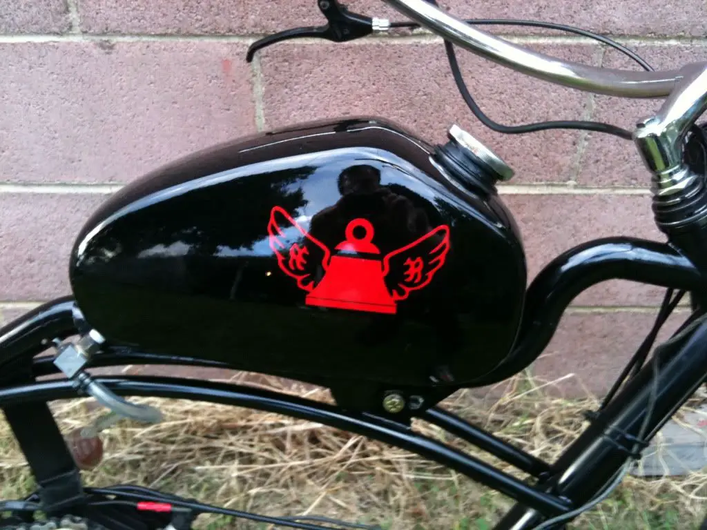

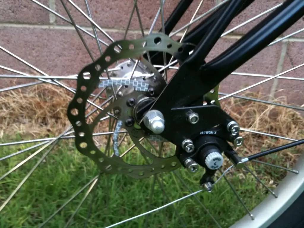

here's some pic's rides real nice. good power, quiet, brake's work great. cheezy flyin bell on the tank thanks for look'in dennis bell

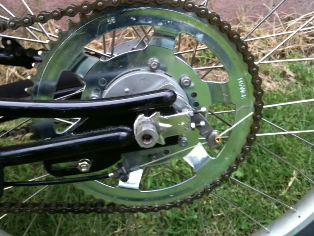

it's nice that people like my motorbike thanks for the kind words. the rear hub is off a motobecane dead moped with a freewheel on the right side and a drum brake [see pic's] and sprocket on the left side. i had to widen the top bracket 1/2'' but went together pretty easy i even used the coaster arm bracket as the torque arm bracket complete with chain adjustment slot.
