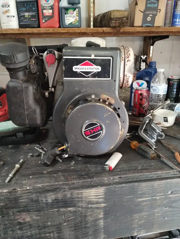

Here's something I did a few days ago. I had a spare 5hp flywheel cover and saw that is almost fit perfectly. This is also on a GC190.

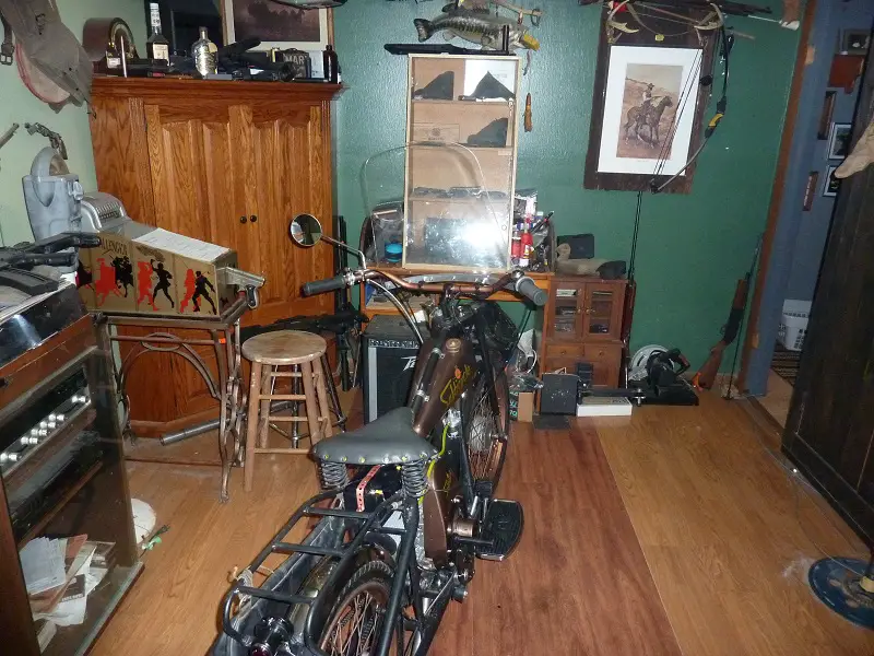

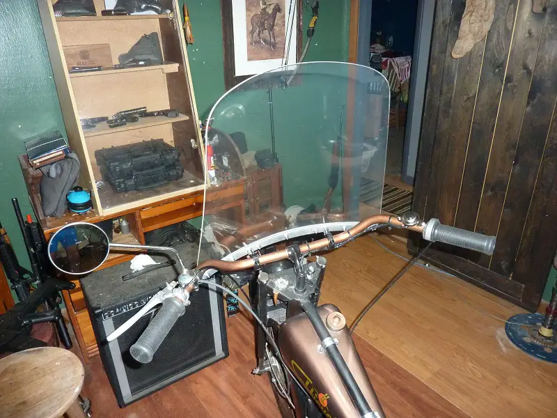

Here is what I was doing today.. I got this windshield over at my Brothers as I mentioned.. I spent a few Hours wet sanding and polishing with the buffer and compound..It was pretty scratched up.. I made an aluminum plate for the bottom..I have some split collars to attach it to the handlebars.. But need to fabricate the mount system between those and the shield itself.. Not sure I am going to like it yet..But will have little invested in trying it.. And it is reversible of course..Here is a pic of it just sitting on there..It is not near as large on there as the pic shows..I think it is kinda like a optical illusion of the Camera..Kinda like holding a fish way in front of you for the pic..So the fish looks bigger..Trick camera angles,LOLThanks
I redid headlights on a Porsche boxter like that for a friend at one point. They wanted 800 bucks a piece for oem replacement lights. A quick sand woth increasing grit and 2K clear paint, and new LED bulbs they looked brand new.

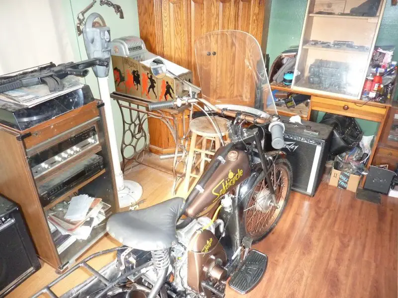

I did go ahead and make mounts for the visor today. I am still not sure on it. It is something that was period correct and sure could have been there..And was probably the Cool thing back then. But if I decide to take it off.. No big deal. A few minute job..
I think I may shorten it up a few inches if it does not grow on me enough.. It might look better shortened a few inches..I know I am the only one that has to like it or not.. Does not really matter otherwise.. But just cannot really decide..
I can see some advantage in it as far as safety in that it does give the little Bike a little more stance so drivers may see more easily..Today we need every advantage we can get,LOL

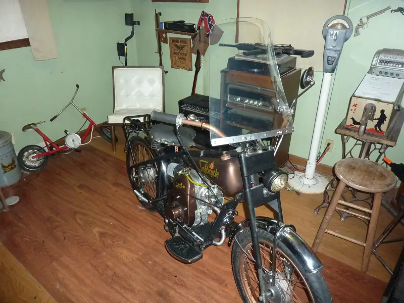

Well I went ahead and shortened the Shield 3.5 Inches this morning and decided I like it so it will stay.. If it had come to me more complete and had a visor originally..I sure would not have discarded it.. So there is probably not much more I will bother you with my crazy stuff. You are probably getting fatigued from my updates..LOL

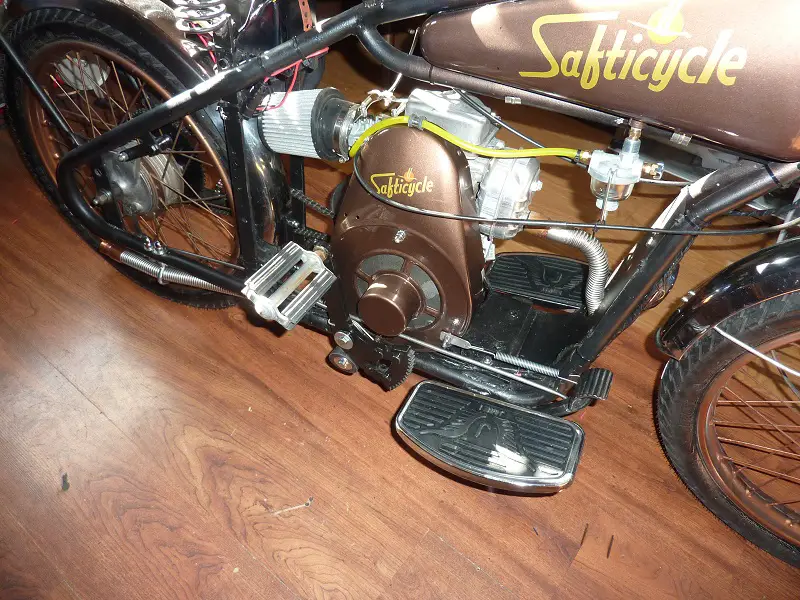

Kinda a last thing I am finishing up..I did not really like the round 3/4 inch stud sticking off the kickstarter the way it was made..So I went out in the backyard and grabbed a pedal off a old Bicycle..And drilled and tapped the kicker for that pedal..I like it better than what the guy that makes the setup did. Thanks
Probably though, you are not thinking to ride it where non-motorized bicycles only are allowed with the single pedal for the kickstarter.
I suppose you could possibly say, one pedal means only half the usual fine.
The care you take and make the bike look more authentic to the period is just marvelous!

Yeah that pedal only serves one purpose. To start the motor..It is just like any standard kickstart on any MC..It is not a propulsion element at all if that is what you are getting at. Where in Northern CA do you live..My Brother lives in a small place called Mineral. He has some off road MCs and Mini Bikes he and his Daughter ride around the area.

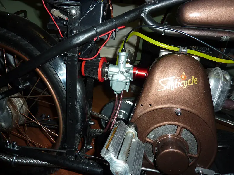

My Chikuni Carburetor setup came in the mail. Have it installed..I was not one bit happy with the Lawn Mower carb that came on the engine. It had no way of adjusting it at all.. The fake Mikuni is fully tunable.. It idles so much nicer. Throttle is smooth in operation, idles very nice now..The original carb was all over the place. And the throttle setup was hokey with the cable you run to it. I had to change the main jet as it came with a 98 installed..But it came with a assortment of those..I have I think the 125 in it right now..Also changed the needle height some too.. I will do some some more fine tuning in the spring.. But so far I am very happy..I am estimating this carb swap will yield 3 more HP and a couple pounds of torque over the factory piece of crap..

Did you get any specific brand of knockoff carb? I really like the NIBBI brand off knockoffs. They're very well made.
I have no idea which one I got.. Just a cheap one on Ebay..I figured for the 40.00 shipped it was not a big risk..I will see how it works out..If I have to spend the 100.00 on an original Mikuni VM22.. Atleast I will still have the adapter and throttle cable that came in the 40.00 kit to use with the real Mikuni, and toss the china carb..Thanks
Ahhh. Makes sense. Here's the carb I was talking about. I really like them.
