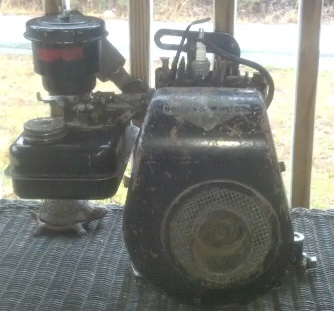

1949 Briggs and Stratton 5s engine E-Bay purchase $85 w/shipping

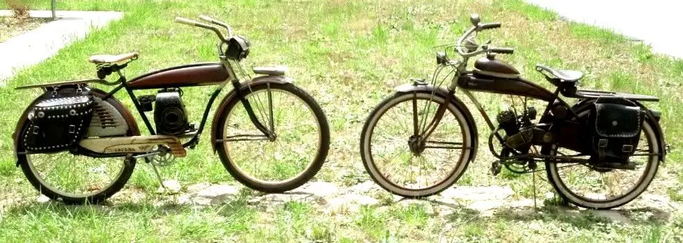

Two of a kind, The mock up of the current build and my 1949 Western Flyer with China Girl kit.

Heres the latest on the 1951-53 Western Flyer build, I've done the final install on the motor and the drive pulleys. Still working on the gearin, right now it will launch from a rolling start but my ulimate goal is to launch from a stop and to eliminate the need for pedaling so that I can maintain the drive system I designed. Going to install a jackshaft and that should work

I really like your bike, it makes me smile. I like the concept of the "farmer John" build, and your execution is perfection. Have you ridden it much yet? I wondered if that muffler might cook your left thigh.
I think the jack shaft will definitely allow you to achieve the 12:1 ratio you're looking for.
Great work,
Gilbert

Haven't ridden it much, I live in the mountains of N.C. so not being able to launch from a stop without pedals is really a deal breaker (too many hills to push off from) if all else fails may have to add pedals or move to flat land. Entered it in a large local car show and got a top 20 out of 150+ cars.
[IMG
With out the need to pedal my leg is well in front of the muffler and well behind the pull start pulley on the other side. If I find I have to add pedals than I may have to extend the exhaust and build a guard for the pulley. I'll keep my progress posted, Thanks for the encouragement.
