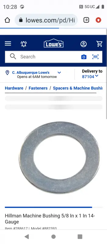

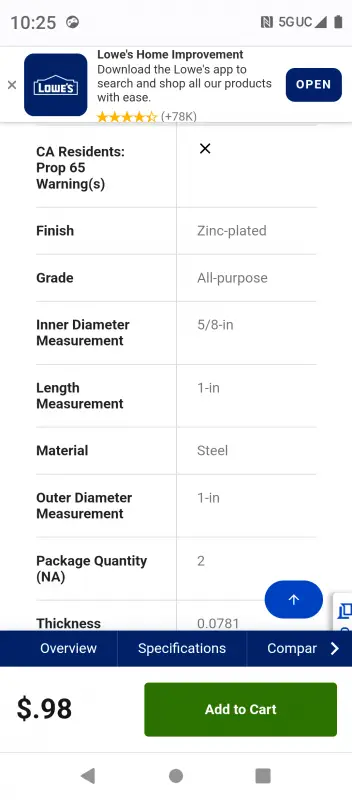

This steel machinist washer is 5/8 I'd and they come in different thickness... It would serve the same purpose as brass but not compress over time... And can be used on the driven side of the TAV...
Your right about a regular washer there also not completely flat...
