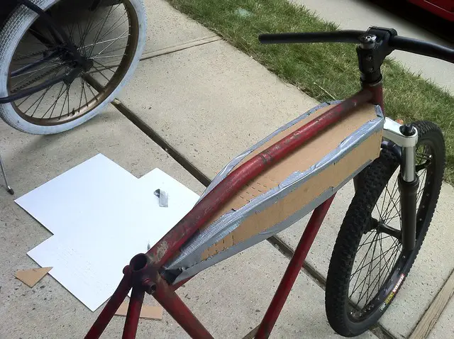

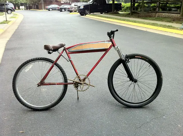

So what happens when you have a day off, bored and a few random bikes and parts laying? You see what fits!
I bought the Elgin frame a few weeks ago for $30. Since there were very few parts left on it, I've decided to go with a "vintage" style build with modern components.

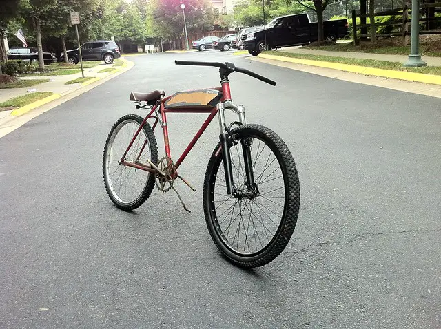

I had my Giant STP2 dirt jumper sitting in the corner collecting dust. I figured the fork would look great on this frame, so after a little cleaning out of the head tube, it slid right in! I need to sort the bearings out, as well as add another shim. This fork will allow me to run either V brake setup or disc. Disc will be in the build at later date. I also plan to cut the internal springs and tubes on the fork to lower it down a bit in order to level the stance out.
I started a mock-up of the tank as well. I need to pull the template apart and do some measuring to produce the more accurate final schematic for sheet metal.

I like it...... and i actually like the suspension fork.
I have an STP Zero....... nice bike.
Ya, it's definitely not "period correct" But I want to do something different, ya know. It'd be easy enough to just buy a springer fork, just the right bars and have a bike that looks similar to other board trackers. I'm hoping to add a bit of personality to this one. Really inspired by what the crew over at Imperial does.
I wonder what black rubber bootys over the inner (upper) fork leg, like you see on older bikes.... just a thought.
Itll look a lot better when you lower the fork. The fork on mine has adjustable travel, that would have made it easier. What forks are they? Cant see what it looks like lowered. And should make for a comfy ride.
I think it looks good and am also now using moped forks on a couple of vintage builds, one of which is a 1934 Elgin step through. I'm using a Tomos suspension fork on it (with the ribbed rubber booties) and like mine very much. No, not period correct just as your 33 is not correct for a board track racer, but so what? I'm getting to where I just like things that are in the spirit of very early motorcycles, but which I want to ride... I'll take a good suspension fork any day over a Monarch or Schwinn Springer for the ride. I have a killer Suzuki fork on a 50 Panther which looks great and rides like a dream come true... you can have your correct Monarch. The moped stuff was made stout and intended to go 30+ mph. I say we have enough board track racers... but not enough kind of free form early looking motorbikes. I say use what you want and make it your ride. Some would cringe that a 34 Elgin would be getting a shift kit and expansion exhaust... let'm cringe.

looks like you are on the right track to me...my only question is this. from the pics she looks a little elevated in the front. is there a way to adjust the forks to make the top bar level to the road? nice work so far...

Tom-Ya. I plan on cutting the springs and center adjustment rod to squat it down. Noticed it right off! If this fork isn't used (my STP2 may get offended at cut front forks ;) )then it will definitely be something similar. Also toying with the idea of triple tree forks, disc brake and clip-ons. We shall see!
