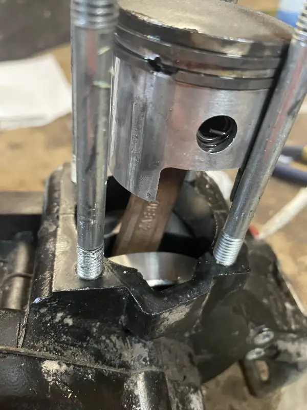

Is that a score mark on the piston?
Is the pin that holds the ring in place still there?
What's the inside of the cyl look like?

those are score marks on the piston
both wrist pin clips are still there
and the cylinder has light scoring with a few heavy gouges
is this normal for the two strokes?. when they are started up they have a crisp clean idle but after only a few minutes the engines can't sustain an idle and make a louder grinding noise. they also lose a lot of power.
Good, the wrist pin clips are still there
There are also pins that hold each piston ring gap clocked in position,
That's what I was referring to,
Sometimes they pop out, I can't see if it's still there by your pic,
I'm placing my bets on 'user error'... :(
