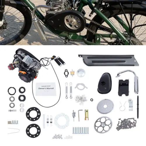

I'm curious what kind of clutch it has? If it has one of those standard minibike clutches, it should be fine.
The chain drive itself should be OK, but the backing plate looks very weak. :(
Another thing I have questions about, is that the throttle cable is connected to the governor arm... If the internal governor parts are still inside the engine, (& working), the governor will be fighting the throttle cable at full throttle. (the internal parts are very easy to remove tho).
Other than that; it looks like a good deal. :)

Look at some similar kits. Some have a chain drive in the reduction box and some use a belt. None say what the reduction actually is in the transmission. Both kits had a 15t-drive sprocket going to a 44t rear sprocket. I'm going to assume a 3\1 reduction box with the 44\15 for a total reduction of 8.8\1 for a top speed of 31.6 mph at 3600 rpm on 26" tires.

30 series TAV with the juggernaut and 7" driver... With the kit to adjust it... Going to be hard to beat...

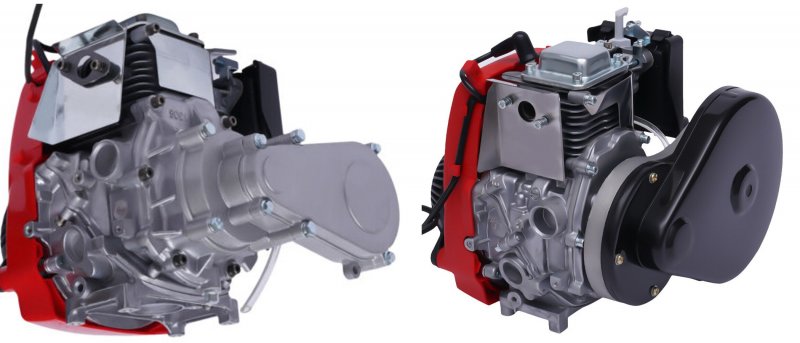

Anyone have any idea what the difference is between these two clutches? Is one belt driven, and one gear?
I've been interested in getting one of these for a while, and since I first started looking, the second one has appeared in the results. Thanks!

Looks like a gear and a belt drive. First post I see, welcome to the forum. For stuff like this it’s best to start a new topic rather than pull up old threads.
The first one is chain drive & the second (black cover) is belt drive... The belt drive is way more reliable than the chain, but the belt drive is a little harder to get the pulleys aligned & adjusted perfectly.

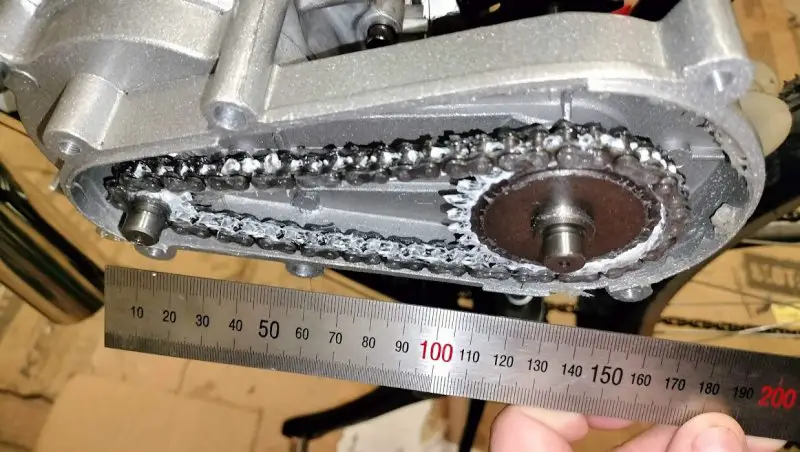

49cc-chain-drive-1-IMG20240512080818.jpg 49cc-chain-drive-2-IMG20240512080818.jpg

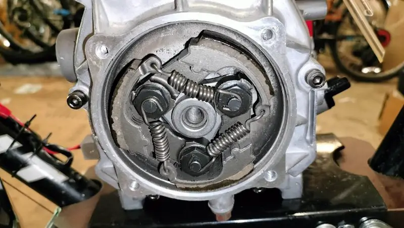

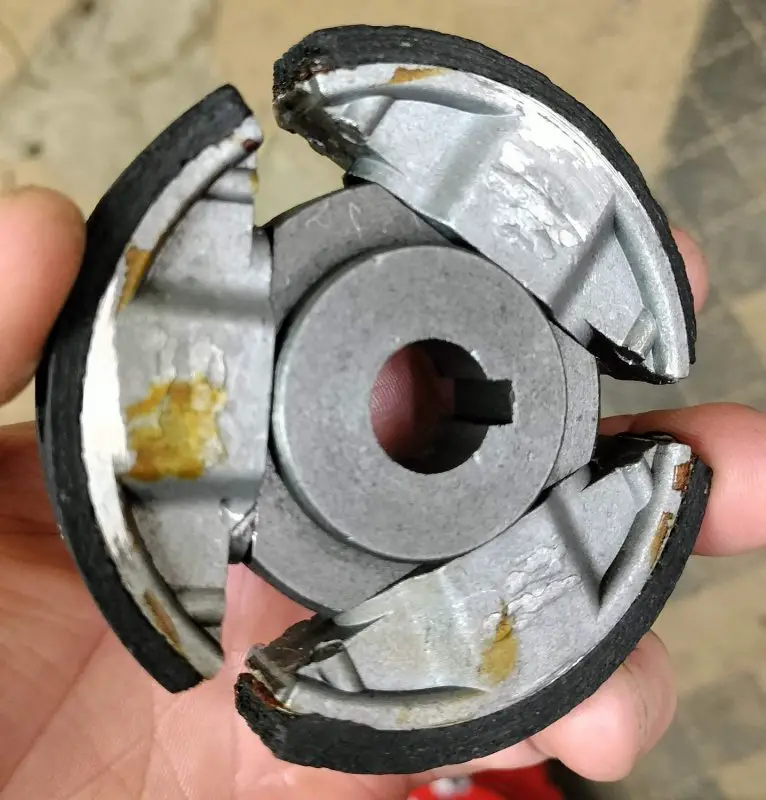

That's a chain drive with two little sprockets, and sometimes with one chain or two chains inside. The chain maybe a #25. The clutch in the chain drive engine is usually this type of clutch. It can be hassle to get working correctly. It doesn't seem to spread out and grip much and the shoe material is hard and dry.

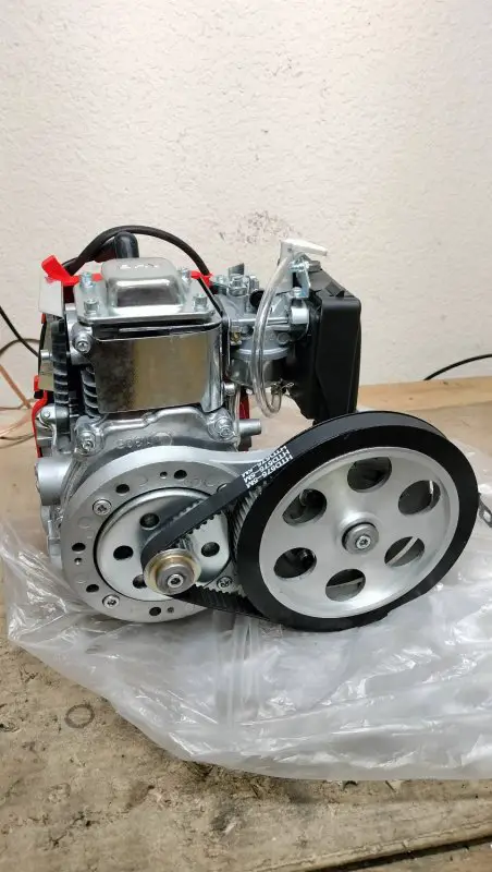

There's the belt drive without its cover. The belt I have seen is a "HTD 575 5M 15" (with I think 115 teeth). For me, this clutch worked really well. The shoe material is kinda rubbery and seems to grip well. I got cruising nicely at 20 mph and pulling my 240 pound self up hills at 15 mph.
