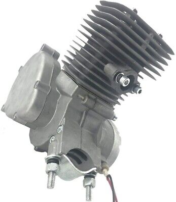

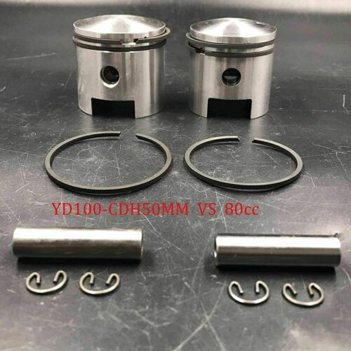

This might be old hat and sorry if it is, I don't get here much anymore at 69 and barely still into tame electric bikes:; I just became aware of the 100cc China Girl and my first question is Are They? As the 80 was really just 66, is the 100cc claim correct? And then what's the quick details? Larger piston surface, longer stroke, what?
And next then? How are they/ Powerful? Reliable? Noisy? Vibrations? etc. What? What What?

There 79cc more power than a 66/80 there bigger case with thick seals on both sides... 50mm bolt spacing there's a 2 piece head LD version... There's a 110 that's 85cc that's a lemon except for the case reed and I'm looking at different jugs for the 110... Utube has some good info on LA hover and Johnny's motorized bikes

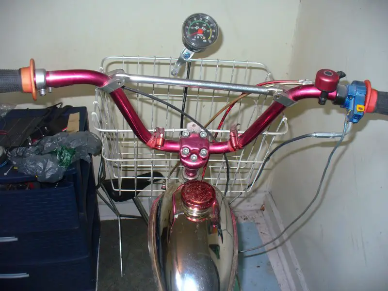

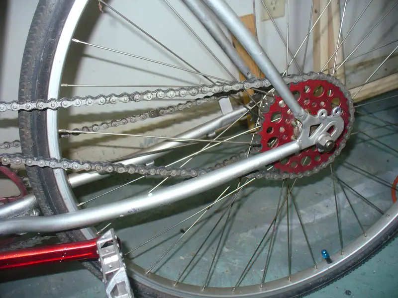

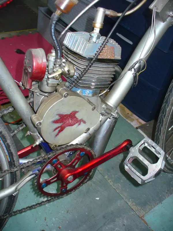

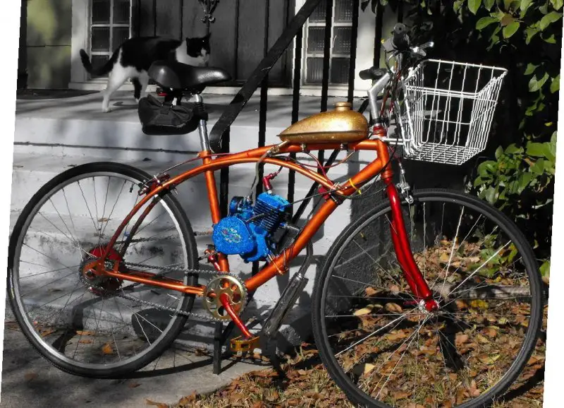

Well I'm interested in them theoretically, but it's sooo much harder to wrench as I get older. This "80cc" pictured has the original motor I bought from Bikeberry in '09, and still with 6mm jug rods . I shook it out the other day- I hadn't ridden it for at least 2 years. It ran poorly until I put fresh gas in- I shoulda emptied the tank, but it's going like new now. All that's not stock is the billet intake.
I'm toying with the idea of trying to ride it from Ormond Beach to Jacksonville- a short jaunt of about 90 miles, to pick up a jalopy I have there, but I'm not sure the motor, or me might make it.

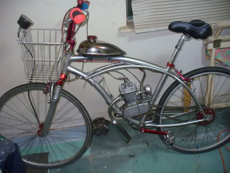

Seems like a longer stroke, so as most of the limit to these engines is the top rpm, I guessed that maybe was the case. I'm wondering how heavy they are? I've still got two gas bike builds, and ended up riding a 50cc more than the 80 anyway- it's not as fast or powerful, so maybe not the bike for 90 miles. As to gas- I'd plan to carry an extra liter in a small aluminum bottle, but there are many stations all along the way.

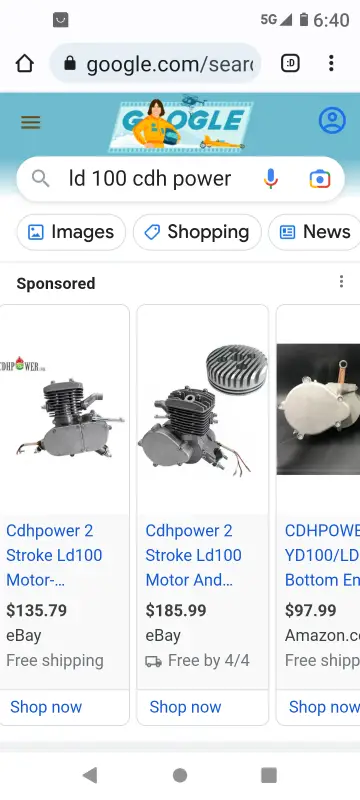

Doing a quick scan of specs where they care to give them, it now appears that I assumed wrong about the stroke- most are saying 38-40 across both the "80cc" and the "100" So I guess the piston bore is the big change, and they play around with different big heads, or heads with fins turned horizontal t lend an appearance of longer stroke.
The YD is a one piece cylinder and head and the LD is the 2 piece version
