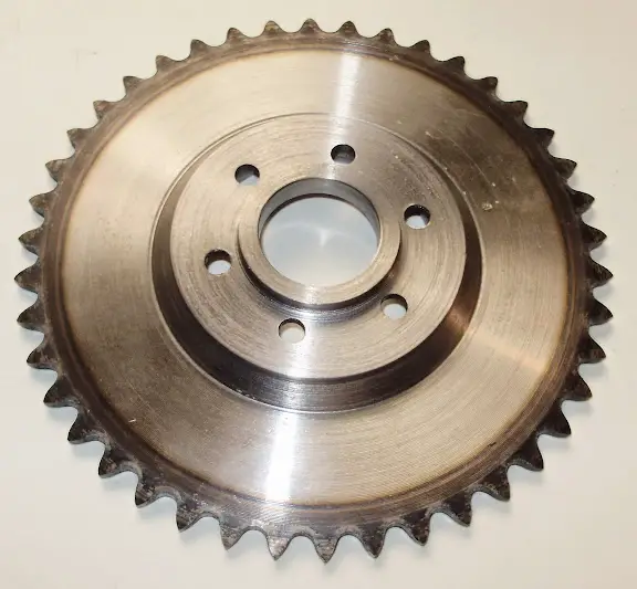

and here is the adapter sprocket I made to fit behind the brake rotor:

Really, really dig the sprocket adapter. CNC or manually made? I need to learn how to make sprockets. Well, is on the ever growing list. LOL, the more I learn, the more I learn what I need to know..... Ya know?

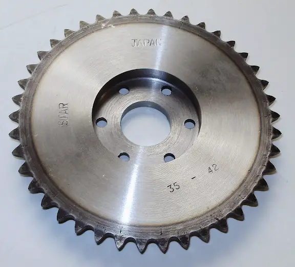

That sprocket was industrial Surplus that was modified.
It had a 10:1 taper bore that started @ 20mm The sprockets were high quality,made from 4340 & induction hardened on the teeth. And totally useless without further machine work.
I used manual machines to finish that part - the CNC's are all busy making money. The bolt pattern was just dialed X-Y from center with a little trig.
Here is the back side:
