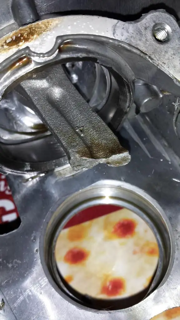

Long story short, looks kike the connecting rod cap came loose and broke one side of the rod off about the size of a cc and stripped the other bolt threads out and became completely detached. The piston stayed up in the TDC position in the cylinder with the rod still connected and before I took the side cover off, when you pulled on the recoil starter it made no noise whatsoever. It just felt like there was no compression at all (because there wasn't any when the piston is staying put lol).
The engine looks very new inside an I haven'y found any damage as of yet. The cam looks fine with virtually no wear, push rods fine and straight, engine oil was fine and full. The only damage so far I see is the broken rod and the oil slinger got a bit bent.
Much more to come when I remove the engine and split the case........def looks like a case of over revving the engine from brand new, really over revving it........

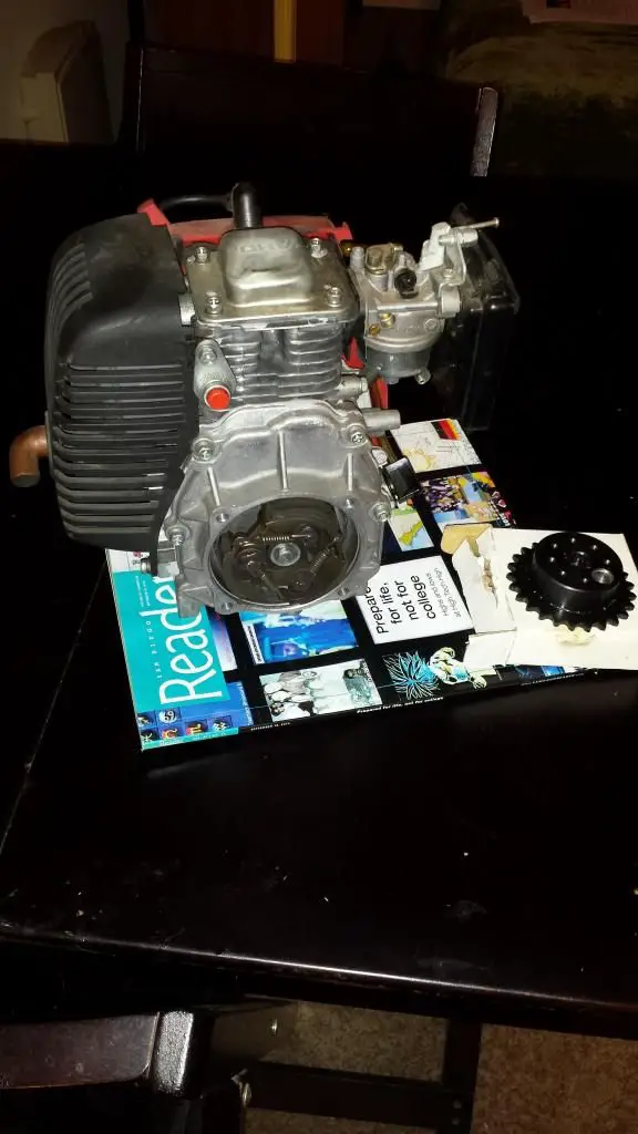

You're absolutely right mate, I'm a very nice guy.........but not that nice ;) The race bike only gets ridden on the streets around here by me...... don't want innocent people gettin hurt around here if monsta bike goes bad and reeks havoc on the community :D
Here's a pic of the loaner engine I'll install while I rebuild her engine......

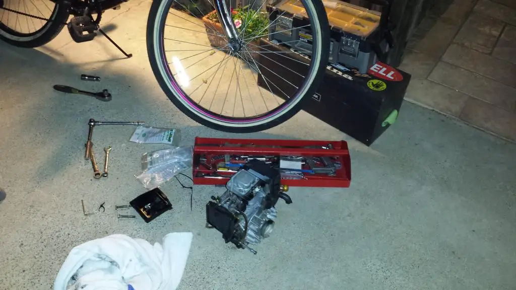

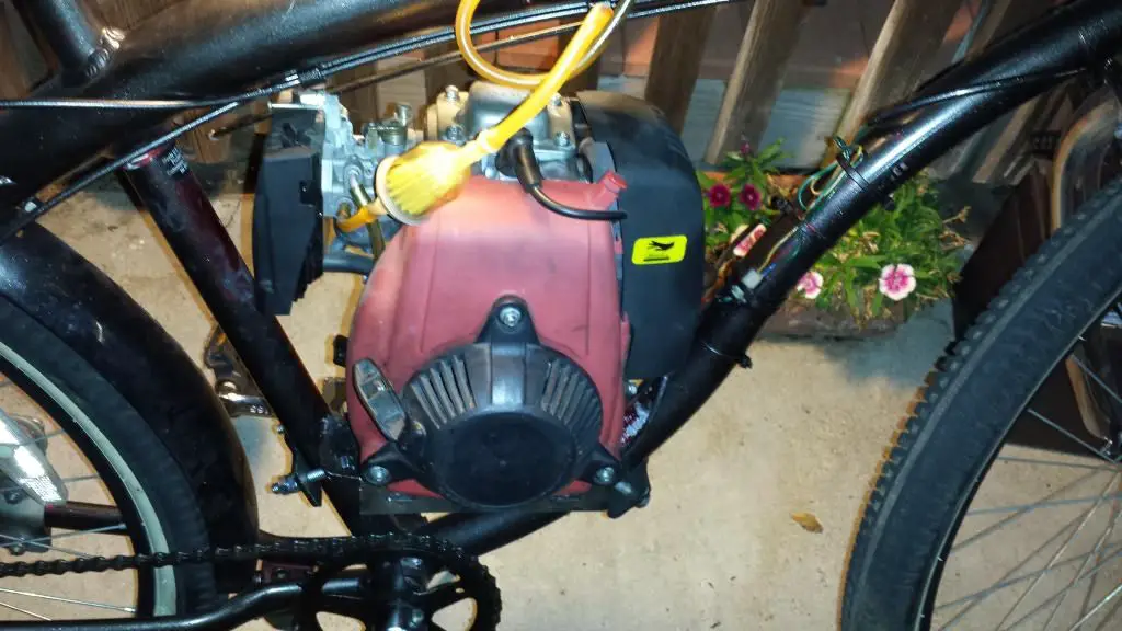

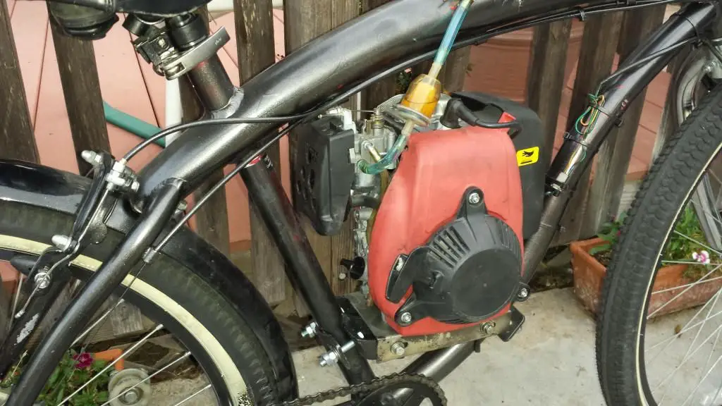

Here it is a couple months later and I finally got a chance to work on her bike again.....just got the donor engine installed and now have to dial everything in.
A couple pics....
More to come later...

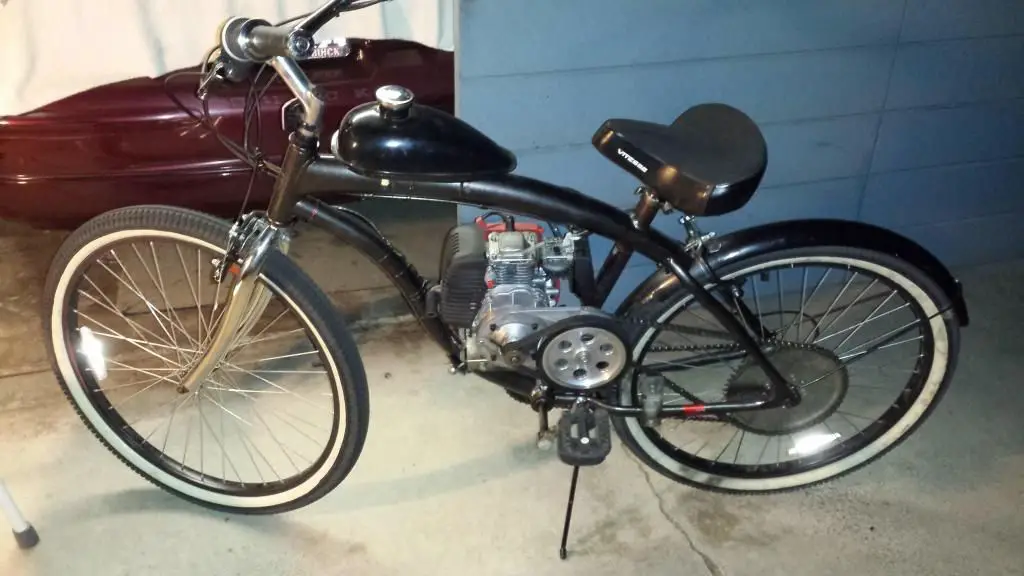

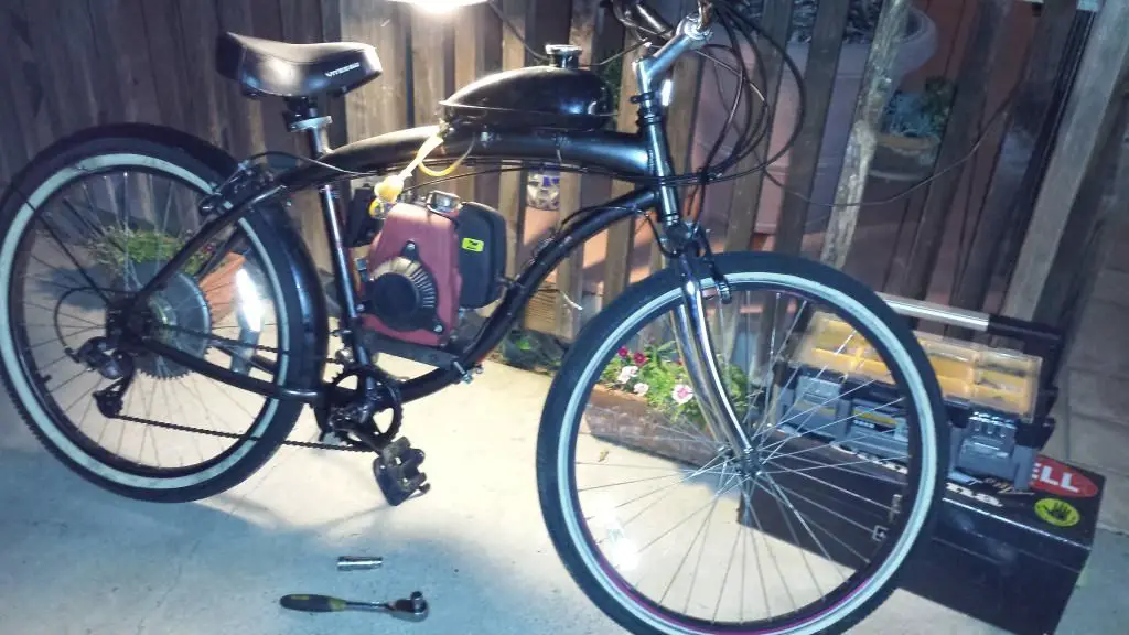

Got the bike up and running today, no issues....runs great! All it needs now is a little black paint on the engine shroud and the top tube converted to a fuel tank (toss the peanut). It did have a chrome exhaust when she got it. One good burn on the leg and she opted for the quiet stocker.
Today's pics.....

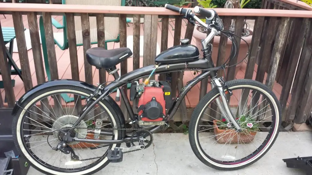

I rode Katrina's bike to work today and it ran just fine. She was really excited when she showed up to work and her bike was there and running again.
We got off at 9:30 PM and she had to take it for a spin around the parking lot...she was stoked! It's got really good take-off with the 4G and the rather large rear sprocket, no need to pedal on the starts.
I've got to repair the 4G black plastic tranny cover but other than that it's running great.

Thanks Nunya.....I think you're right. This is a pic of her after riding to work yesterday. Finally I think she's happy with a MAB.....who wouldn't be? She said the ride was cold.....65 degrees?

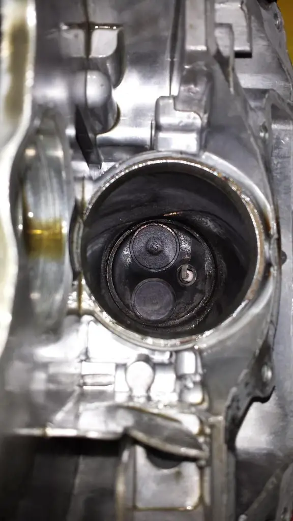

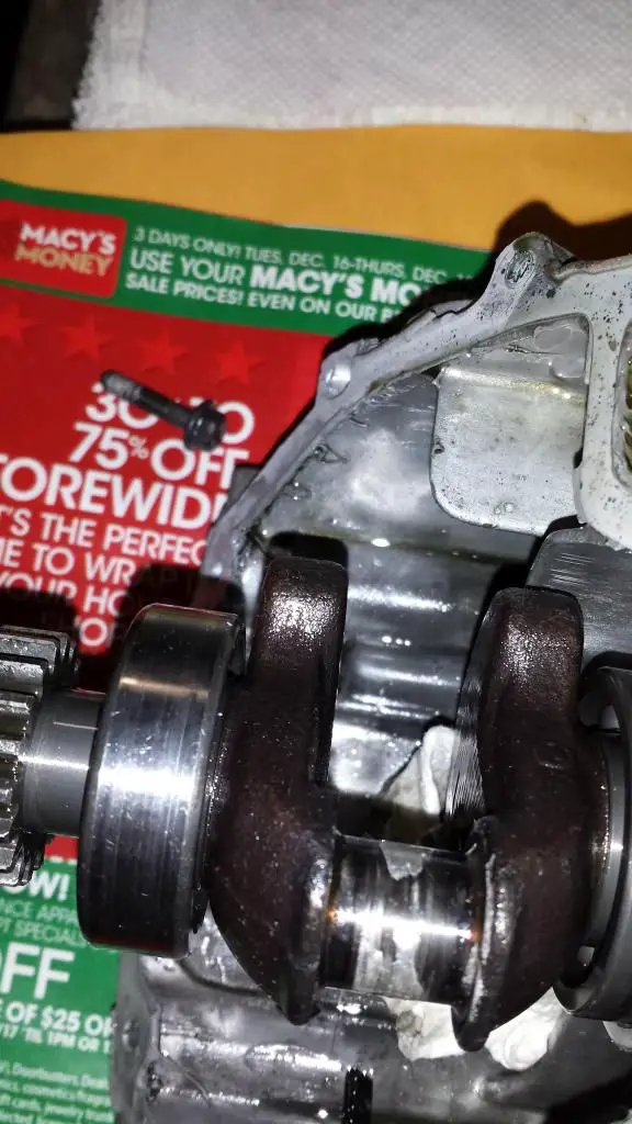

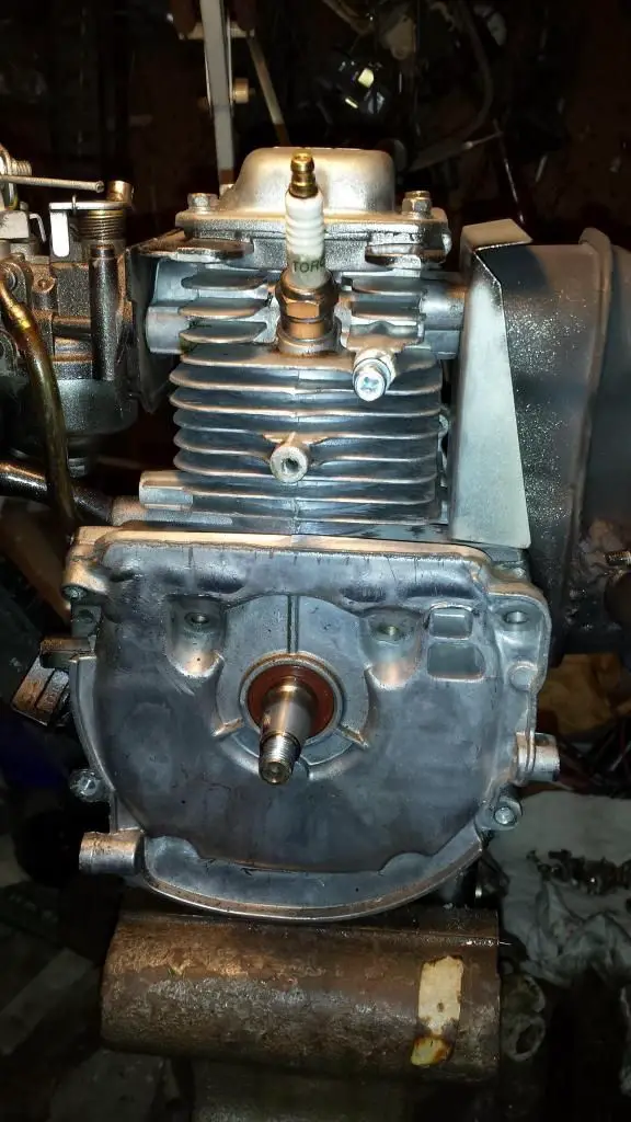

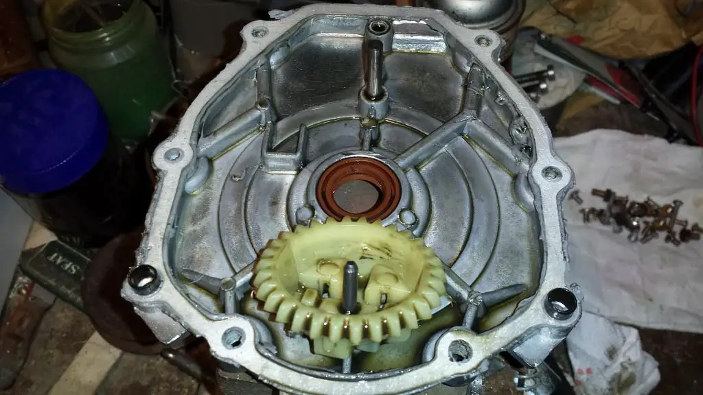

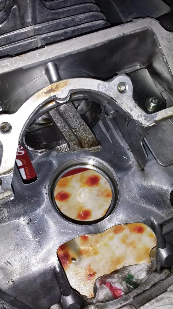

Alrighty then, here's the updates to Katrina's bike and what happened to her engine.
I repaired the 4G tranny cover with aluminum straps riveted and epoxied to the cover where the 3 mounting screws are located. I didn't take pics of the repair.

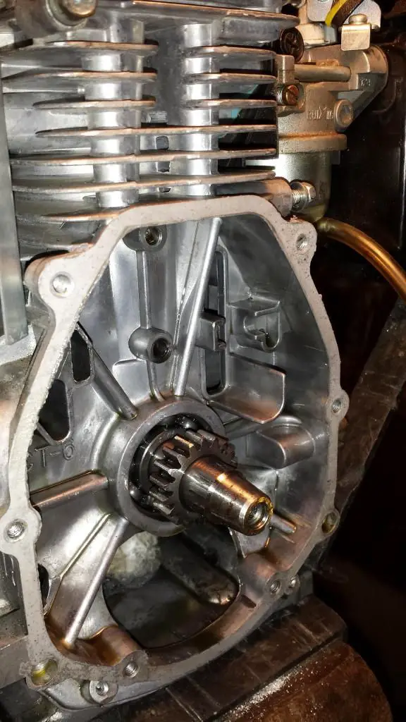

Tonight I finally got around to splitting the crankcase of this failed Huasheng and things don't look nearly as bad as you would expect. All in all it is going to be a really cheap repair as all that is needed to be replaced is the connecting rod and the cap. Less than $20 in parts.
I'm uploading the pics now for show-n-tell......stay tuned...
scotto-
Custom 4-Stroke Bike Builder
Jun 3, 2010
6,505
25
38
Ridin' inSane Diego, CA.
I'm still trying to upload the pics from my phone and things aren't going like they normally do....technical difficulties I guess? Still working on it.....
scratg .spr.
scotto-
Jun 3, 2010
6,505
25
38

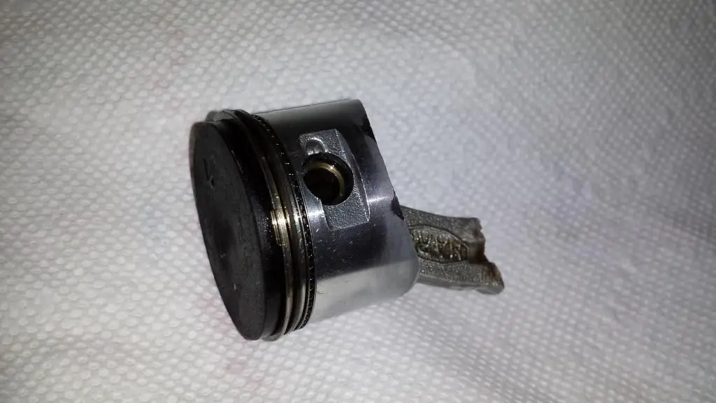

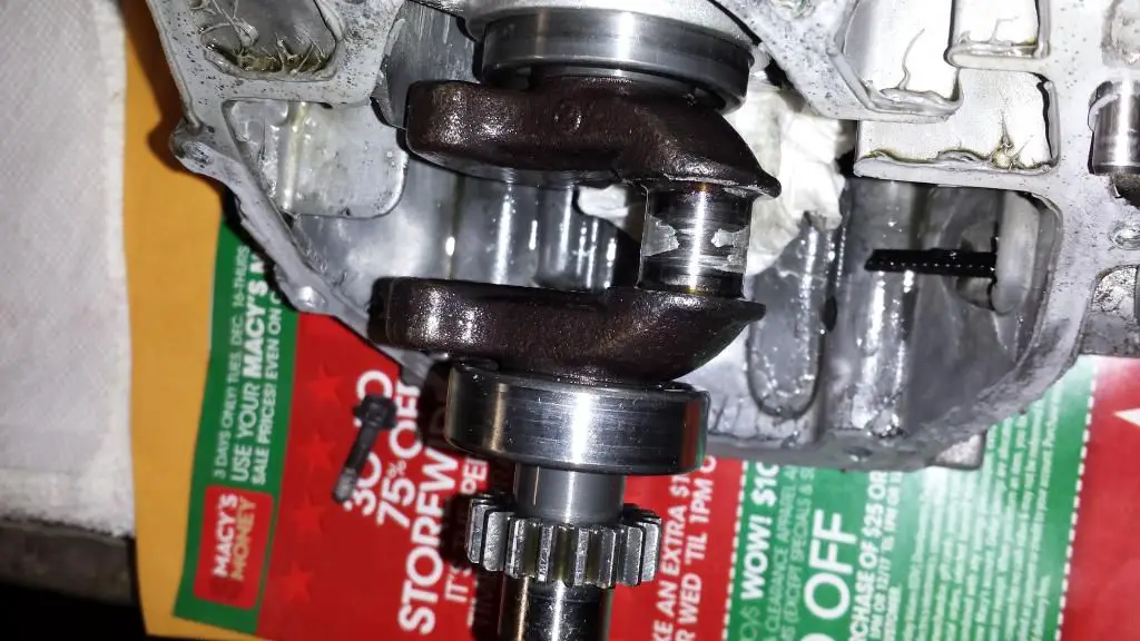

the rest of the pics...
aluminum fused to the crank and threads in con-rod cap bolt
snap!
piston & rings unscathed...
cylinder and combustion chamber are just fine
The damage was very minimal for this type of failure......a new rod and cap will be all that's needed to make this engine good as new. A very cheap fix!
