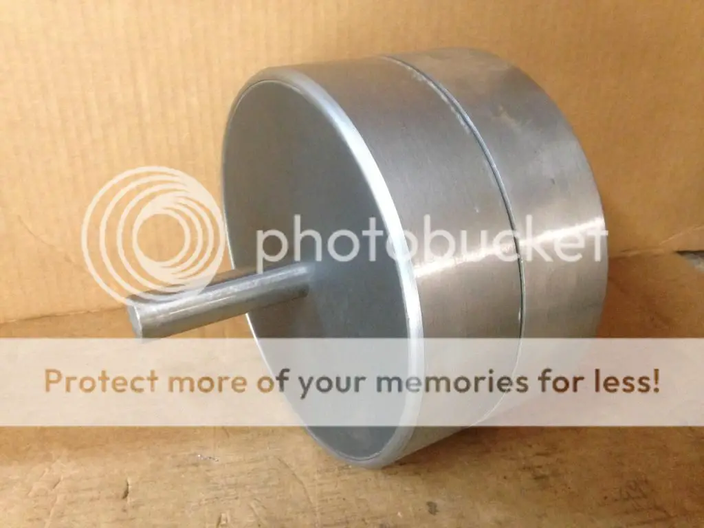

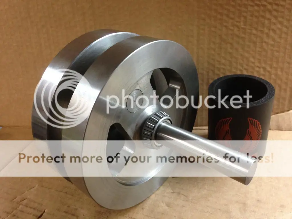

V-Twin, with roller bearings and sealed crank case. I have no blue prints just figuring it out as I go. Here are some pictures of what I have built so far. This is the crankshaft. It has 8" flywheels, with 1" crank and rod pins.

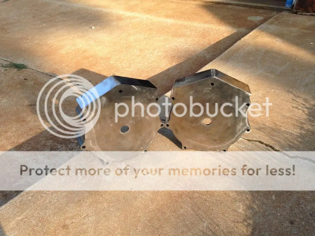

This is what the crankcase looks like after the parts are welded and ground down.

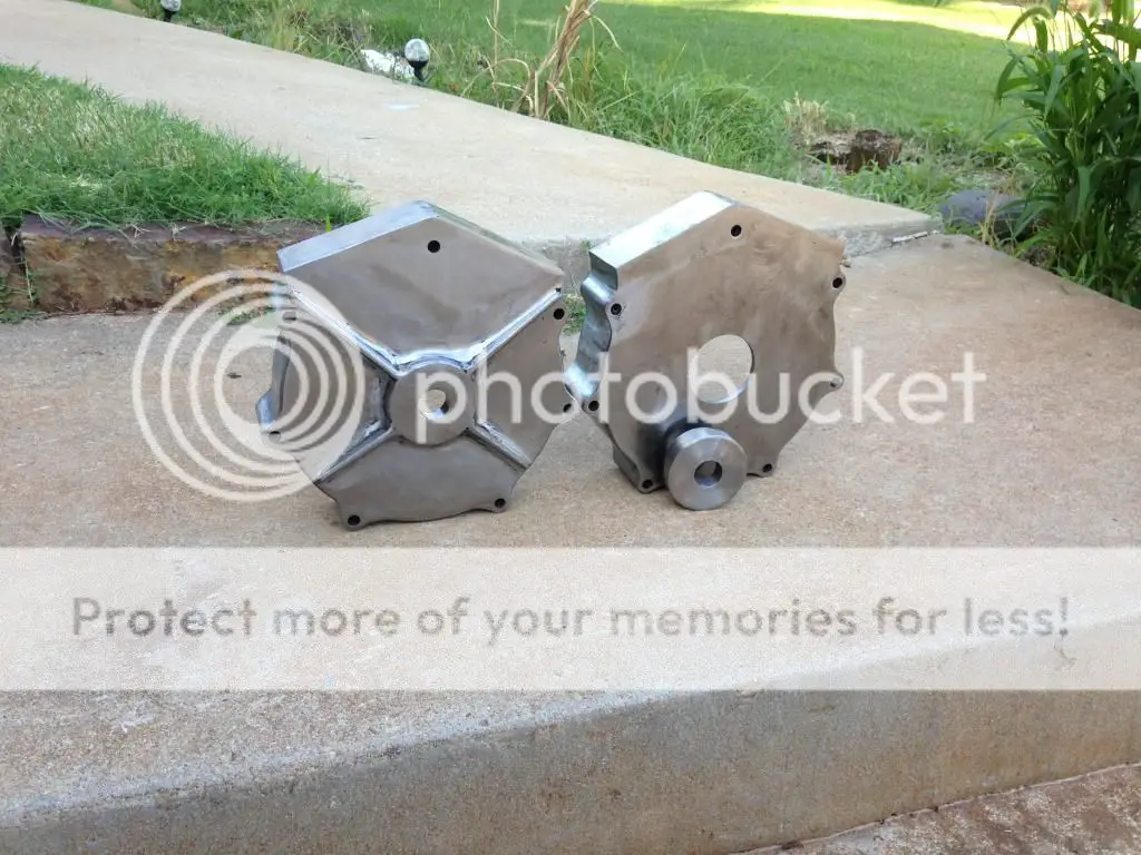

The x brace and bosses were added here.

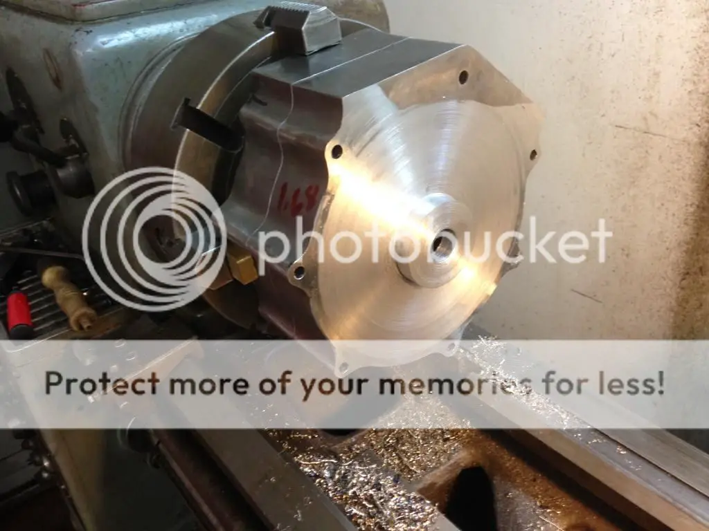

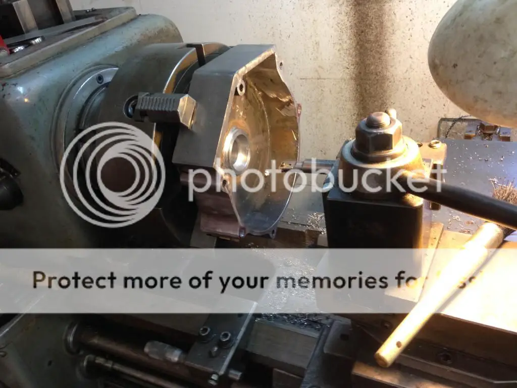

This shows the bearing boss being bored. After boring the other half was bolted to it and bored to align the bearing fits.

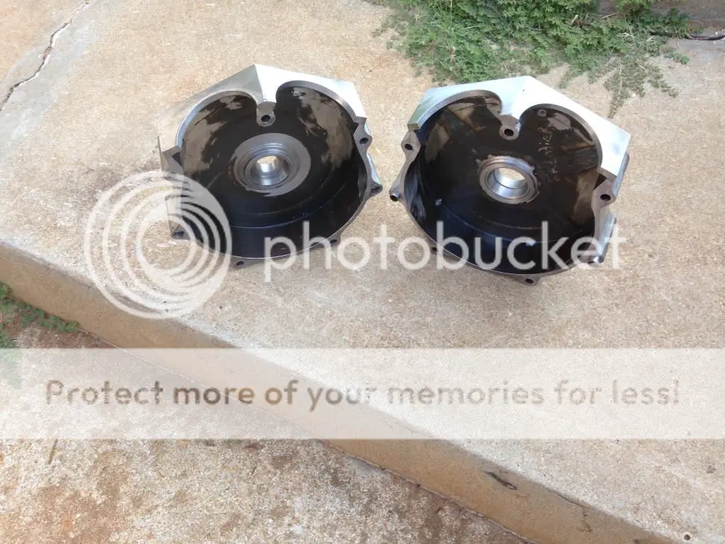

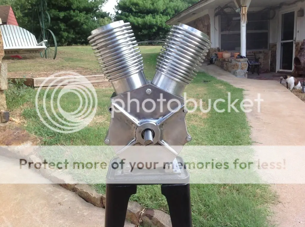

inside view of the crank cases after the cylinder mounting holes were bored.

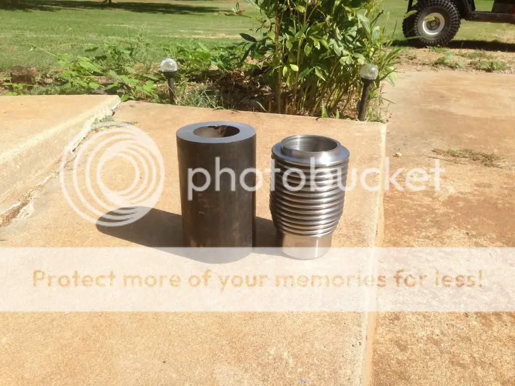

The Cylinder before and after. A cast iron sleeve was pressed into these steel jugs.

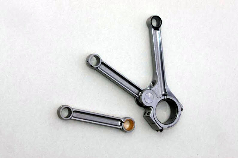

To explain the master and slave rod:
Knife and fork:
Side by side:
