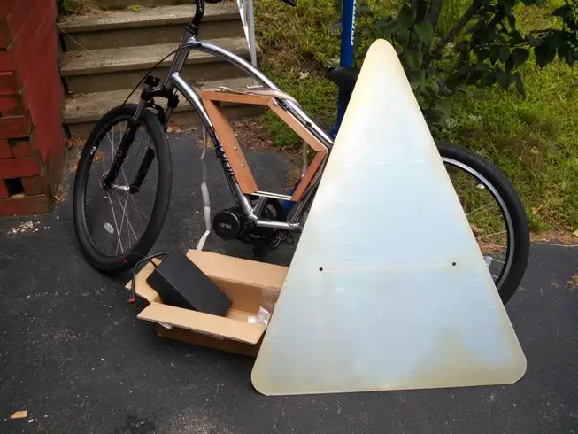

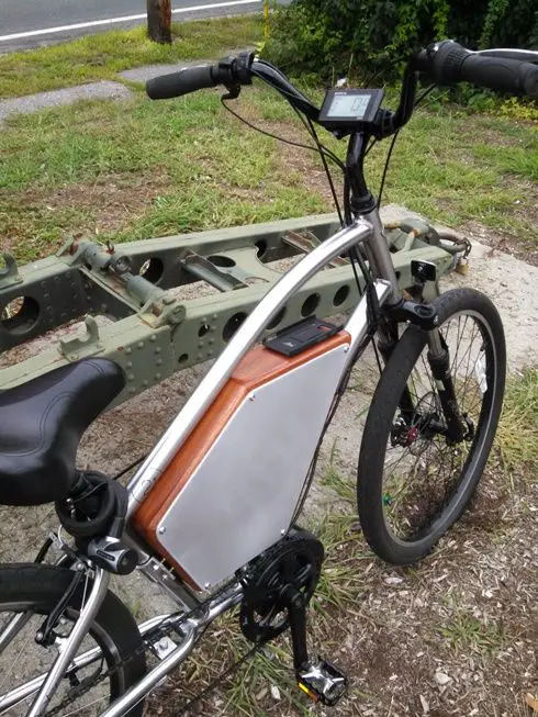

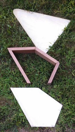

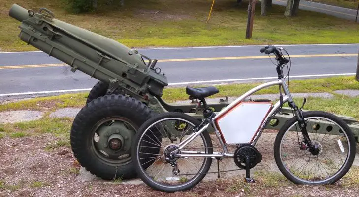

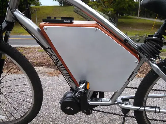

Here's my Electra Townie that I recently made electric
Bafang BBS02 48V 750 mid drive motor and 15.2 Ah battery 18650-20R
http://em3ev.com/store/index.php?route=product/product&path=35&product_id=134
It works just as planned, up to 9 levels of pedal assist and 7 gears in back keep it moving fast over and up any road. I've been riding it for a little over a week and it's great. I get 33-35 miles from a full charge and I expect that will go up as I get more used to using the gears to increase efficiency. The motor will keep me moving good over most terrain in top (7th) gear so at first I forgot about using the gears to climb with less strain/drain on the battery. The motor works most efficiently at the higher rmp range so going up hills is a breeze using the right gears.
I added a new front wheel to use Avid BB7 disc brake. Only thing I need now is a nice double kickstand and probably getting Schawalbe Fat Frank tires.
