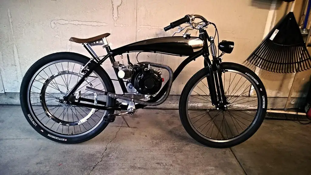

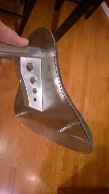

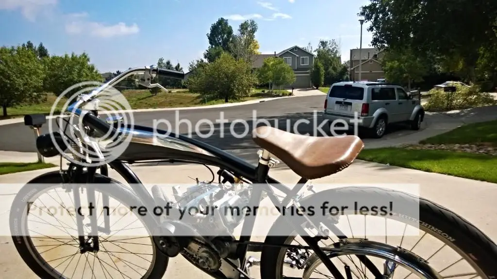

Well okay, after some significant miles on my BTR bike my hiney was not feeling it, heck it was not feeling anything for that matter because it was numb.
I looked into a wider cruiser bike seat but after a long search what was available simply did not look right on this bike. They all looked too blocky on the bike.
Anyway, I then started looking at bobber style seats for actual motorcycles.

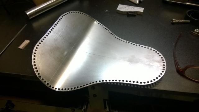

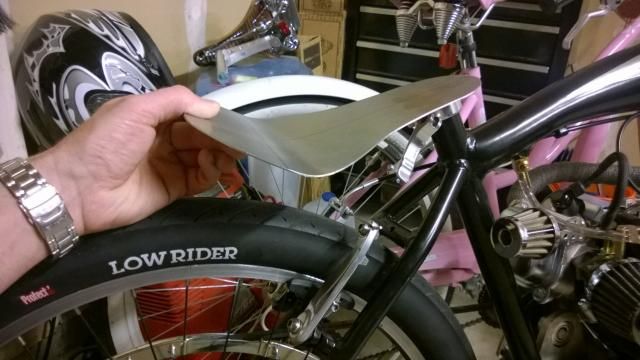

I found a few but the prices were way too high. I looked at the construction of them and it seemed not too complicated.

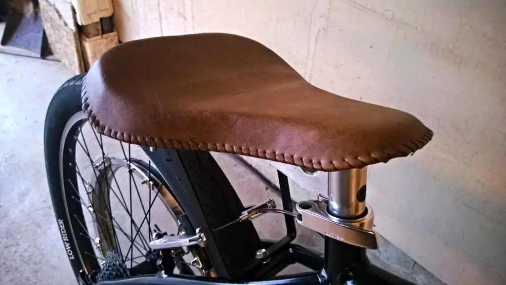

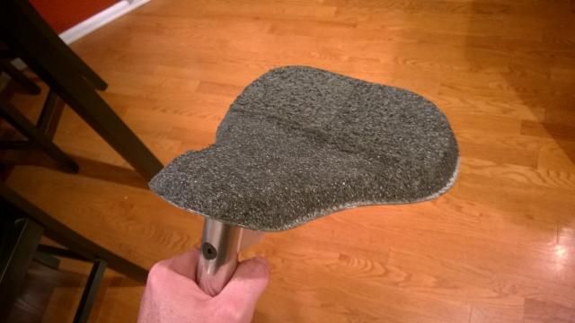

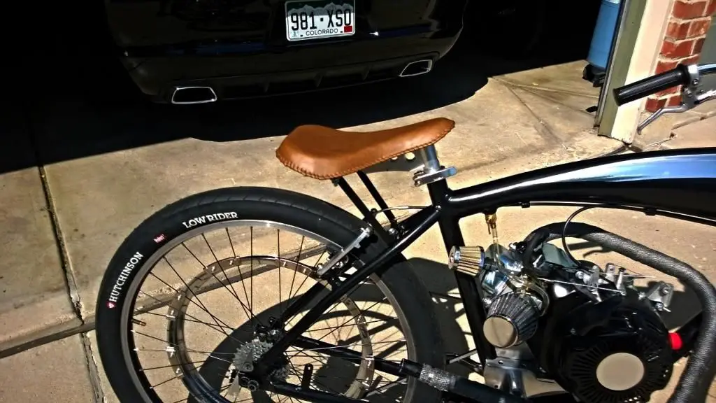

So off I went to Home Depot to pick up some 16 gauge steel sheet metal and to a fabric store to get some vinyl covering.
I had the seat post and brace from the previous configuration so aside from that and my time, this only set me back $13.00.
Pictures tell it better so here you go.
