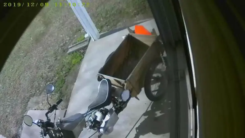

The trike vanished from my porch this morning. Figured I'd post here in the super unlikely even someone see's or buys it and comes here looking for help.
Most recent picture since I never took any after the ones put on this thread other than the ones my camera takes when turned on sadly it was not on today since it hogs the wifi.
