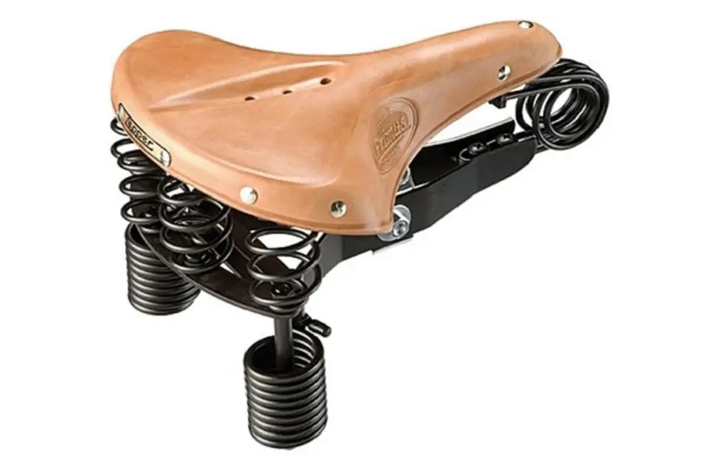

So I bought a motor mount and wide crank from Phantom Bikes ( thanks John ) and a used Phantom exhaust from a friendly member. The gas tank and 1" billet clamp came from ebay and the attachment arms are just round stock steel from Ace Hwd. I cut the round stock to length and heated it to bright orange with a MAPP gas torch then using a 5 lb hammer pounded the ends flat, and gave it a bit of a curve to match the curve of the tank. I also internally vented the tank and ran the vent down the R seat stay. The hole in the gas cap vent got pluged with JB Weld. I didnt want raw gas squirting up by backside with every bump. Tends to burn and chafe. :eek: After DAYS and nights of searching I finally found an eBay Germany seller who would ship a Lepper Primus saddle to America. Its BEAUTIFUL and OH SO MANY SPRINGS HAHahaah. Its safely tucked away but will get a pic of it on the bike this weekend. azbill helped me again getting a HS 49cc again ( thanks Bill ) and I have a stock spare carb at AGK now being boared out to the high performance job.
