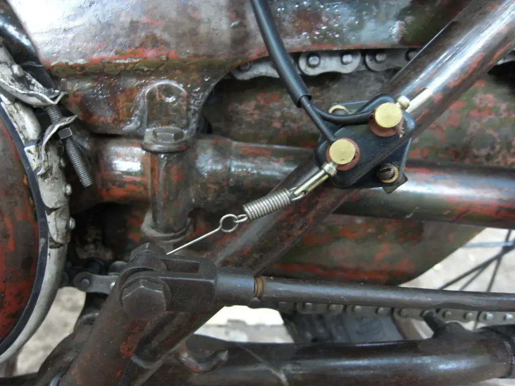

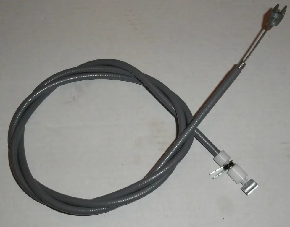

Here's an option that I was considering. Using a simple nylon dowels and connectors. Someone on Ebay sells them. I am not affiliated or used the product. I guess Cushman and minibikes used this method.
in the cable brake like switch Cushman Simplex scooter | eBay
Here's a picture I gleaned from the Internet with an installation:
http://motorbicycling.com/attachment.php?attachmentid=44136&stc=1&d=1327083413
I also considered using a Royal Enfield switch:
http://motorbicycling.com/attachment.php?attachmentid=44137&stc=1&d=1327083694
Good Luck,
Chris
AKA: BigBlue

the cushman dosent look very reliable , an the one on the enfeild is a older version of the link I sent . if it was my decision I would use the enfeild design it works every time . brake lights , you want to work every time . .trk
