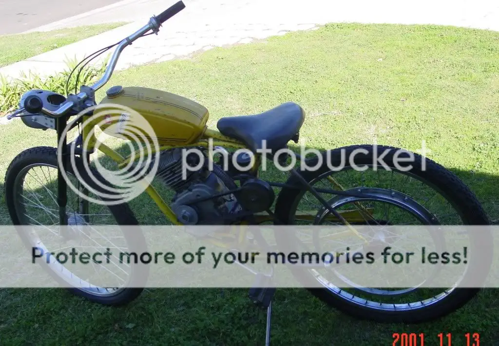

Well here's another Briggs and Stratton bike. This one was built by a friend of mine a couple of years ago. He had one of those cheap repro springer forks from ebay. He tried to get a little air over a speed bump in front of his house and the forks collapsed sending him over the bars and breaking his arm. While he healed up I took the bike home and installed a good solid moped front fork with cool headlight/speedo combo, added a more attractive fuel tank, re-did all the cables, and smoothed out a lot of ugly welded on brackets and mounts. He never felt comfortable on it since his crash so it just sat in his garage until I offered him a handful of cash. Now it's mine but still in the pre-assembly stage. Plan on finishing it up after a few more projects take priority. Hope you enjoy the photos. Another good use of old moped parts.
These motors are amazingly reliable and easy to start. I just pull the compression release lever, pedal a few strokes while sitting on the seat, let the lever out and it immediately comes to life. The automatic clutch has a one-way bearing in it so all forward motion turns the motor, unless, of course, it's running in which case it just out runs the bearing. Very nice set up. Have been using them for years with not even a hint of wear or problem.

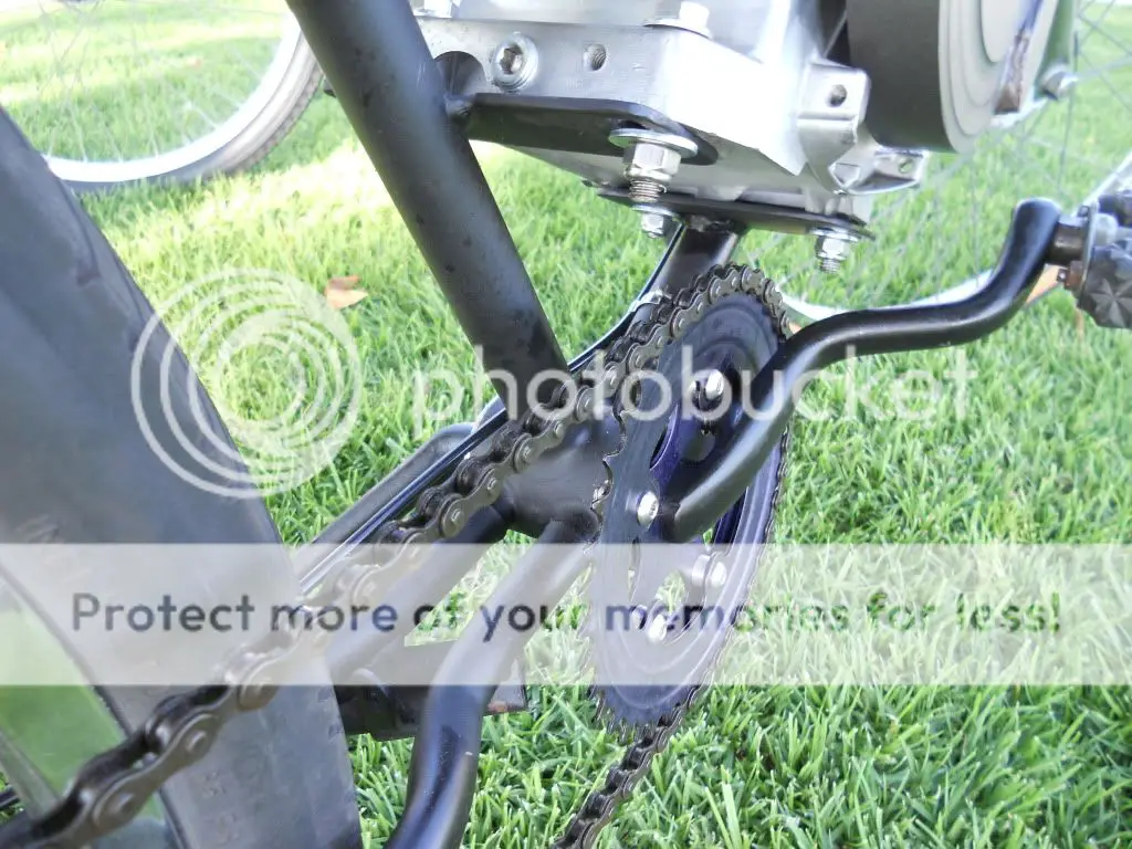

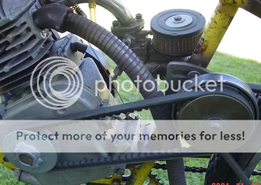

msrfan, a couple of questions. What is brand/manufacturer of the clutch. Does it come with the pulley mounted to it. What is the brand/manufacturer of the engine mounted pulley. Thirdly, how do you tighten the belts? I know I must be missing something, like another plate, but it looks like if you adjusted the pulley/clutch to tighten the engine to clutch belt, it would loosen the clutch to wheel belt and vice versa.
I think the rear tightener shows in the last pic along w/the sliding the motor for the front belt,I am just thinking ,,a height adjustable cent clutch braket on the seat post w/a top pivot bolt and a lower lock bolt for doing both adjustments at once
The clutch is made by 3rd Millenium Energy, who said they're not making any more. So the next one I bought is a late Whizzer item. These auto clutches have both pulleys made on them and spin on a sprag bearing so you can pedal start. It is mounted on a pivoting plate and the motor mounting holes are slotted. The adjustments show in the last photo. This bike was made from an instruction book I provided to my friend, but he made the engine mounting and clutch adjustments a little different than me. I normally mount the motor solid and have up and down plus sideways pulley adjustments built into the clutch mount. A spring pulls up and the clutch self centers, tightening both belts at once.
