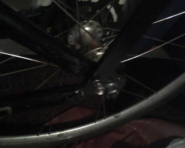

dax CX left side strap bolt 1 I used a couple bolts from the kit and drilled new holes and threaded the holes for the bolts.
The drive side uses a threaded hole, the metric bolt, a locking nut, strap, washer, then 2 locknuts. I have to make sure it does not unthread because it will knock out my top pedal gear if it blocks the chain.
