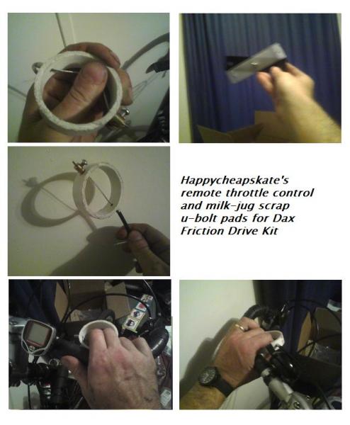

HC remote throttle cable. It's a piece of PVC tubing cut down to about 1/2". It has a tiny hole for the cable to run through (will wear a little a
It worked really good. I made sure the cable was very well lubricated, and put some tape on the cable for finger padding. I zip tied the control to the handlebars and it was very comfortable to use.
