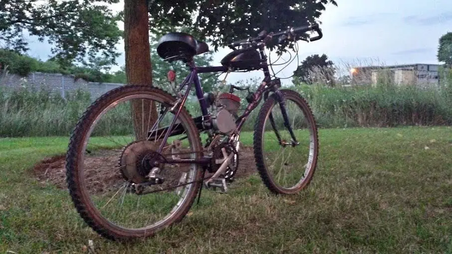

Nice bike.
That bike has the same geometry are a Surley.
A 2-stroke will fit, a slant head 66cc anyway, you just need to modify yourself an angled intake pipe so the carb is out of the way as a Z pipe won't work.
I just cut up 2 intakes to make 1.
I jackshafted it to preserve the disc brake and let the engine use the bikes gears.
The front mount, dual pull brake lever and shift kit are from SickBikeParts.com
That will set ya back ~$250 but man what a ride ;-}

Nice bike.
Certainly looks like a Surly in general design, if not in quality of some components. Miele claims that these as "Canadian Designed" (Manufactured in Mexico) and generally sold through independent smaller shops. I guess following the 'Surly' design in terms of layout and dimensions is a good thing?
As a few photos showed above - i've already mucked around with engine spacing. It looks like a relatively tight package overall in the small frame.
I did order an alternative offset intake manifold pipe, if just to have it in hand and to understand any clearance issues as i proceed with engine in frame install. Although i ordered the full Skyhawk kit, i might not be using the supplied carburetor .. i'm electing to keep all parts options open at this time.
I considered the jack-shaft approach in this second build - but in the end, i decided that a refined direct chain drive is fine for this one, also. Just too much complexity, for a MAB that is not going to likely see anything more than occasional recreational, off-road use at a relatively low-speed.
I do like your ride also - it is definitely a refined package, to take some inspiration from!
