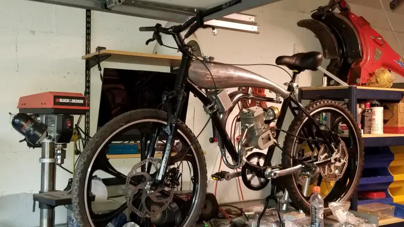

Got a few more parts in past week, and coming down to final configuration of rear rack assemby .. things will be a lot tighter, integrated than in photo. Lots of custom brackets will need to be made up.
