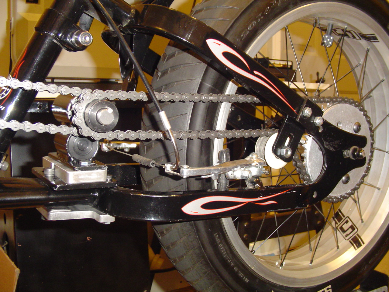

well. as far as the rear tire....
you may need to build an offset mounting plate alike the ones used for the OCC stingray builds.
that got any gears turning?

I've built several bikes with a 3" rear tire. It's gonna be dificult to do it on your bike if you wanna keep the wide tire.
You will have to offset the rear sprocket & the engine about 1/2" to the left (which will put the engine too close to the left pedal), or build a jackshaft like Taco did on his build off stingray. & that is all only IF you can actually fit a engine in that frame???

I have built several chopper bikes on a couple different style chopper frames, but have never seen one exactly like that. If there is room for the motor, you will have to offset it to the left to clear the rear tire, but that will cause you clearance problems with your left pedal. I notice you do have plenty of room behind the seat post tube for a jackshaft. That way you could center your motor, and get your offset with the jackshaft. Good luck, looks like a fun project.

I'm very new at all of this and don't fully understand the "jackshaft" or how it works. What about an extra wide crank set to clear the motor? Do they even make crank sets that wide? I wish this bike was in better hands right about now. I have no doubt that a lot of you guys could do a real bang up job at this build and make it work. I only have 4 1/2 inches from the chain ring to the inside of the crank on the opposite side. No way thats going to be enough room to mount a motor even if it wasn't offest to one side.
