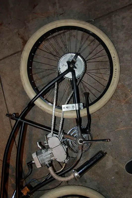

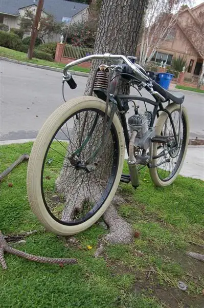

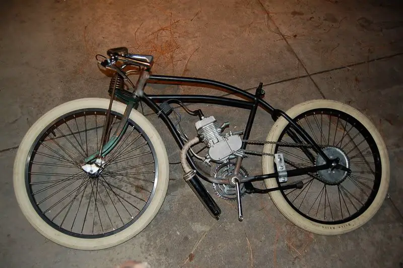

ill start with this spiegel airman (monark) frame i found at a garage sale for 8 dollars
blast and paint black, add a 50s higgins beehive springer, new wheels, some mid 60s murray bars flipped upside down, a higgins spaceliner crank and creme felt quick bricks and you have this
then install the infamous "80" cc
and run in to a ton of problems that a first time builder does!
hopefully to be finished before the deadline:

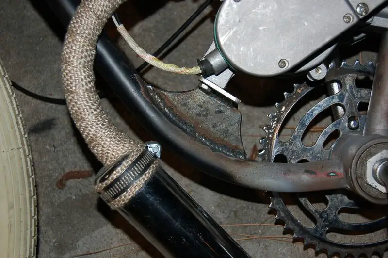

custom tank in frame
lower motor mount
heat wrapped pipe

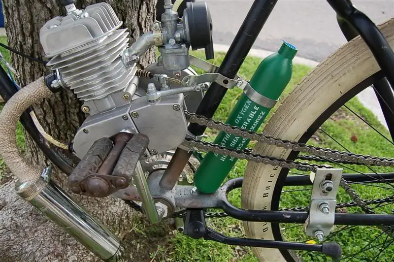

boost bottle painted to match on seat post tube
