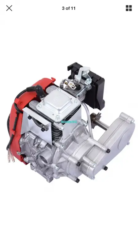

Will this wheel work with this engine?

Not the best transmission 4G trans would be better, better yet 7G . All them little 4 strokes are the same size just different transmissions, and transmissions hang off to the side so any one should fit.
The wheel would work if the sprocket is right, needs to be the same 1/2" pitch chain, not #35 chain..........Curt
