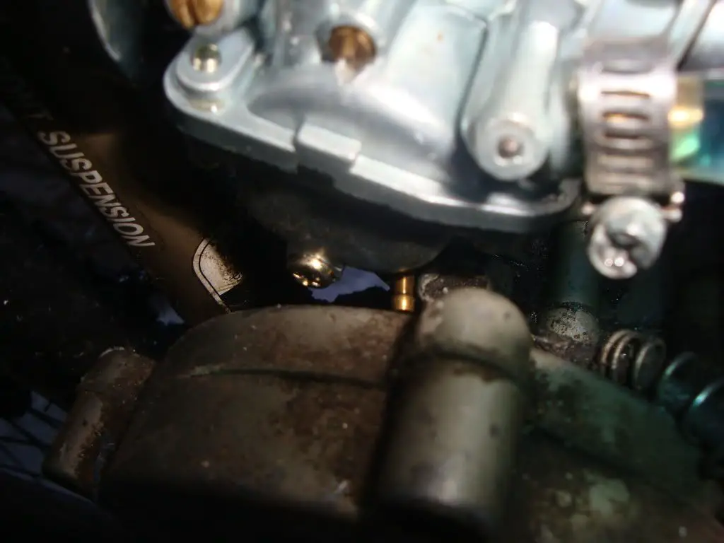

got mine installed, and i must add clearance is a huge problem for me. for one, its barley onto the billet intake (but its on enough not to suck any air) the reason being the float bowl drain iece on the bottom of the bowl now hits the stancion tube. i can live with it.
number two, i had to cut the rubber intake down to nothing but an o ring and smoosh the filter upwards.
pictures here, (it works great with the SBP pipe. Low end galore)
