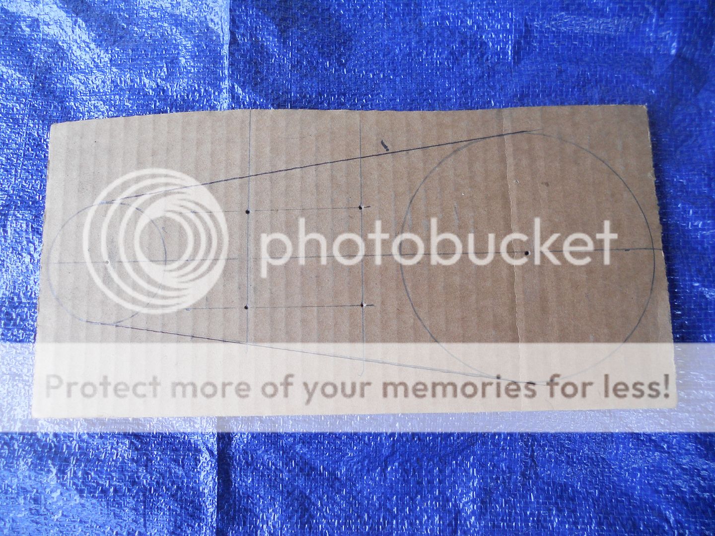

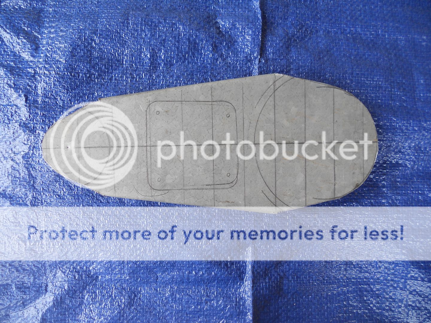

That's when I got an idea for a belt guide narrow enough and the right shape to contain both sides of the belt. I started with an actual size drawing of my pulley locations and the guard mounting bosses.

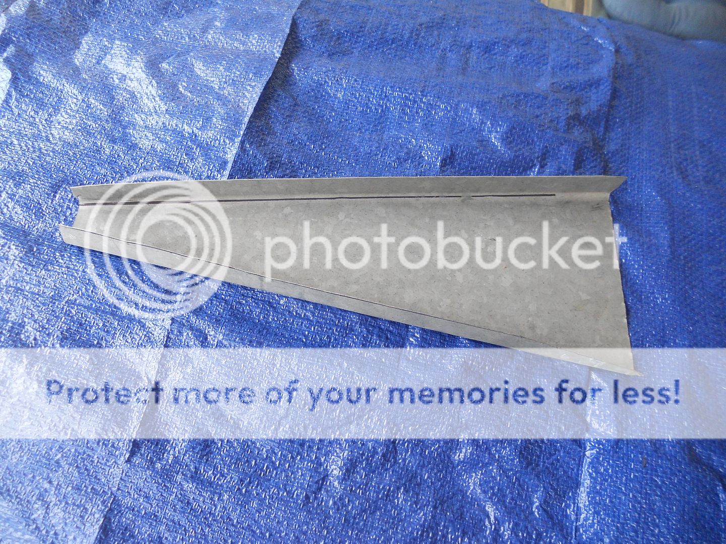

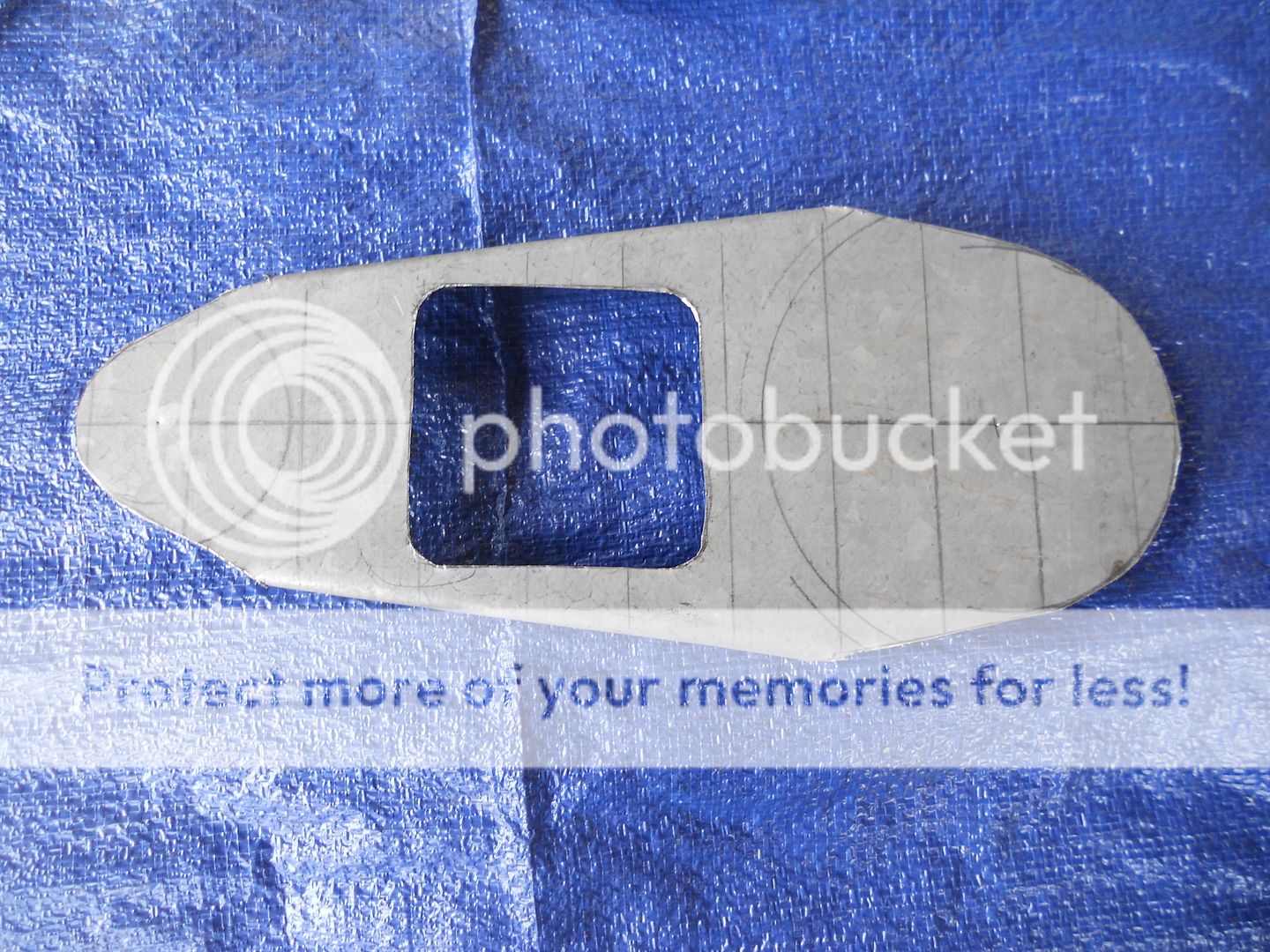

Wanting something that doesn't show, I realized there's very little room to work with. I chose thin gauge sheet metal I had laying around (about .030"), and bent two edges over at the angle of my belt.

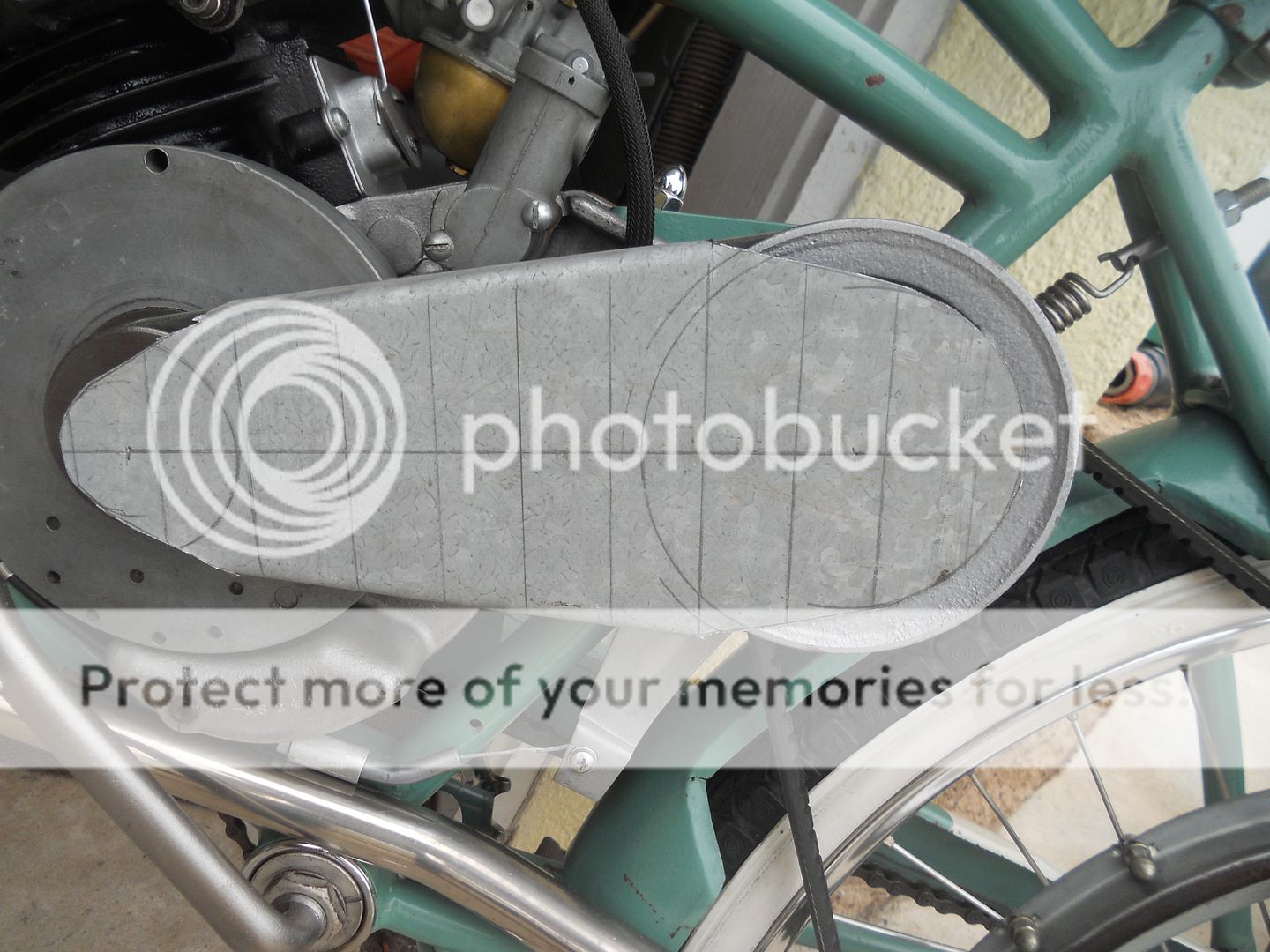

Then I fit it onto the pulleys and cut it to size, marking where the mounting holes are.

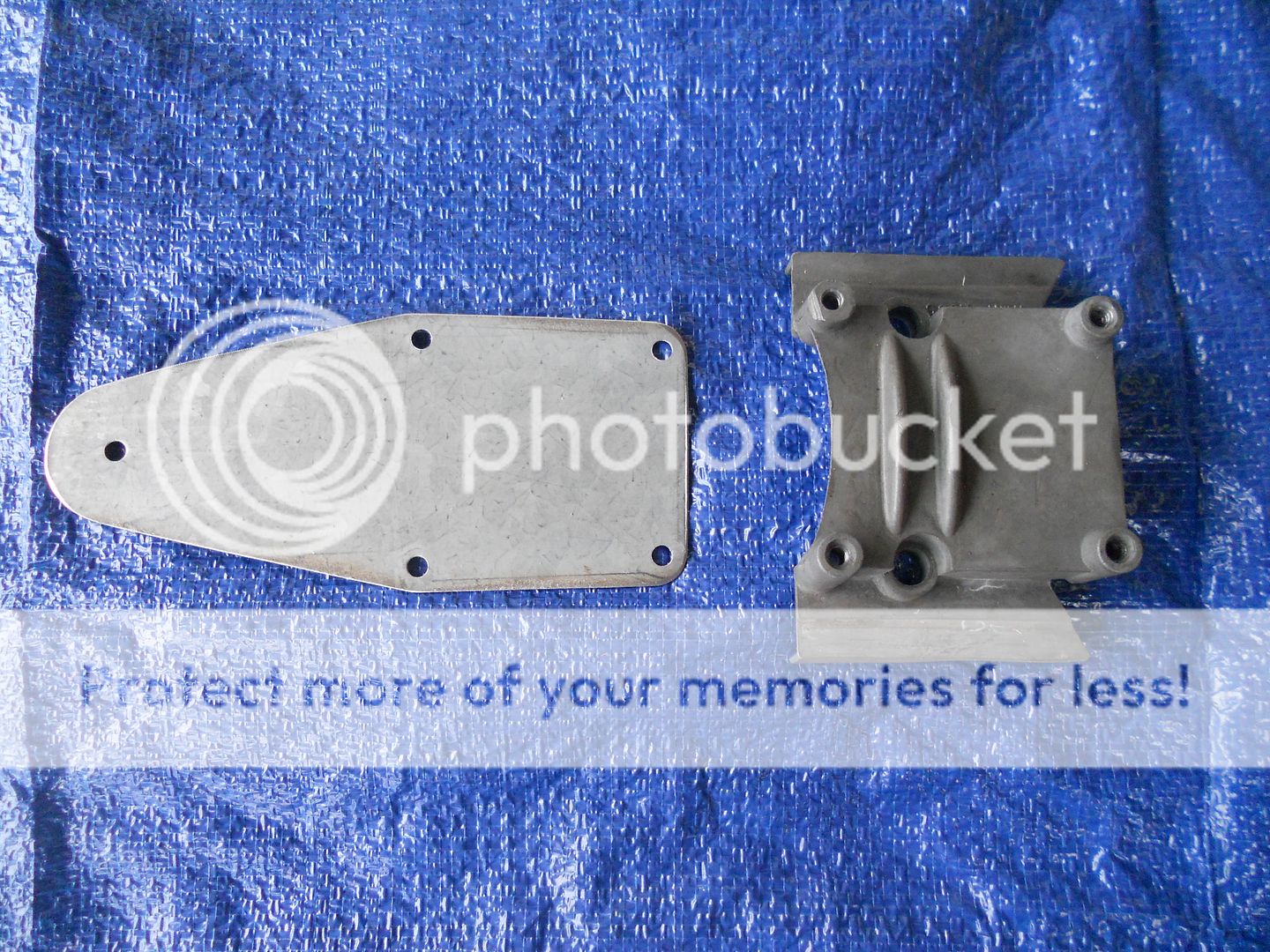

Before I started on this project, I installed two stationary guides that did almost what I wanted. Their problem is that when the clutch it disengaged, the belt is pushed into the bottom guide making it grab again.

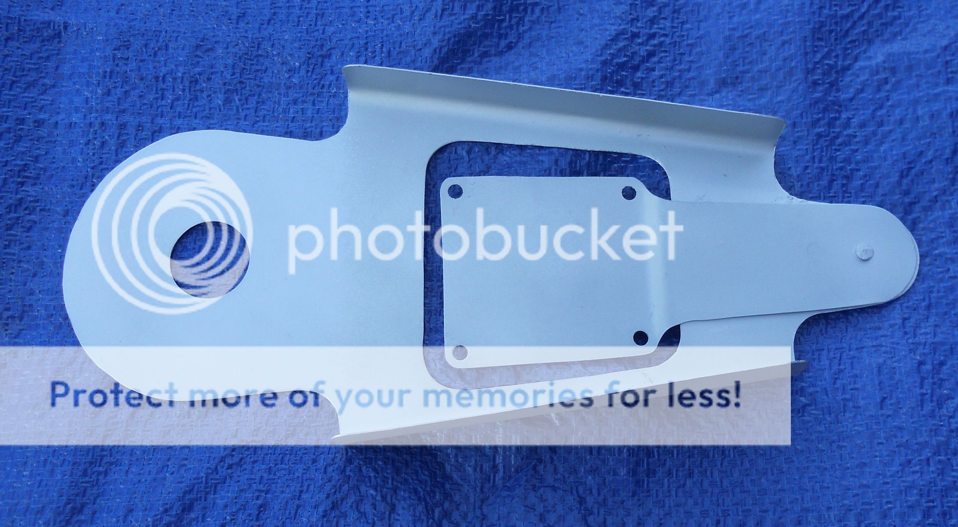

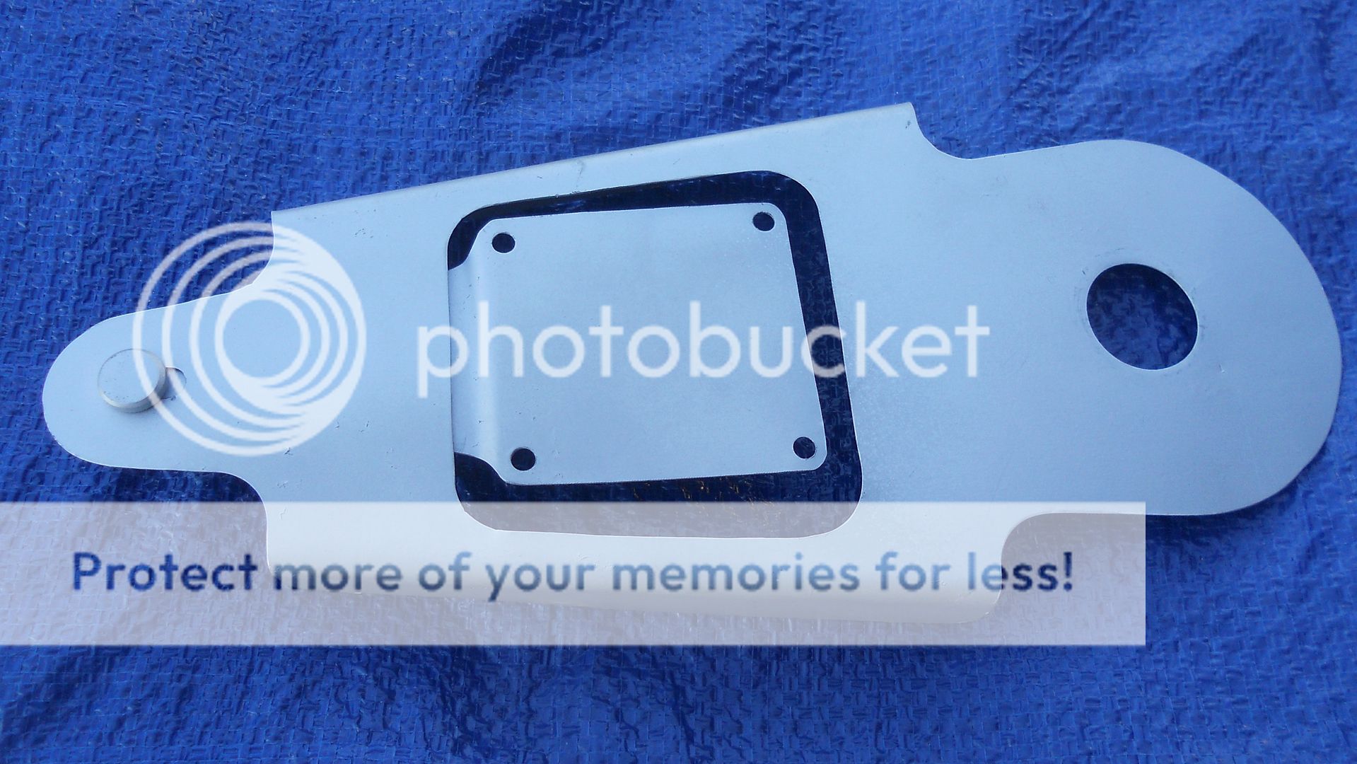

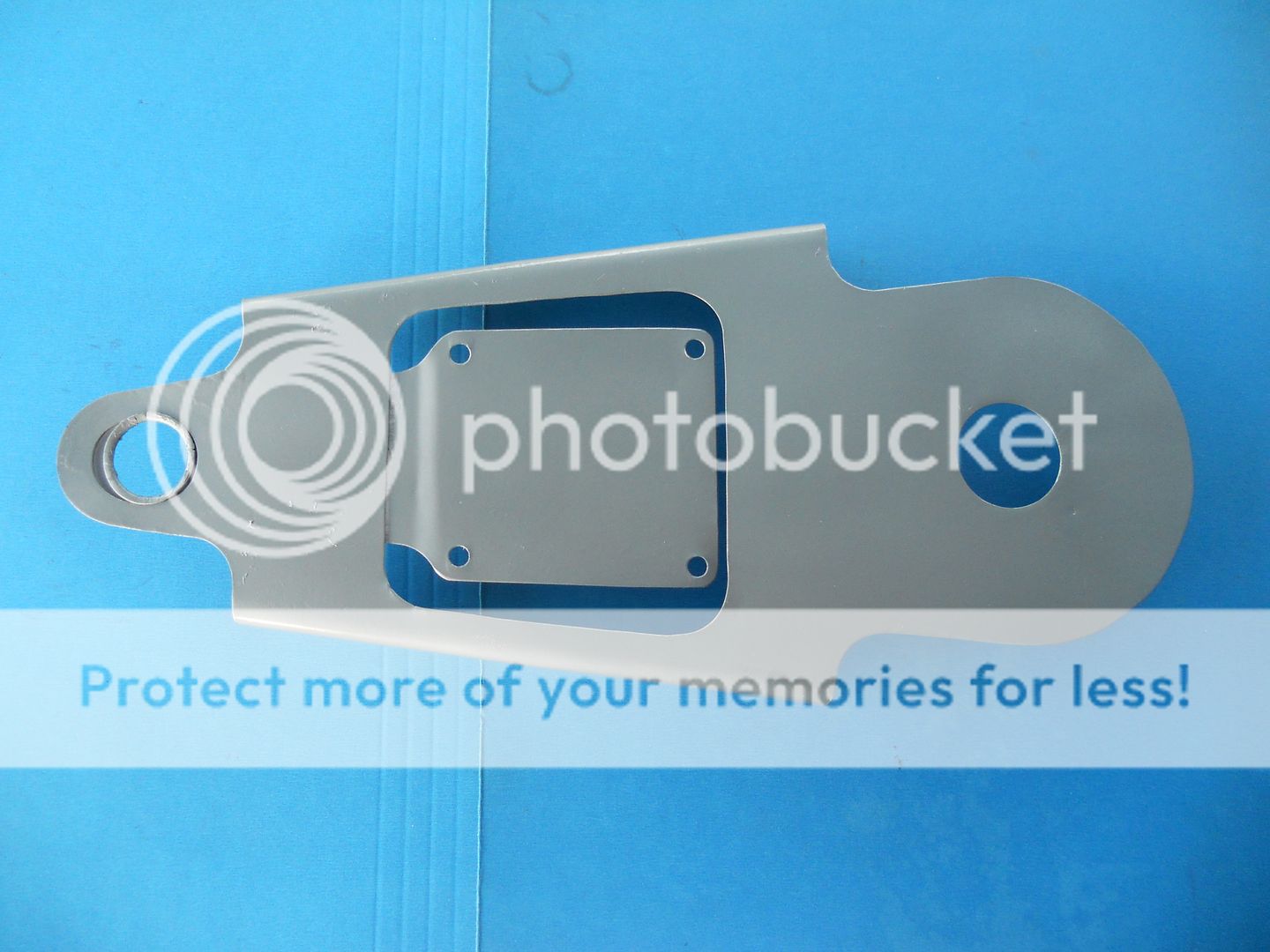

This made me understand the guides have to move with the rear pulley. If I attach the rear of the guide to the bolt head retaining the double pulley, I still need a place to support the front. That's when I made another piece that bolts as the original guard and continues forward. I can make another pivot to hold the front of the guide. The front will need an elongated hole so the guide slides in it because when engaging the clutch, it moves forward slightly.
That meant I had to cut a hole in the center of the guide to accommodate the mounting and movement.

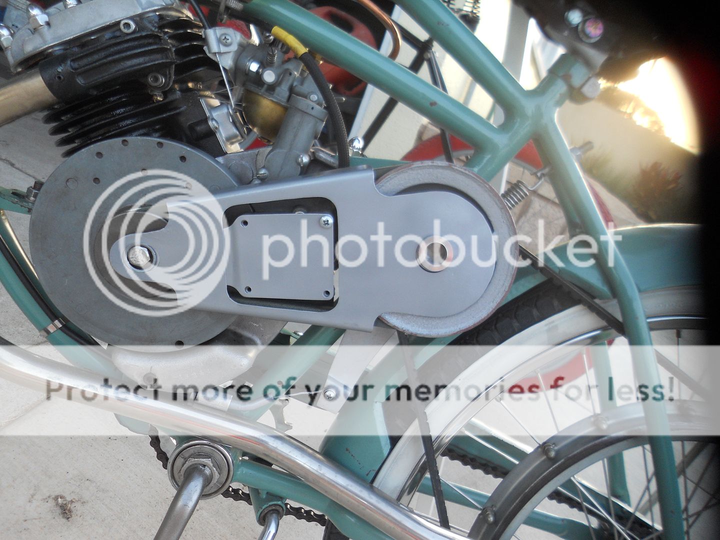

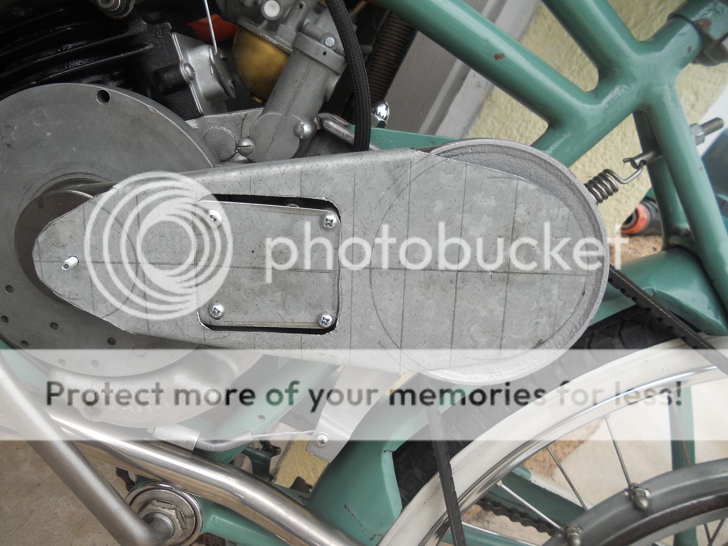

installed it onto the bike and was fairly happy with how it fit.

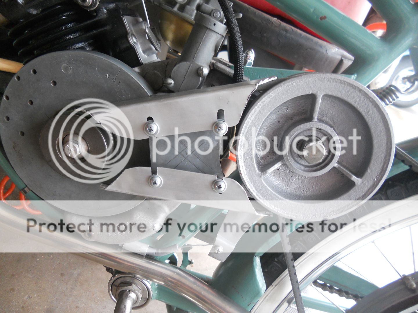

Finalized the shape and put a little joggle in the mounting piece to line up with the guide and made a stepped rivet to hold the two pieces together letting it slide forward and back.

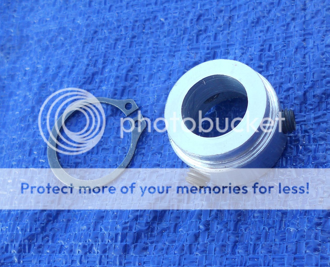

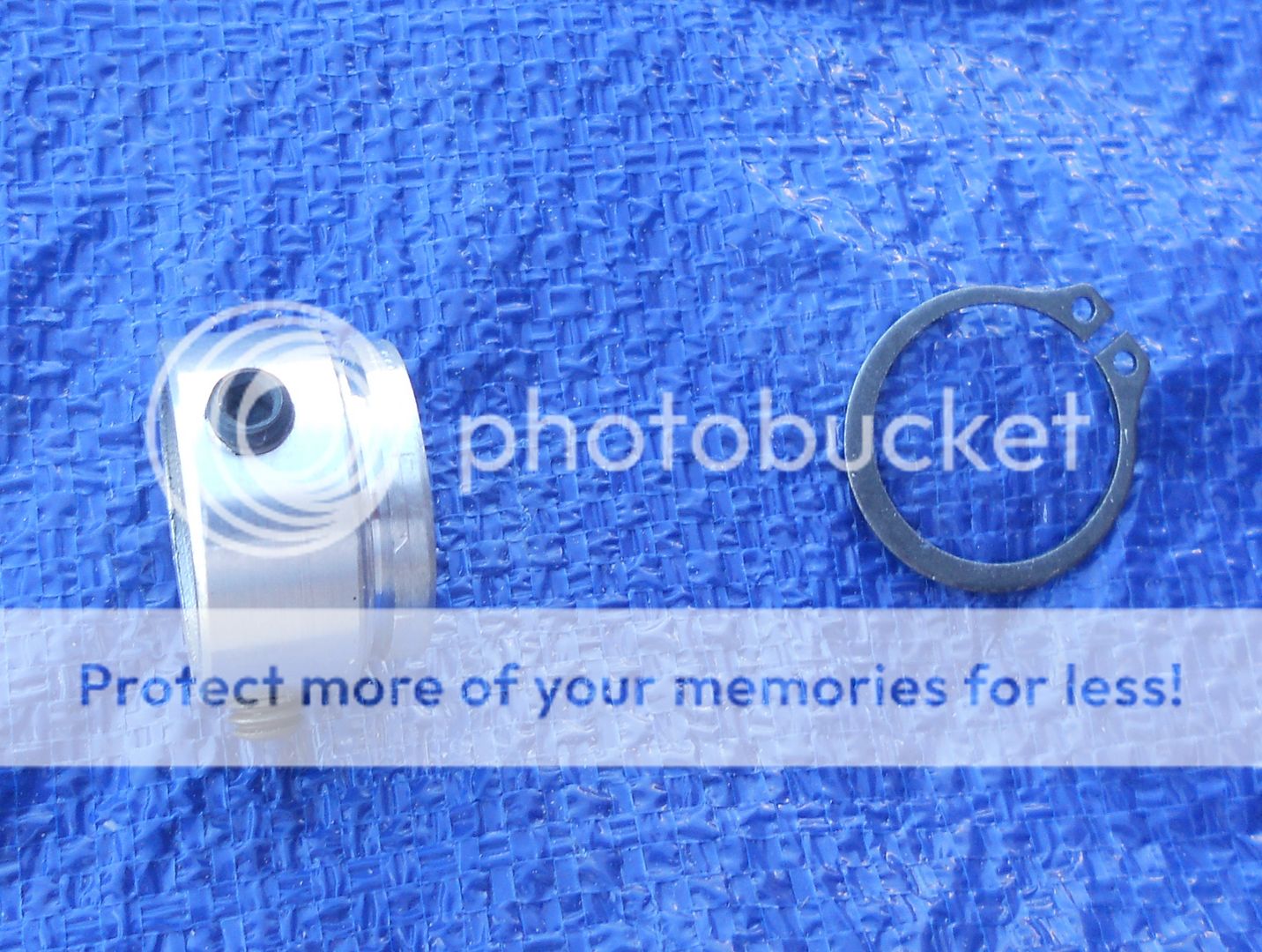

Next I made a pivot that is held onto the head of the pulley bolt with 3 set screws and holds the rear of the guide retained with a snap ring.

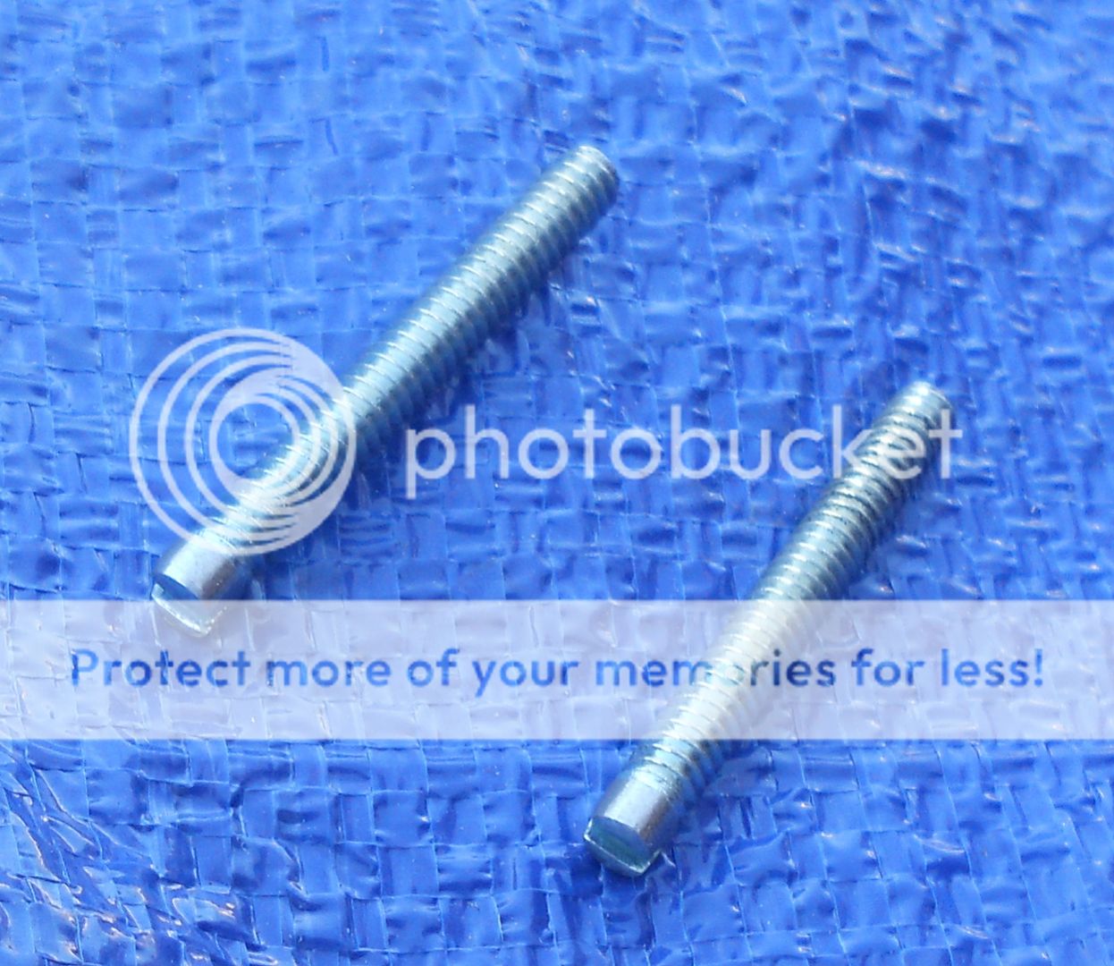

I also made two aligning pins to screw into the guard mounting holes. My guide will slip over the pins with the guard on top and the other 2 screws will hold it all. The pins come out and the 2 remaining screws go in.

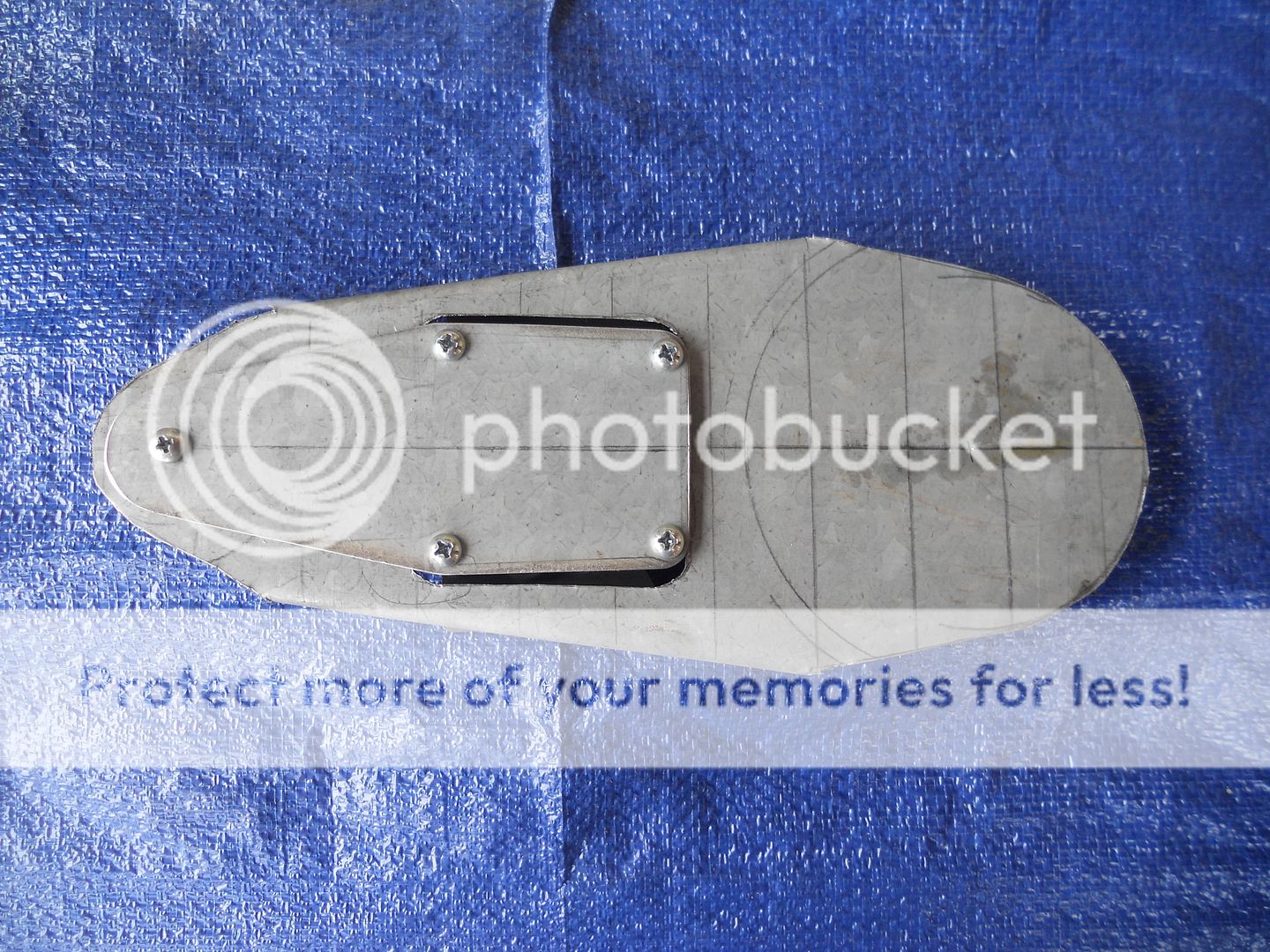

I figured a way to keep the front pivot from rubbing on the flywheel bolt. I opened up the hole and wrapped it into the other piece like a grommet, still having the proper movement.
It fits pretty well and I can now stop whenever I want without killing the motor. Some more testing this weekend, but I'm calling it a success for now.
So the front hole doesn't touch the flywheel bolt at all? Looks good neet and simple.

Clearance is good on the bolt. It may not be necessary with a home made clutch, but would probably help it to release completely.
