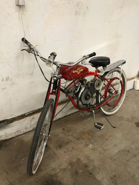

Not sure what year ect.. seller says 1948.Thanks for all help in advance.
Hey! No that bike is not from 1948. That bike frame is from 1972 to 1983. The frame is a huffy Good vibrations steel frame. Handle bars and headset are as well from a huffy Good vibrations bike. The huffy Cranbrook replaced this type of bike in 1985! I actually have a build on this exact frame from 1977 of this bike if your interested! Hope it helps!

It’s definitely a Schwin frame based on the welded on kickstand and the springer fork. Even the spread of the handlebars says 40s 50s. The engine is probably an H series, or possibly a J. Check on the side of crankcase. 48 is probably correct.

lol not a Schwin frame......... lol@ welded on kickstand what you think the one I showed is?, springer fork was same one that came on the huffy good vibrations I have it's sitting in a box cause it was trucked up when I got the old bike. fork on mine is 24 inch since that is what it got converted to for a build. funny enough even has same seat on it still as the guys above! handle bars everything is identical. to what use to be on the bicycle. Look up a huffy good vibrations bicycle. Everything this bicycle has is factory stock that came on one.
