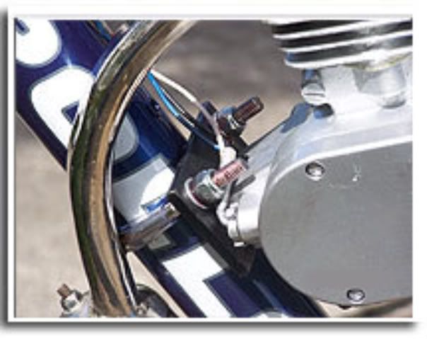

R raneyd Doug in Wyoming May 16, 2008 50 0 0 Aug 7, 2008 #1 Can someone help me with where I can buy a mounting bracket that works with the front engine mount for an oversize frame tube? I thought it would be easy to find but I have not had any luck. Thanks.

jasonh New Member Jun 23, 2008 1,590 0 0 40 Longmont, CO Aug 7, 2008 #2 livefastmotors sells one. You can also make your own out of a piece of aluminum or steel and a muffler clamp. Here's mine, using my 2nd option:

R raneyd Doug in Wyoming May 16, 2008 50 0 0 Aug 7, 2008 #3 Thanks, your help and picture are greatly appreciated. Doug in Wyoming
Dave31 Active Member Mar 1, 2008 11,199 47 38 Aztlán, Arizona Aug 7, 2008 #4 Here is the one from livefast
Bikeguy Joe Godfather of Motorized Bicycles Jan 8, 2008 11,837 252 63 up north now Aug 7, 2008 #5 Nice Homegrown replacement jason! I LIKE it....
