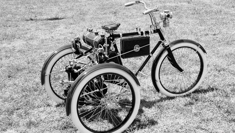

Curt, What are your plans to power your Awesome Worksman trike ? I'm starting work on mine today using my 79 cc harbor freight 4 stroke and the jack shaft I got for the other trike. I never thought I would have a one inch axle to work with and so far I'm seeing a lot of options available !

Not sure, but staton does have a 1" axle differential also. My plans are to build a Orient type trike first,
But if i were to put a motor on the worksman use the existing axle sprocket, jack shaft. and put the motor between the legs up front, ( save the basket ), it has 3/4" bearings already. Other wise i would use a differential ( already have ) and make it wider.......Curt

The Orient looks it's going to be one fun project to capture the look and feel !!! The fuel tank and lighting system are fantastic !!!! I always like the wider stance idea !!
