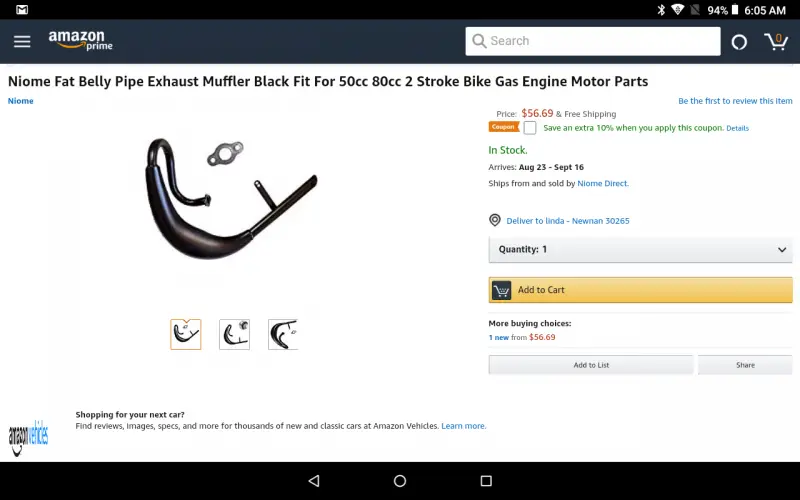

Greg where do you feel the expansion pipe you run "hit" and how wide is the power band? Is there any benefit at the top end or does it actually help at all on the top?
The long straight style I'm using with a kit muffler added to the chopped off stinger; which gives about the same total length as the pipe with just the stinger, benefits mid range to high rpm, comes on at 6,000 and rages on with the reed valve motor, but with the piston port motors it's torquey lower with not much going on by 7,000 rpm. It definitely doesn't run any faster with the piston ports, but more fun getting there.

Rick mid range was the biggest gain, I would say the power band hits at around 4500-5000, I gained about 4mph at the top of the hill on our road which is a steady climb from the driveway for about 800 feet. I’m almost tempted to drop a few teeth on the rear sprocket and gain more on top end. I’ve dealt more with 48cc engines than the 66cc, they perform better at higher rpm, the 24” with a kit 44 tooth will do 33 but is screaming.
Good info Greg the direct add on motorized bike expansion chambers I've tried seemed to mostly center on mid range pipe hits & daily riding consists mostly in that band width. Small motor cycle pipes designed for racing & then modified for motorized bikes give the biggest bump in power, but vary in where on the bandwidth that power id most noticeable...still science mixed with Voodoo & luck!
