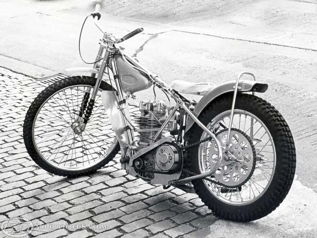

OK Venice. We want to see you ride a bicycle with a 500cc Jawa and live to post a vid youtube. You would need to use brakes from a Hayabusa.

The Jawa motor would actually work well. Just run a smaller carburator to keep the speed down.
