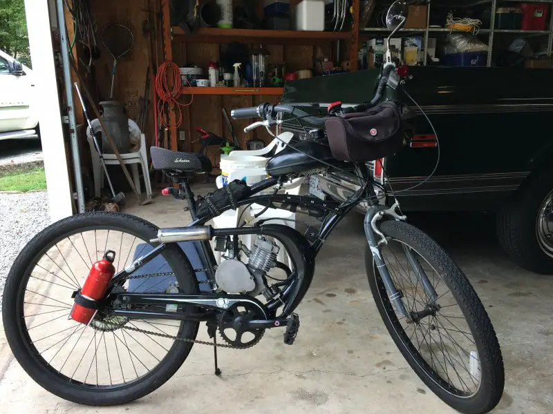

You don’t say what size wheels you have but a 32 tooth sprocket may not be letting your engine get into its power band. My stock China girl on a 700c makes over 30 with a 44 tooth sprocket. In your case a larger rear sprocket may get you more speed especially with an expansion chamber exhaust.

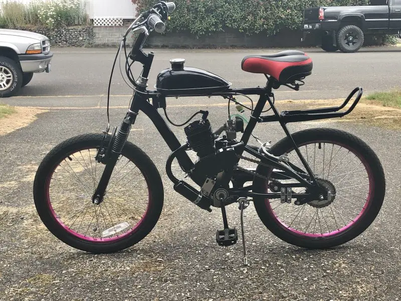

I also have a 20 inch that makes 30 using a 32 tooth rear.

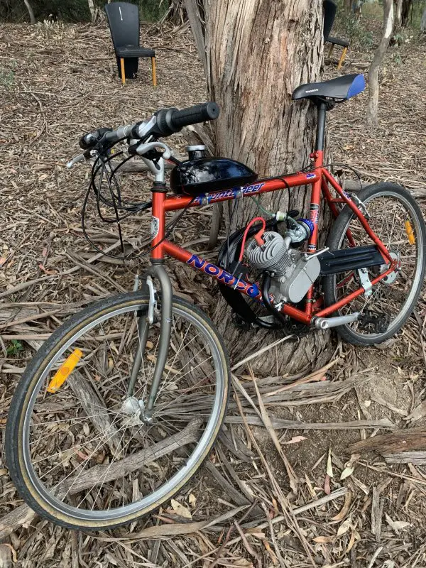

This is the motorised bike i forgot to specify that the pipe is an ebay mz65 clone. i tryed running the 36tooth and got less speed but more tourque. i fixed the terrible 4 stroking because someone decided a #75 Jett would be a safe size for a motorised bike carb by putting a 65jett in, it bogs a little bit at WOT on flat but it runs way better. I got a dremel for birthday and am in the process of fixing the crusty casting in the cylinder on the intake and exhaust ports, i also want to have a go at cleaning up the transfer ports but i dont know if im confident enough in my dremel skills to not scuff the bore of the jug. At TDC there is around 0.8cm of piston showing on the intake side, i have heard talk of skirting the piston so there is full open flow but idk if that would unbalance the piston, keen to see if the porting will make a difference and i have swapped the 32tooth back.

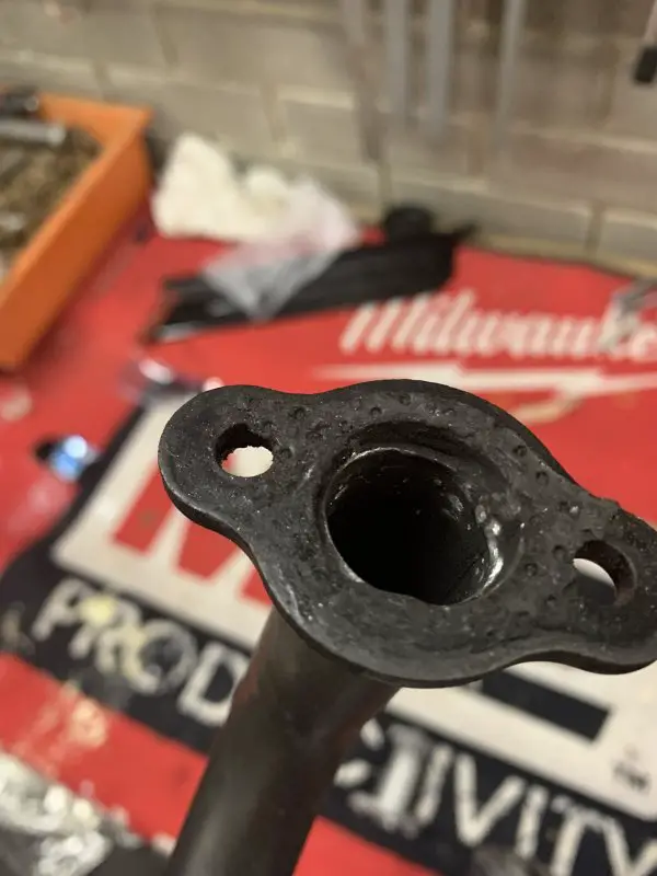

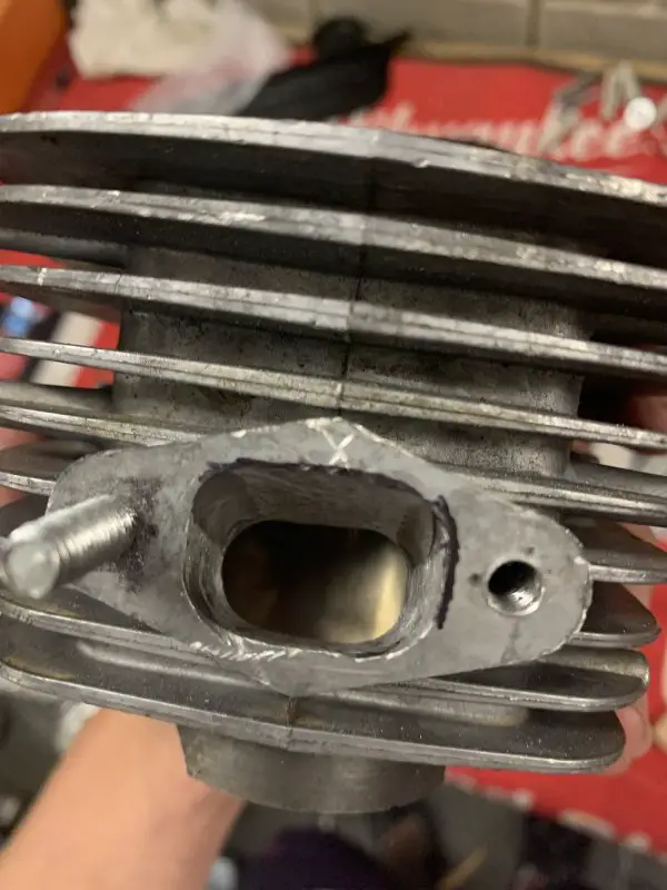

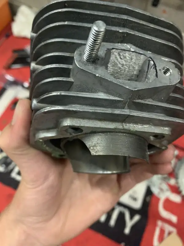

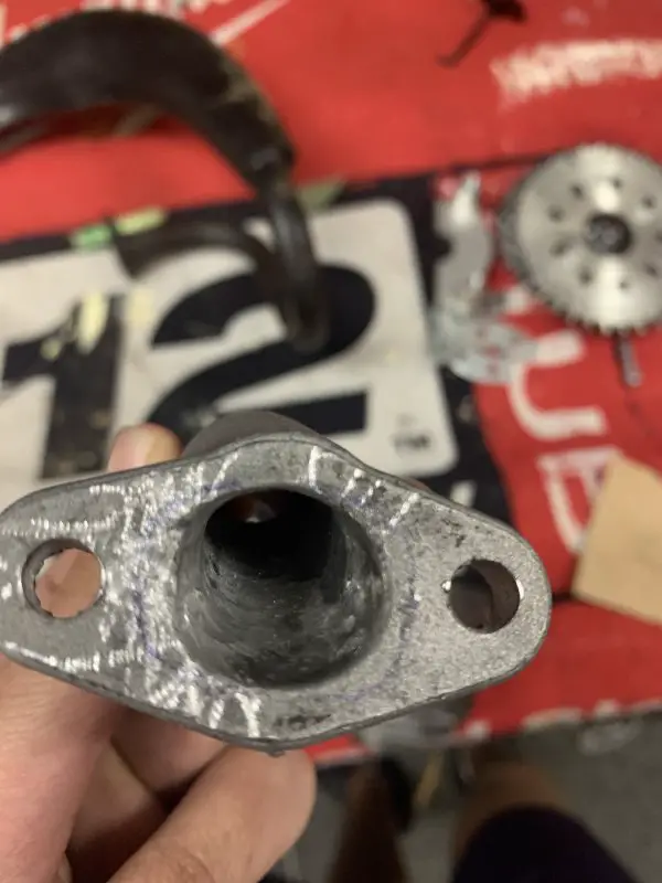

Here are some of the pics of my light porting. something i also forgot to mention was on the block you can see how part of metal has been broken, i dont know if this will reduce performance but i assume it would. i am trying to port match my intake flange atm but i dont know how i would port match the exhaust when u can see the metal is thin and cannot be opened much

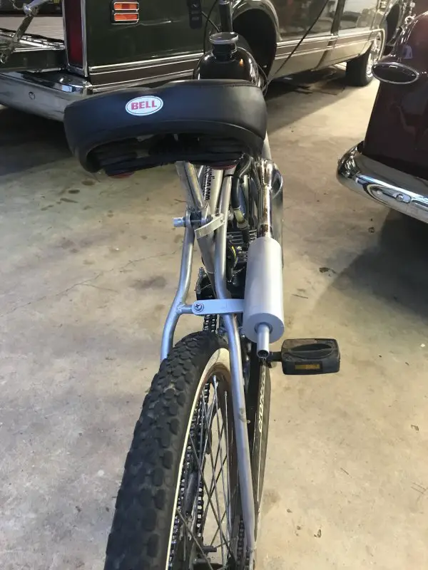

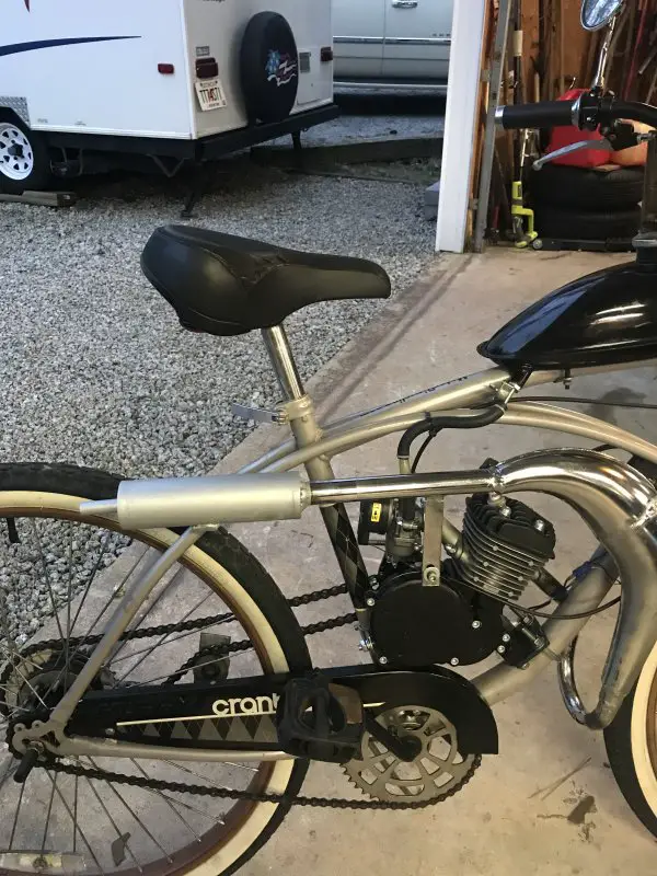

The small amount of piston showing on the intake side should not hurt power, when porting intake and exhaust you can widen them without changing port timing. And for cleaning up the transfers I use a very small rotary tool from harbor freight, it's easier to use and lacks the torque to jump around and damage things. I've got two of those pipes and both were too loud and lacked back pressure for low end, I made silencers for each and that helped bottom end without hurting top end.
When porting you want to go slow and take it easy, if I try to get in a hurry I tend to make mistakes.
Here’s the pipe and silencer on my cranbrook.
