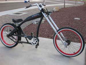

I just found this Felt Bandit used for sale for $250+shipping and had to add it to the list. This one is aluminum like the 1903 and I really like the styling, and the fact that I can't find one build using it. I think this is my new #1. What do you guys think?

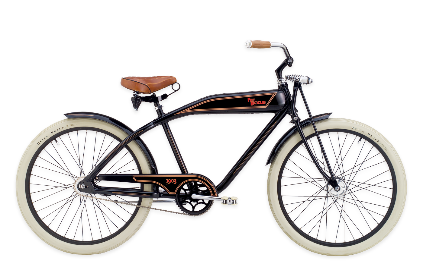

I can get this Felt 1903 used for around $250 (retails for $550). Another ideal candidate for an in-frame tank, and I love the Felt cruiser frame. This frame is made of aluminum! But does that make it harder to achieve an in-frame tank?
Actual pic of the 1903 for sale.

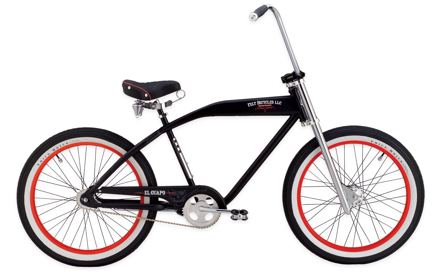

I can get this Felt El Guapo for $350 used (retails for $500). Again, I love the Felt frame and the possibility of an in-frame gas tank.

I pick the Felt 1903. Second place is Felt El Guapo.

Just remember with a Felt you'll need special mounts that run about $130 and if you go with a Felt with a 3" tire you'll need the offset mounts.
Definitely the Felt..Its gonna cost a bit for the mounts and such, but.. It definitely will be worth it.

Motor mounts and extra costs here and there don't scare me. I want a real looker! By the way, here is a pic of the actual 1903 for sale. I don't like the non-stock tires and seat.

Ok, the list you have I agree with. That Bandit would be awesome!

Of all my builds(7) the "1903" w/ inframe 4-stroke gets the most attention. For that price, it's a steal. Terry Blow has a video series on converting the top tank to fuel tank here on this Forum or www.blowbyu.ca. I made a tank mount from hardwood that clamps to the seat post and a quart size lawnmower tank. The bike is well made, the hydroformed aluminum frame is thick gauge.
