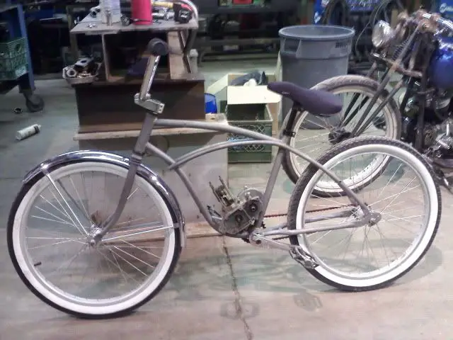

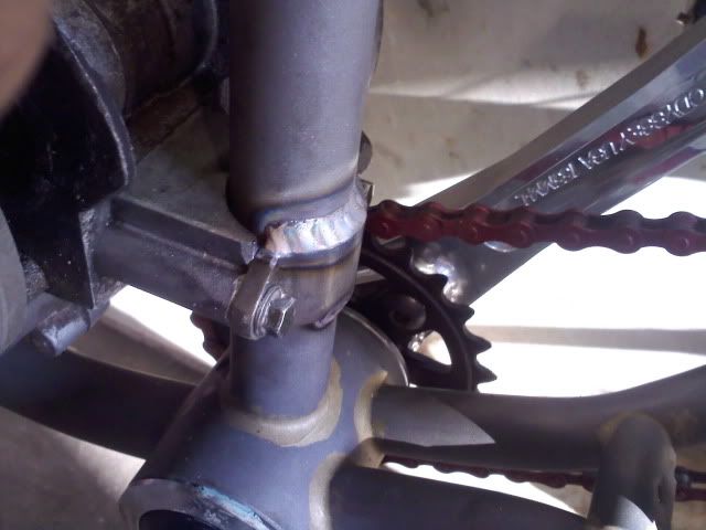

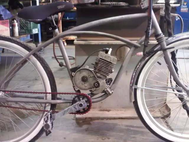

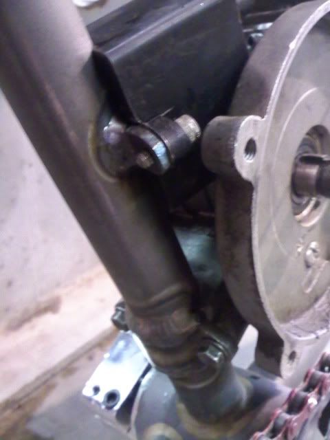

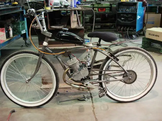

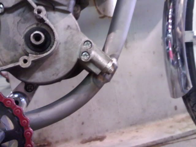

picked up a 60's western flyer today and started building some motor mounts. used the tig and silver solder to put everything on because i didn't want to put too much heat in the frame with a torch. didn't want to use steel filler because it doesn't really go with the bike. i can't get enough of the bmx parts on this bike, i know it will be a love it or hate it thing for you guys. the motor will be getting my race port, pipe, and carb package. this thing is so light, it's gonna fly.

I love the welded mounts!!! The more solid it is the quicker and responsive. BMX style all the way ya got it!

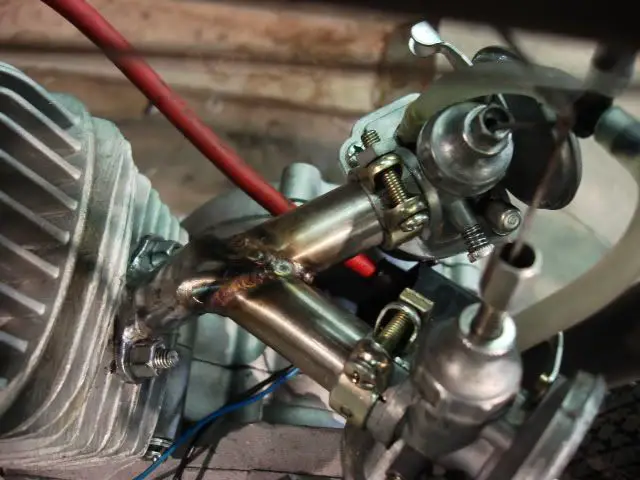

built most of a stainless expansion chamber this evening. i'm happy with the way it looks, but i think i'll put a little stinger on the end to give it that ting

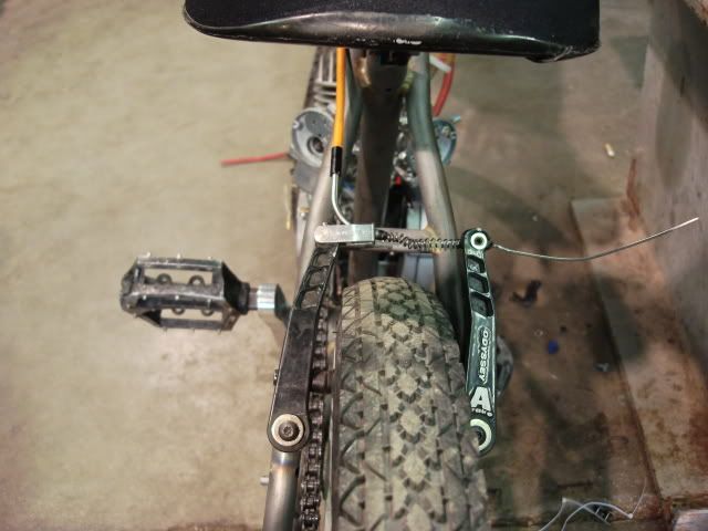

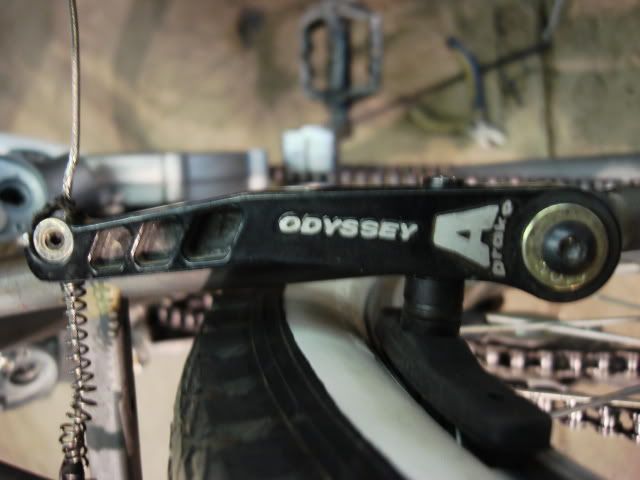

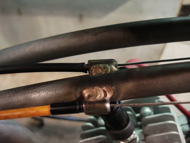

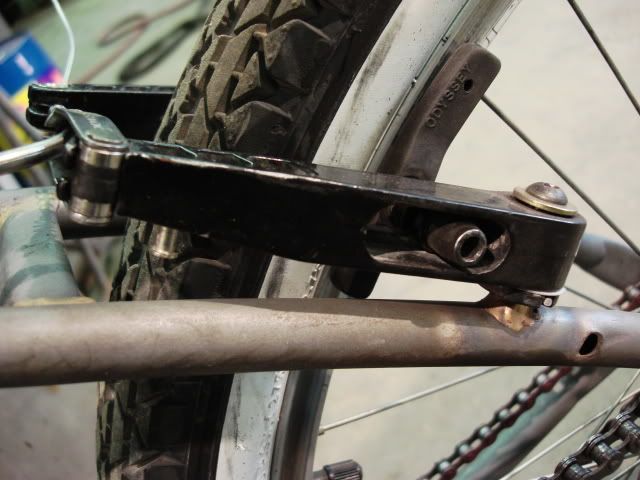

i got some brakes now, had to put some tabs on the frame to hold the housing but let the cable pass. also a couple pivots on the top rear legs. the brakes work awesome, and don't look too bad either.

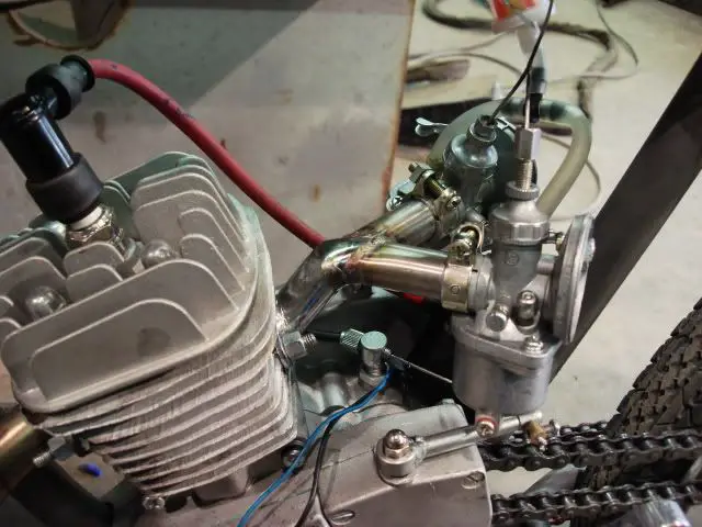

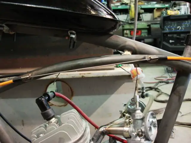

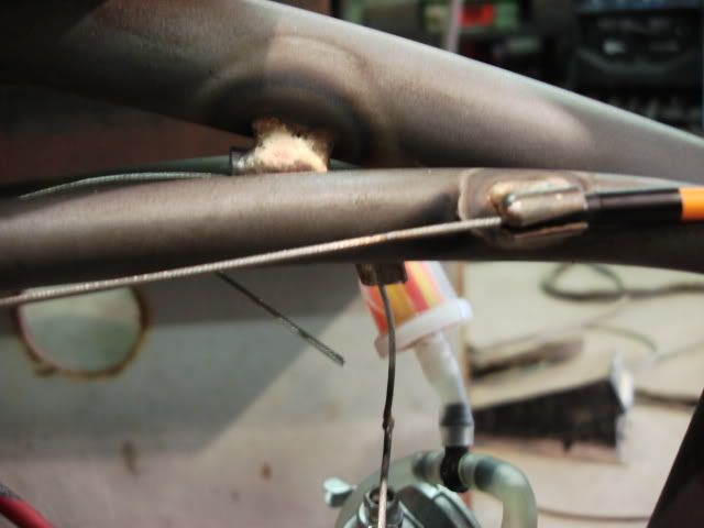

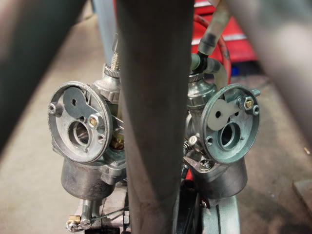

i had to give my buddy his dellorto 16/16 sha back and needed some pretty heavy carburetion to keep up with the airflow requirements of this fire breathing beastie, so i figured that 2 must be better than 1. i will be building another intake for the duals soon and the carbs need a little finesse but they work about 90% as good as the dellorto. i should be able to get the final tune done tomorrow. you would not believe how nice the throttle pull is with that little 90deg cable router.

foureasy, I`M SPEACHLESS!! THANKS FOR SHARING AND THE GREAT PICS. DON`T LET D. FAIR DRIVE IT!! HE MAY LEAVE THE STATE!! LOL ARE DUAL CARBS LEGAL?? LOL. RON .cvlt1
