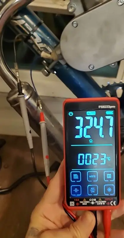

OK I'm not exactly a master at these two stroke bicycle engines but I do know the basics. My engine died and after narrowing it down to being an electrical problem, I youtubed how to test the magneto and CDI first here.
magneto.jpgThe magneto

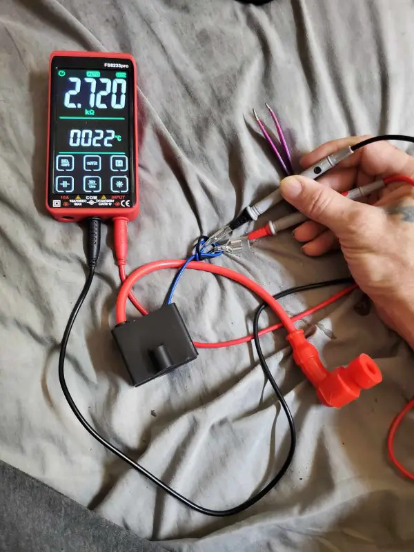

The magneto tested good but according to the youtuber the CDI should test around 6-8 Ohms. Well mine tested at 2.7k ohms.
old coil.jpgThe old coil

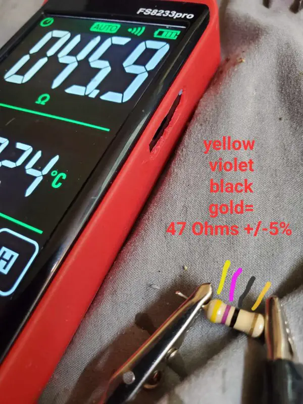

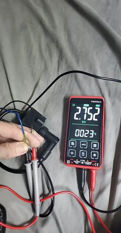

So I figured the CDI was bad and I ordered a new one. New one arrived and assuming it would be good, cuz it's new and all. I put it on the bike but it was a no go. So I take it off and test it with the meter and I get a straight open. It wasn't till I received the replacement that I realized for some reason polarity matters when testing the resistance on a CDI coil. That was a new one on me. As far as I've always knew, polarity doesn't matter when testing resistance. I discovered this by carefully rewatching the video above and noticing he states which lead goes where. Ok so be it then, I said. So I retested the replacement one and lo and behold I got a reading. But wait, it was the same reading as the old one?:confused:

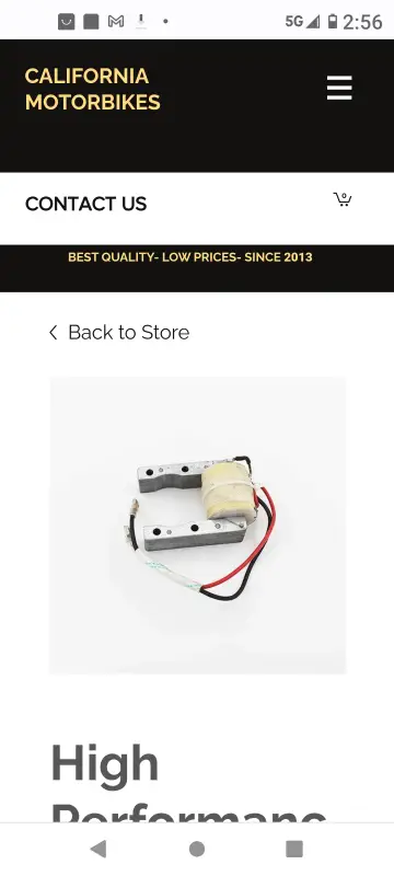

344312559_212921984841756_8693857560929592111_n.jpgThe new coil. 2nd new one because I most likely tested the first new one wrong.

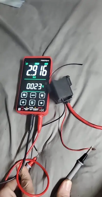

So I started to 2nd guessing myself. What are the chances...? But I couldn't find any mistakes in my testing nor my reasoning, so I figured I give it another go and ordered another new one. This time from a different seller. But when I tested it. I was then thoroughly confused. It too tested the same as the others.:mad::confused:
2nd new coil.jpg2nd new coil or 3rd however you look at it.
By this time I've watch 4-5 other videos to verify the first ones statement of what the correct ohms the CDI should be at. All stating the exact same thing. It should be between 6-8 ohms. Two I can be live but three all having the same wrong reading as a bit too much of a coincidence. I must be doing something wrong. But what I can not fathom. I'm pretty much self taught on every thing I do know about these engines. I don't know anyone ho I can ask personally. And this is the first time google has failed me. So for the first time in over a decade I have to reach out onto a forum .Please someone what is going on. Am I l losing it or is there some bit of knowledge I am lacking for me to get the full picture. I am competely lost and have no idea what I'm doing wrong. But I have to be doing something wrong. The chances of me receiving three bad CDI's in a row is crazy, right?

There are a lot of differences in production from one makes to another, a lot of the parts are made in small shops without quality control. I have found several different coil types with different resistance, what matters is if it fires the plug and the engine runs, if so I’m happy.
