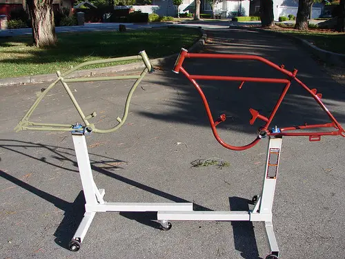

Like I never head that one before! I will be working on both of them all weekend and will try to post some more pictures. Whitey, these are both powder coated. My powder coat shop does a great job. Dropped them off Monday afternoon and they called me on Wednesday saying they were done! Two different custom colors in two days time. That's service.

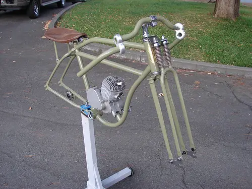

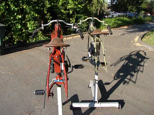

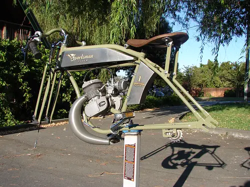

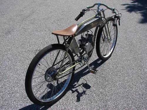

Here's some more green, and just a little red. Now where did I put those wheels? I know their around here somewhere............
Vintage Colors by Sportsman Flyer, on Flickr
This picture clearly shows the 135mm rear frame spacing on the red Racer model verses the standard 110mm spacing on the green Flyer model.

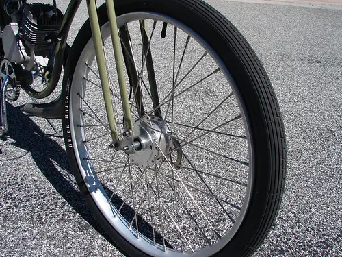

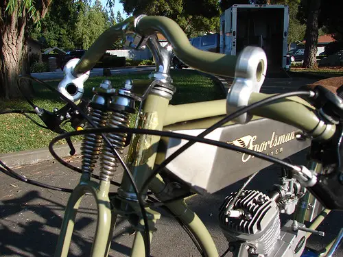

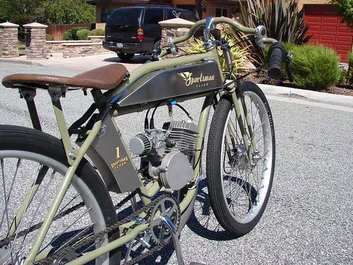

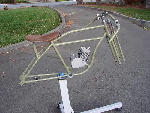

Finished up the green bike today but didn't ride it yet. Maybe tomorrow.
Sportsman Flyer by Sportsman Flyer, on Flickr
Front wheel detail shot. This is a stock Worksman aluminum wheel with satin silver annodize finish, stainless spokes, and drum brake. Monark fork is completely reworked and has my latest 12 gauge stainless dropouts.

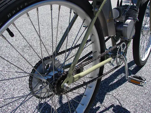

Rear wheel detail shot. Again, a worksman wheel, Shimano 110 coaster brake and Sportsman HD sprocket adapter. I'm running Diamond #41 chain on both sides.
